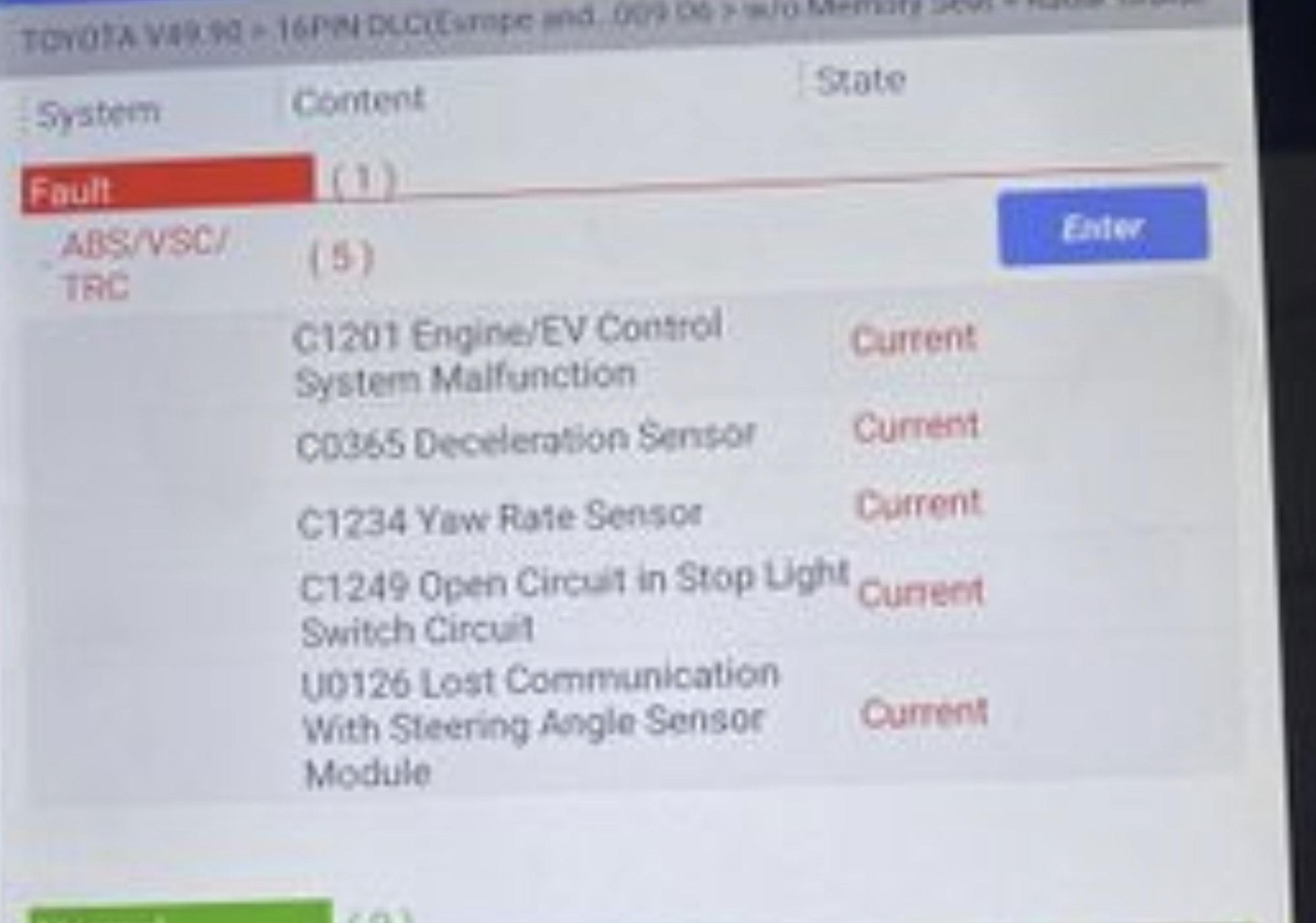

Recently bought a 2008 Aurion Sportivo. Ran it with an obd2 sensor and found a couple error codes (shown in image below). The check engine light was not on. The car is also consuming a fair whack of fuel, 14L/100km with regular driving. Has anyone else ran into these engine codes, if so what is the severity and how much would it roughly cost to fix them? I did a google search but I'm a bit unsure as this is my first car.
