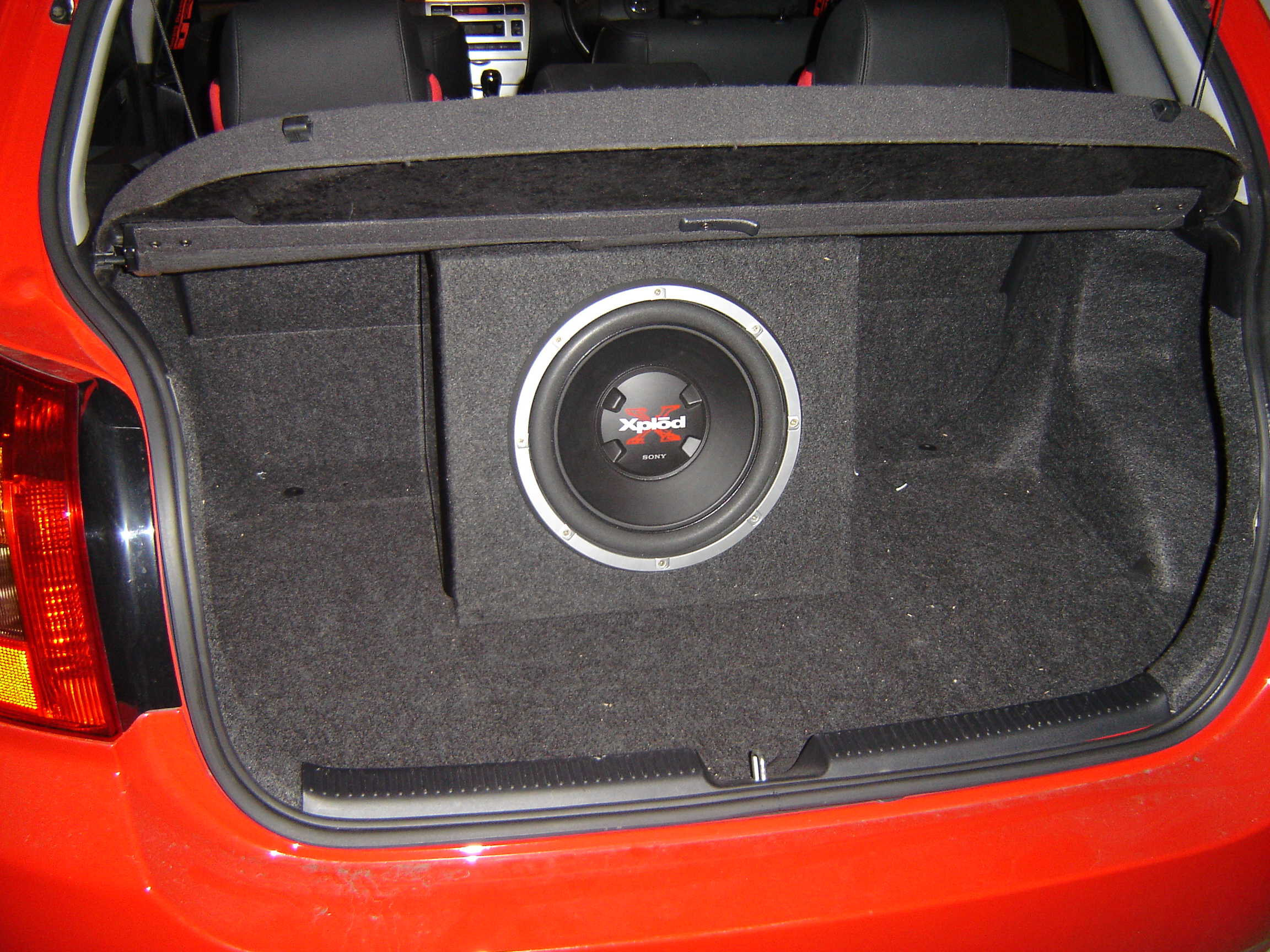

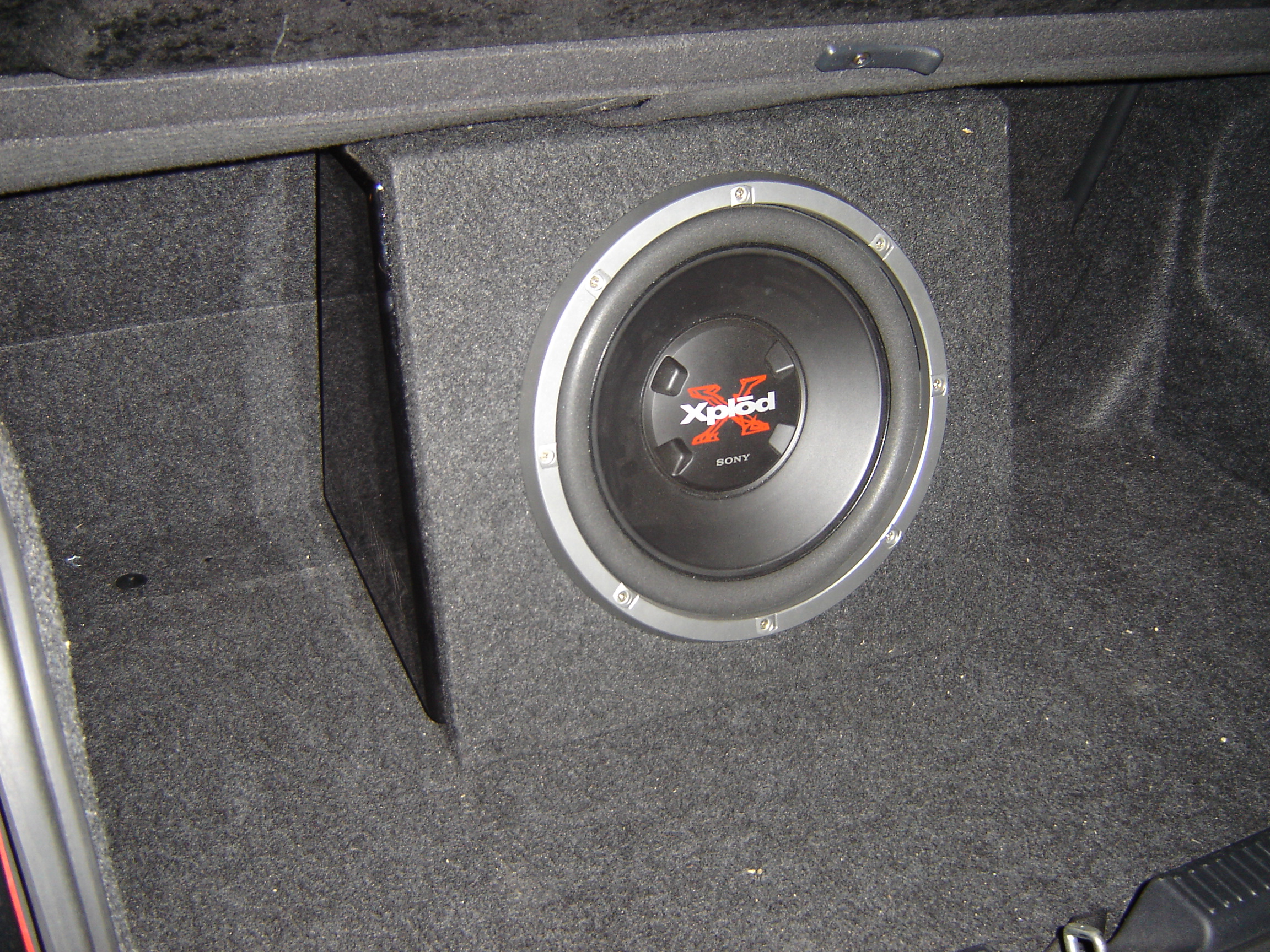

I have attached 2 images of my sub box for you. Its nothing flash, but it looks neat and tidy and together, there is only $140 odd bux worth in the boot...
As to any problems slightly warping the size to accomodate the recline, I couldnt see any....as long as you do the maths correctly....
