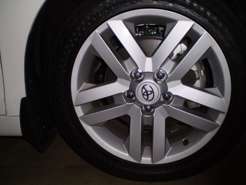

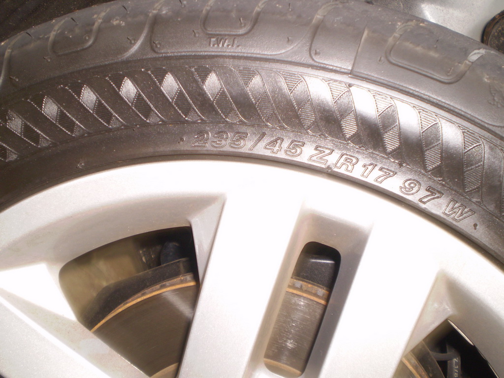

I have attached 2 images:
The entire wheel:
The rubber on the wheel:
I decided to check if there are any labeling on the rim itself, so I took the wheel wench to pop the cap off. Yet the rim did not show any thing at all. So I decided to check the spare tyre while I return the wench to the boot, the spec on the spare is a Dunlop 300E 215/60 R16 95V. Now... if I ever need to replace my tyre with a spare, will it fit?
Have a feeling that my dealer need to explain a few things to me.

yes the wheel will still fit and your car will still drive, but youll get a few shakes and vibrations until you return the original wheel of the same size to the same axle.
the 215/60R16 tyre on the spare is the stock one from the factory. on 17" rims you should have something like 225/50R17 or 215/55R17 tyres, as the tyres you have at the moment have a greater difference in rolling diameter (affects your speedo)
i'd be returning to your dealer and questioning the tyre choice.

Don't think the dealer would like to spend much more time with me, being under 2 weeks old, I already had 2 wheel alignment and its still going left.
What questions should I ask my dealer as I have lack of knowledge in cars? Otherwise I'll just wear down these 4 tyres and get proper ones.
According to the photos, do I have 16" or 17" alloy wheels? Never thought upgrading the standard to alloy wheels have such troublesome impact.
Jools.
drifting left is a known problem with the aurion that can't be fixed through any number of wheel alignments. there's a kit you can get for it, some of the other aurion owners can help you with that.
the tyres you have are fine, there isn't that much difference between the current tyres and the original tyres, so dont be overly concerned about it. you can argue for the same tyre size as that on the sportivo 17" rims (because obviously it works well), but the tyres you have are still good so dont worry about it.
your rims are 17". see on the tyre size (second photo) it says 235/45R17. 235 is the width of the tyres, 45 is the profile (size of the side of the tyre) and the R17 is the rim diameter. it's not rocket science.

Is your spare rim must be 16" steel ? Overall outside rolling diameter will be close enough.
Using a tyre calculator - http://www.miata.net/garage/tirecalc.html
- Your speed indicator will show 1.8% faster than with your stock tyre (when your speedo says 100km/h you are actually gouing 98.2km/h)

I have read the Aurion FAQ regarding about installing the offset brush to solve the wheel alignment problem. However, from the thread, most Aurion owners have to pay to get it fixed than get it done under warranty.
I understand the rims on the 235/45R17 is 17", and my spare wheel in my boot is 215/60R16 and the first photo is a genuine Toyota Raptor 16" alloy wheel. Kinda confused with the 17" rubber on the 16" alloy wheel. Unless the the higher the rim on the tyre means I have lower profile.
Jools.
