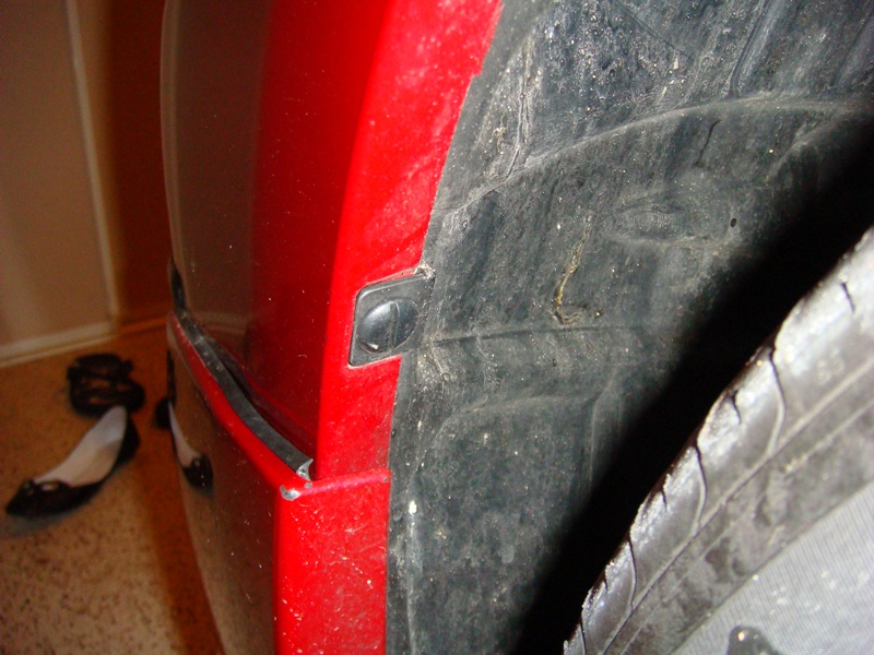

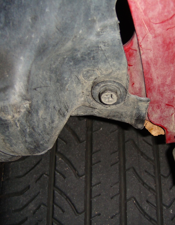

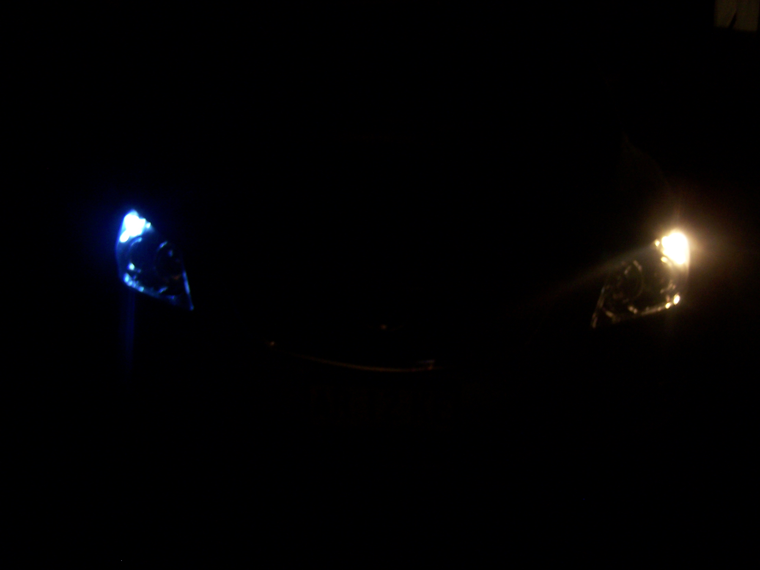

I've managed to change mine to some white LED's (the photo makes it seem a bit more blue than it is). Since I had to access the wiring for the parkers when I installed my HID's (for the relay circuit), I though I may as well open up the other side and swap the bulb there. Accessing it is kind of annoying, but if you change it to LED, chances are you won't be doing it again. With all the design work behind the scenes at Toyota, I'm surprised that this was their best solution for accessing the parkers.

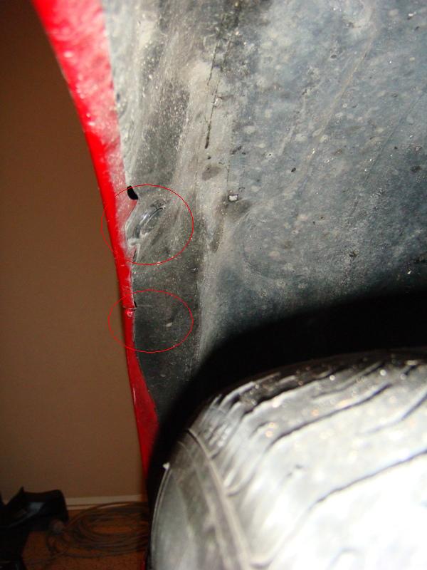

I didn't take any photos during the procedure (sorry), but I went down just then to take some photos as a guide. Mind the dirt; I haven't got around to cleaning the unseen areas yet.
-Firstly, the way I did it was to remove the screw underneath the car that holds the under guard to the wheel arch guard (photo 2 taken facing the rear). When you look at the area, you can easily figure out the screw I'm talking about and how it all goes together.
-Secondly, remove two of the clips holding the arch guard to the wheel arch (photo 3, and the top circle in photo 4). The lower one is a twist and turn, the upper one pops out in the centre followed by the remainder of the clip.
-Thirdly, lift the arch guard up a bit and you will then find a screw holding the bumper in place. You will find it hidden around the location of the second circle in photo 4. Unscrew that and put it aside.
- Then carefully unclip the side of the bumper and with a combination of having the bumper sitting to the side a little (for obvious reasons, don't force it to the point that it looks like it's going to bend) and pushing the wheel arch towards the inner of the car (more forgiving if you push it hard), you can access the parkers; providing your hands and wrists aren't too large. Having a torch is quite helpful at this point in time so you can figure out where you are going to have to send your hand to.

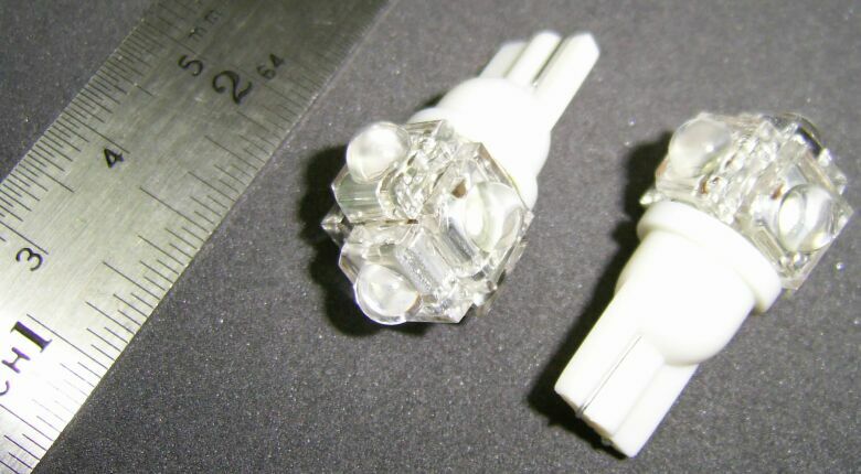

The original bulb is the standard T10 5W type. Ideally, I would have used the 1W Luxeon type T10 LED replacements (photo 1) as I have used them before and they are really bright. However I have had several of these type burn out due to heat, so I don't really trust them anymore. They come with a larger heatsink now, but even still, I don't trust them yet. Because I was going to swap nearly all my bulbs in the Aurion for LED, I had a few different types at home already which let me find out what could and couldn't be used.
For the parkers, you can't use an LED replacement that is too large. The type shown in the second photo (eBay Link) was way too wide to fit into the housing, so I couldn't use that there.
I did however have a 5 LED surface mount version as well (eBay link), shown in the third photo, and that managed to fit fine. So if you are in search for an LED replacement, try not to get one which that is wider than 12-13mm. Most T10 LED's out there have the same style base, as you will see in all those attached pictures. As a general guide, I'd try not to pick one that has LED's that stick out wider than the top of that base.
Also, don't get those T10 repacements that have just one large LED; the ones that Repco and the like sell. They are fairly dim, and will not be satisfying. As for the colour, I'd suggest sticking with white. In my photo, mine look rather blue. In person though, it's actually a pretty clear white. It also appears as bright as the original bulb when looking at it. Due to the characteristics of LED's however, it doesn't project as far, but the visual intensity is there. Just be aware that if you use an LED that looks more blue than anything else, the police might not approve of that as it says on the Queensland Transport website that blue lights are only allowable on emergency vehicles.

Okay, I've updated the links in my post so you can see exactly what I was referring to. I just purchased off eBay since that's how I've done it in the past. As for the heat issue, With the Aurion because of the location of the parkers, standard LED's and SMD LED's will be more than okay. The level of heat they will receive from the headlights are not that much. My sister had the SMD variety (which are smaller and you would think would be more sensitive) on her old Excel, and those were located just next to the actual headlight bulb itself. She even eventually changed her headlights to HID's and the LED's showed no signs of giving up.

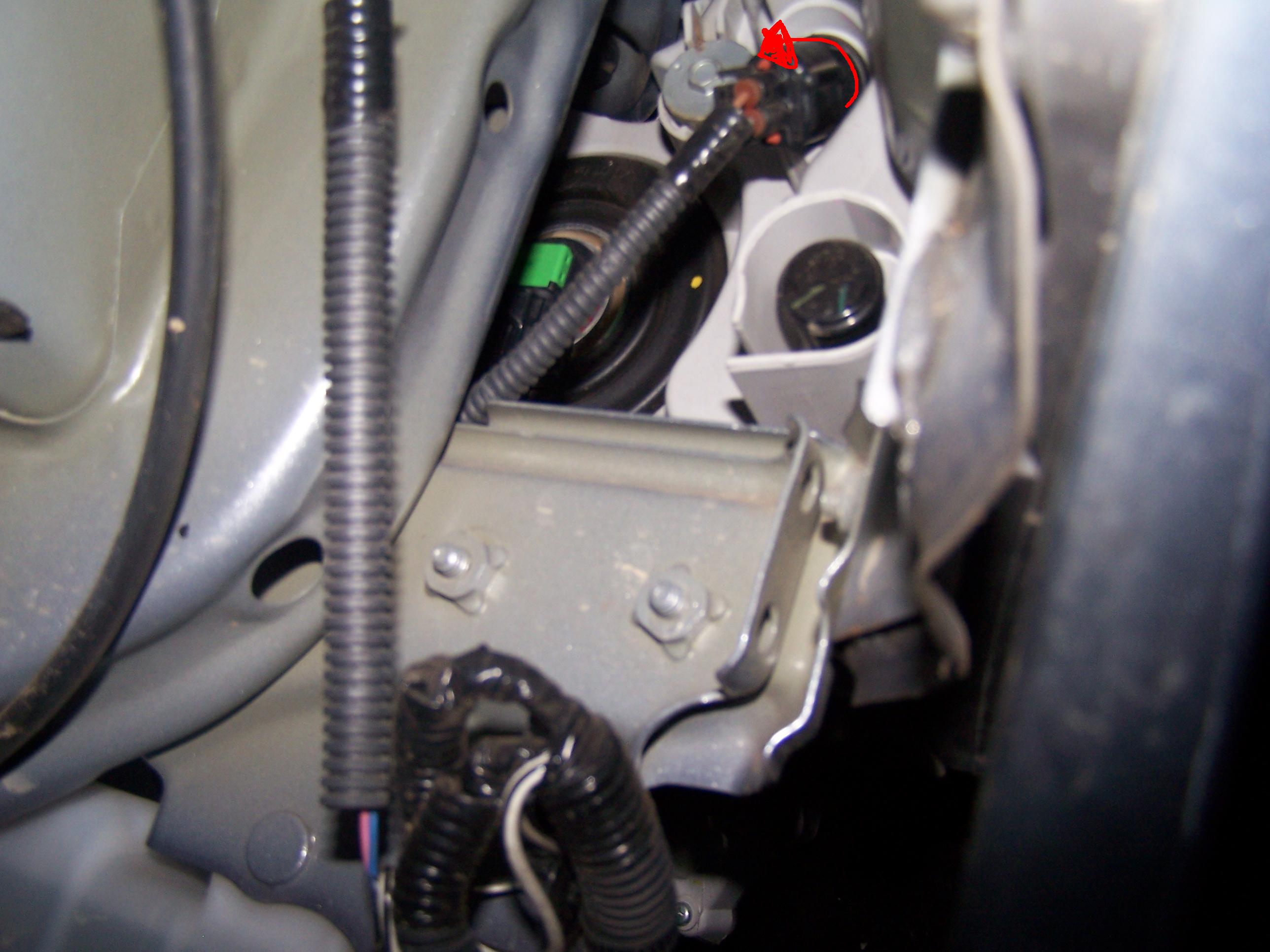

I finnaly did my parkers and the rear license plate. I have to say that I really enjoy the difference!!!
FYI the get to the parkers you need to turn them (see first attached pic). This is an easy mod.
See 2nd pic to see the difference. The photo makes them look blue but they are white.
