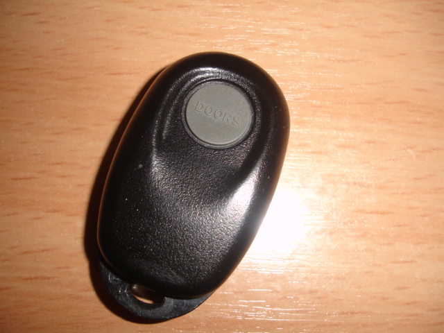

2000 Avalon keyless remote programming
fsjk85
Hey guys, first time posting here. :)
Long story short, i need to reprogram the door remotes for my Avalon. Does anyone have a diy guide?
thanks

How do you open the remote (pictured in OP) to replace the battery?
lol this is a easy one, your not supposed too :)They make these ones pretty cheap so that you just replace the whole unit every 4ish years instead of just the battery. The case can be opened up but you'll see the battery is held firmly in place with a solder. :)

There is to remotes around for the avalon and 36 series camry there is the one like what's in that image 89780-YF011 RRP$61.60 and one which also has the boot release in it 89780-YF021 $63.25 RRP
Thanks for that, just purchased one today at Toyota.
FYI: Mister Minit sells them for $79.95.

I was appalled to be quoted $85 each to replace my two remote key "fobs". My solution was to carefully saw the fob open with a junior hacksaw, following the seam where the two halves had been heat-fused. The battery fitted to the unit is soldered in place and is manufactured with two tabs for the +ve and -ve connections. I bought the batteries (code CR2032-1HFE) from Batteries Direct www.batteriesdirect.com.au for $2.78 each. Unsoldering the old batteries and soldering in the new ones was pretty easy. If you attempt this, just make sure that you use a soldering iron meant for electronics work and not repairing plumbing. The halves were re-assembled and bonded with a good quality silicone adhesive. Both work perfectly.
An additional benefit for me was that I replaced the rubber push buttons with silicone buttons from Polmex - www.Polmex.com.au at $15 each. Again, these fitted easily and are working fine.
If you can afford Toyota OEM prices, great. Otherwise if, like me, you refuse to be "fobbed off", maybe give the diy approach a shot.
