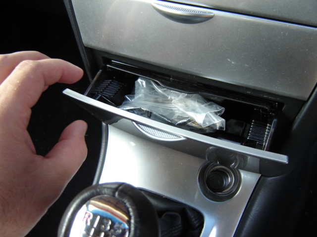

Look At Ashtray
Step 3:
Grasp Ashtray
Step 4:
Remove Ashtray
Step 5:

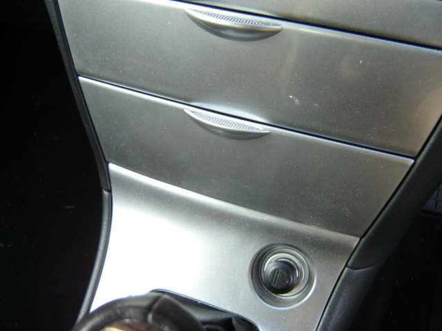

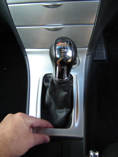

Grap insert around Gear Stick
Step 6:

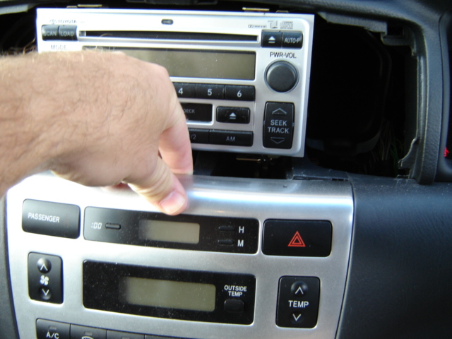

Remove this panel by lifting up the reaer of it (closest to the cupholders) and tilt forward. Then remove the front clip section of this panel.

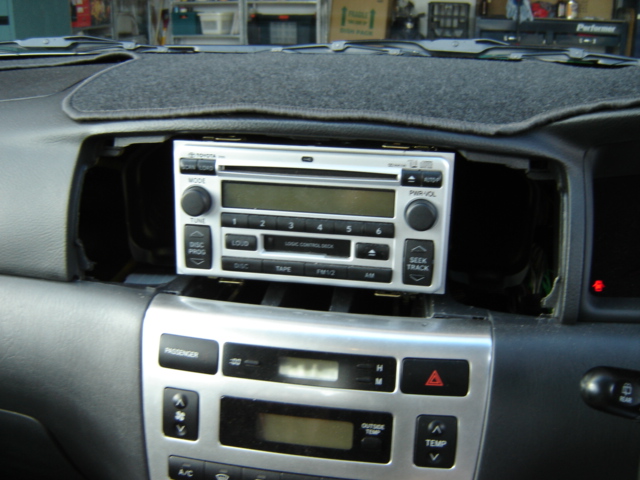

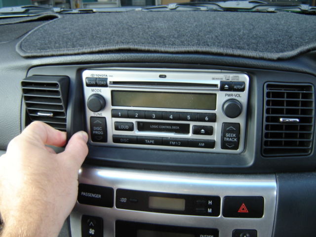

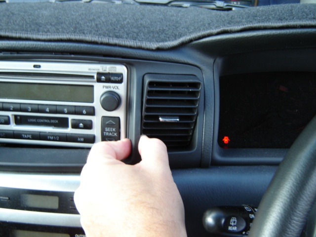

Grasp Air-Con vents on either side of the head unit. Pull the whole surrounding vent out.
NB: The first time you do this, it may be a little tight so be gentle, but use gentle force.

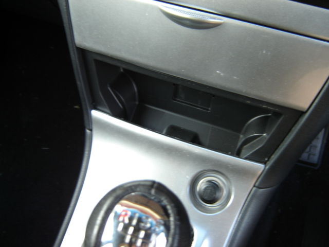

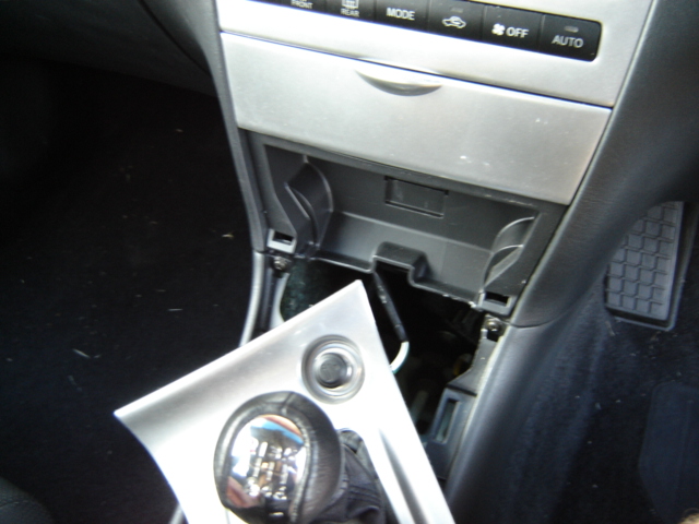

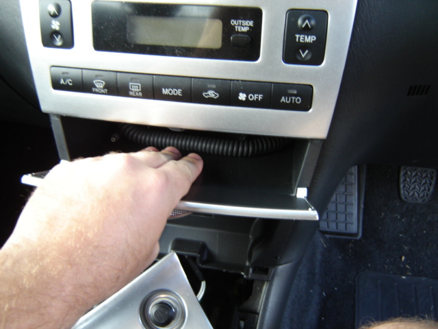

Remove centre console. To do this, iopen the little trap door and hold with one hand, and lever out. Use your other hand to assist with the removal of the top of this console panel.
Step 10:

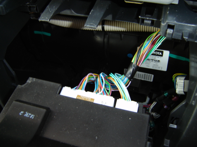

If required, unplug the three plugs from behind this panel. They are 3 separate sized plugs so you can't stuff up the removal and reconnection.
NB: When unplugging these plugs, you will be resetting any clock and Climate Control settings.

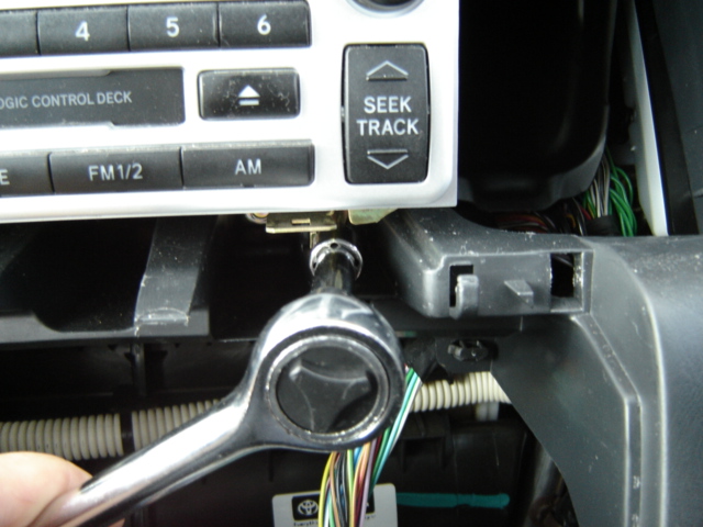

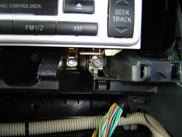

Locate the four screws underneath the Head Unit which hold it in place. There should be 4 holding the bracket in place. Be careful with when removing these screws, cause they can (and will) fall down the cracks into the ether and are a mongrel to find and retrieve.
The Head Unit is actually attached to the bracket and you will need to remove this bracket first.
Step 12:
Using a 10mm socket, remove these four screws. When removed, pull the Head Unit forward.
When the Head Unit is forward, there are three plugs un the rear of it as well as the aerial connection. Remove these plugs and remove the head unit.
NB: Removal of these plugs will reset all radio presets. When you reconnect these plugs, you will hear the CD changer going nuts re-assessing the discs that are loaded in it (if you are re-installing the same Head Unit).

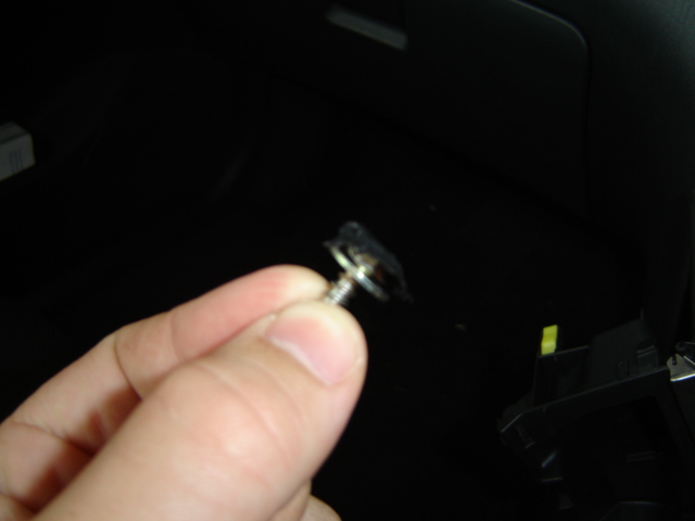

When re-installing this bracket, a trick I use on the socket to keep the screws in place, is to place a small square of electrical tape over the end of the screw.

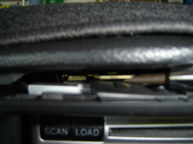

NB: When reinstalling the airvents around the Head Unit, there are a couple of little clips that are on the vent itself as well as the Head Unit Bracket. You'll need to make sure that you install these correctly, otherwise the dash will look like it has been propped up.

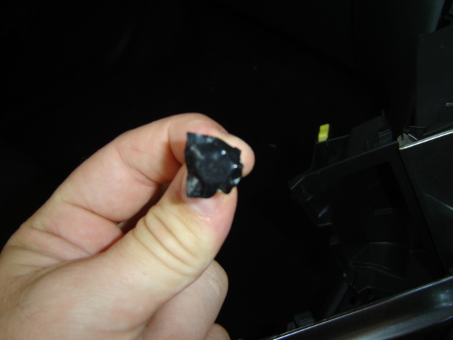

The picture is not too clear, but I have tried to show how to do it. The clip on the vent needs to go UNDER the clip on the bracket.
Step 6:
Step 10:
