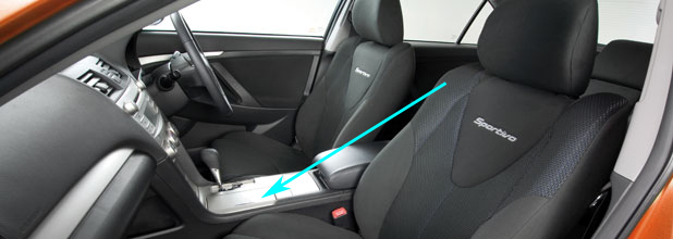

As the photo points to This cover is not opening fully because I think a pen has slipped down under and is blocking the path the cover opens into.
I have had a look with a torch but I can't see the obstruction though when it hits on the cover opening it sounds like a pen.
Anyone got directions on how I get the console itself open or off to access this area so I can clear the pen?

Haha glad your enjoying my pain mate! I already have done a 1000 &*^^*%^$ and *(^T*^%$% not to mention &%^$*%*#!!!
I can't even see the bloody thing or reach it with tweezers.
Unless someone has a quick easy method of removing the whole console it will be off to Toyota Dealer on Monday who I suspect will sting me big time and actually get the last laugh - grrrr!

Best thing is to take console out & fix it that way - you'll get no where trying from the top.

I dropped into my Toyota branch today and they immediately took the car "around the back" and removed the console and offending blockage which was, not one, not two but three pens!
They also replaced a broken front drivers floor mat hold down - all done for FREE! Good on ya Toyota :-)
I have no idea how the pens got there, oh they are mine, other than from the back pocket where the 12v auxiliary is as I do keep pens there from time to time when I am busy answering the phone etc..
Anyway for future reference 2 pens doesn't block the cover but three does hahaha
