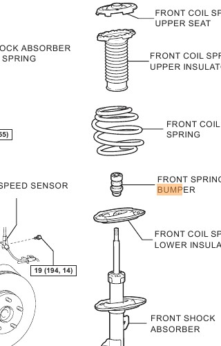

I'm looking around for a diagram of where they are on the Aurion.
Does anyone know if these are easily replaced?
Is this the bumper you were talking about (see attached picture)?
If so then it is fairly easy to replace with the right tools.
I wonder the cost.

Sorry for the triple post but I called up to get a price from Lander Toyota Parts.
$25 Each - Front
Part number 4833133032
I'm thinking of buying a 2 and just giving it a go.
