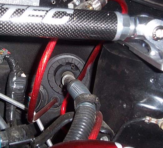

oh.. and where have u guys hooked up your ground for the amp and to get the power cable to the battery, is ther a recommended hole in the firewall i should look for?
ive done a search.. and maybe im blind, but i cant really find anything to answer my questions.. im hoping someone out there might be able to point me in the right direction :blink:

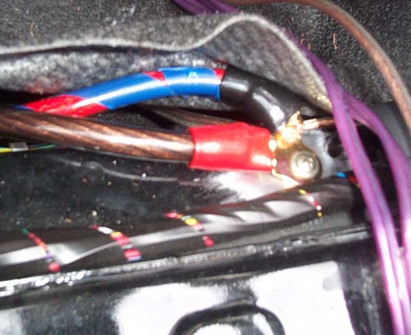

Here is my ground, is at the side step next to the front passenger seat, since my amp is under the front passenger seat, this is the logical spot.
I got two ground connected together on the grounding point. Blue/Red is to the amp and brown to the negative terminal battery.
cheers bro..much appreciated. especially the pics! :)

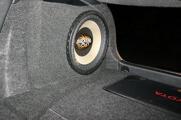

If anybody is interested in the sub box in the pic(same as the one in my car) Then sned me a PM as A friend of mine makes them. Cost around the $300 mark and fit awesome plus you still have got a boot to put stuff in. ;)
hmm few hundred more i can get the whole boot custom made, got that quoted for 700 dollars at autobarn. Thats with the whole boot remounted into a nice design with a fiberglass botom for the amp ;) and still got room for luggage. Only thing is that you lose the spare wheel . But i think i can sacrafice that.
