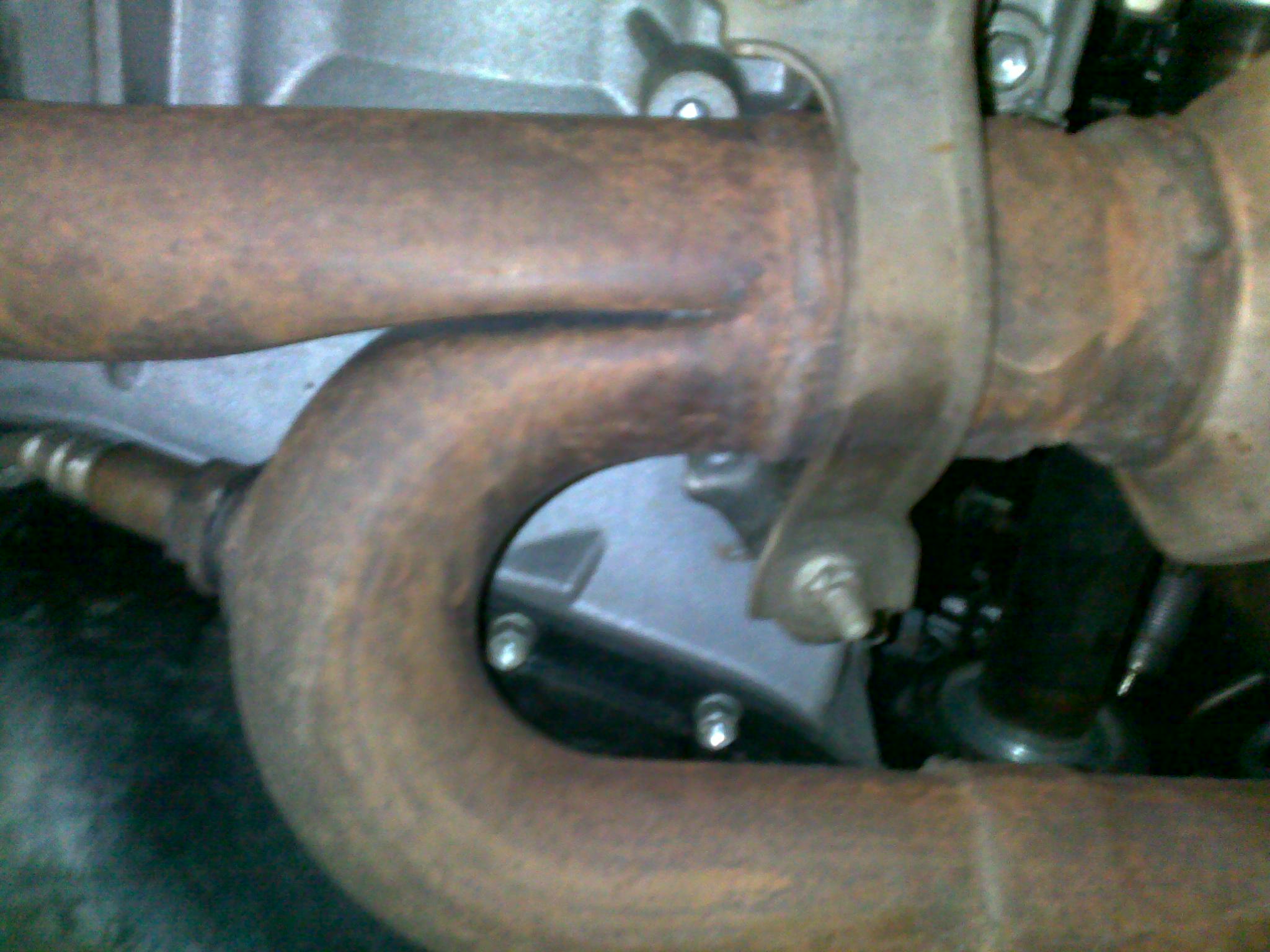

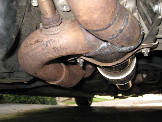

Attached are some photos of some of the exhaust work I have had done. May car sounds very different to a Std TRD Aurion now, much throatier note. It really helped open up the exhaust.

welcome to the group. Im impressed with the merge mod, much better than mine (anyone got a second hand manifold to cat ?) kept the equal length, I wish I had done so too. enjoy the club.
