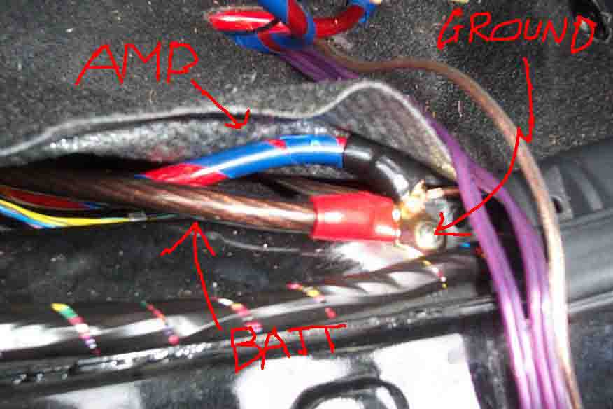

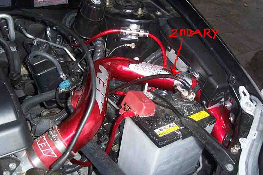

What I did to my ground, is something that perhaps most do not do with their audio system. Take note, that wherever you place your ground, even if it is the main chassis, you will face resistance. What you want to do is to reduce as much as resistance as possible. Here's what I did, perhaps 1ZZ-FE, TRD141 and Stockvvti can help out to explain it to you guys
From my ground point, where the amp is grounded, I hooked another ground cable together with the ground cable from the amplifier, and connect that second ground cable to the negative terminal.
Why dont u just plug in a engine noise filter? just need to buy another set of Rca's .. plug the Rcas running from the headunit into the filter.. from the filter the new Rcas output into the amp. done! cost is around 30-40bucks
Because that's not the real way of doing it :) This is not just to reduce noise, but to allow complete circuit of current at its most efficient way. Its like going to city by freeway, but going home from city through small road. What you want, is to have ground as quick as taking power in. Remember that chassis have resistance even if u did ground it at the main chassis. So this is what I think is the best way to do grounding, to make sure the power you need is always available and not forcing the battery.
Ever since I did this method, I have no crazy dimmings. It dims by a tiny bit at full maximum volume, and u have to squint hard to notice it, and that's from the clock only. No dims from headlight or interior lights. This is with standard battery by the way and I am running 800W amp, so that's like 400rms?
Of course, you will need the correct size of cables based on the maximum power and the distance between your battery to your amp. I uses 4awg for power and ground.
