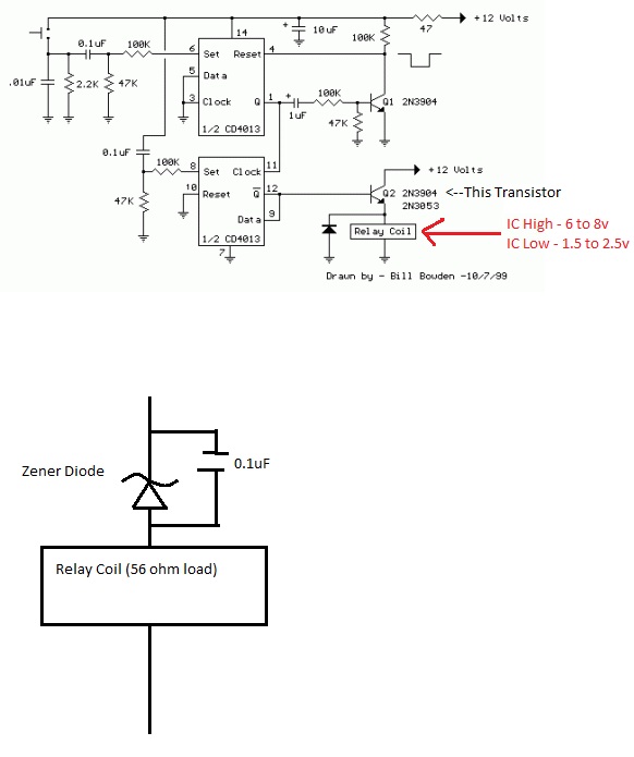

I think i have caused some confusion. My switcher is a transistor running off an ic chip, which in turn runs a 6v relay (with a diode connected in parallel) which in turn runs the switching relays
Now I'm back home at the computer I have a better grasp of what's being said here and obviously I'm in the company of some fairly experienced technicians.
One of the main reasons I'm using a 6v relay is because somehow, despite having a regulated 12v input to my IC, I'm only getting around around 6ish volts at the output of the transistor when the IC is outputting a high signal yet the main concern is that in the low state the IC is still feeding the transistor around 2volts!
With a 12v relay I simply wasn't getting the required power to switch them on, with a 6volt relay the current is sometimes too high to let it switch off (and if I add more load to the the relay to drop the overall voltage, there isn't enough juice left to turn the relay on in the high state).
my "button" IC circuit is attached. The relay in the picture is the 6volt I'm currently using. At the moment I've sort of gotten around this but connecting a zener diode in series with the relay (just normal bias as I ran out of regular diodes) and a 0.1uF capacitor in parallel with the diode. I found that only by adding the capacitor to the diode would the current be so that the relay would turn on and off (lucky guess?). The circuit appears to work in this manner but due to varying voltages in the car I'm concerned that when the car is running (and hence main power is higher, despite being regulated) the relay may be getting too much juice to switch off through the transistor (as the 2 volts in the low state is directly tied to the voltage level of the main input).
I have 2 ideas on how to fix this but no idea how to accomplish them. 1 is to make a "minimum voltage" at the relay in that if the transistor output isn't over at least 3.5 volts then no power gets through to the relay (so that way power only ever reaches it in the high state when output is at least 6 volts)
OR
figure out why the hell my IC isn't outputting only 0volts in the low state and make it so it does (circuit diagram attached. Experts please peruse and advise).
post-13080-0-65428100-1296400835_thumb.j
Well it looks like the circuit still works regardless, due to the zener diode/cap addition the relay sees 0.5v in the low state (easily switches off) and around 3.8v in the high state, which is only just enough to activate it (most likely will be higher though when the engine is actually running).

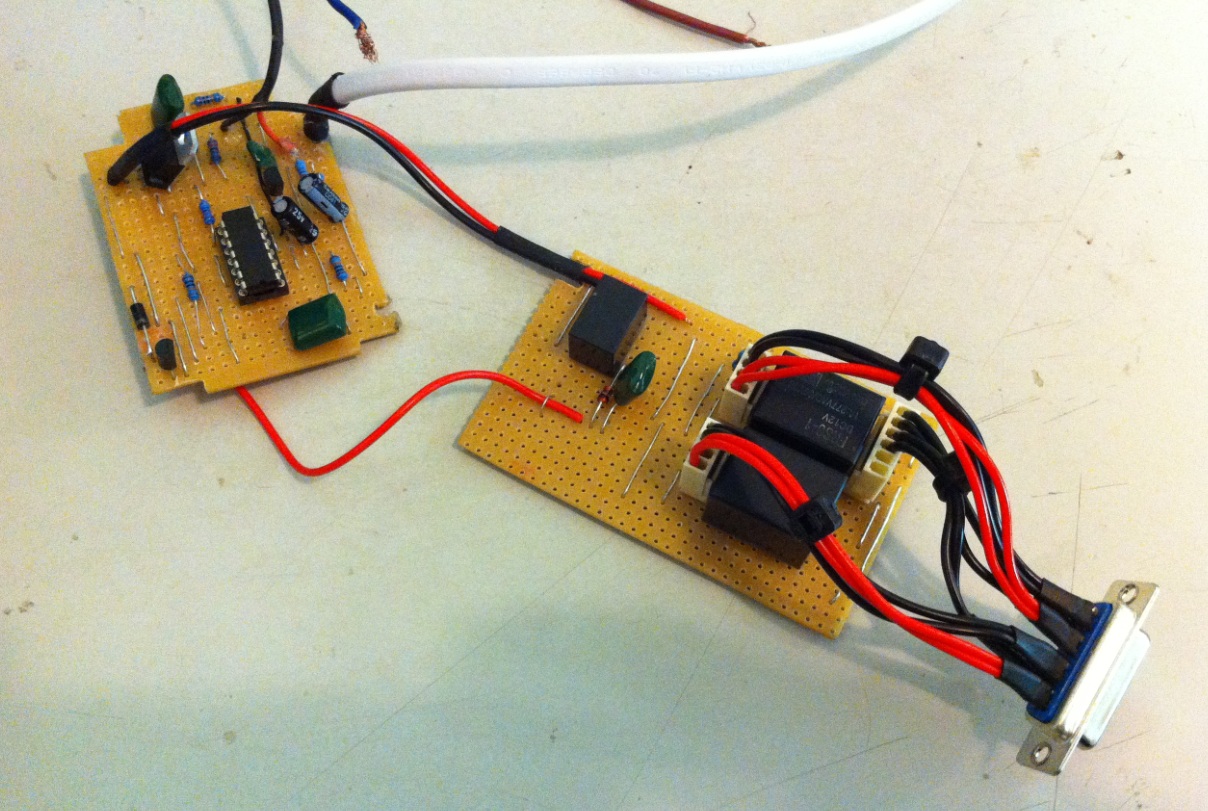

post-13080-0-44728400-1296442036_thumb.j
Now it's time for the longevity test. I wish I opted for an electronic circuit because that way I could use a proper button like you. Laziness got to me though unfortunately.

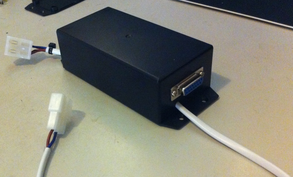

So... time now to build that interceptor connector I discussed with you earlier and to sell it as a mod :lol:
