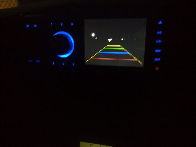

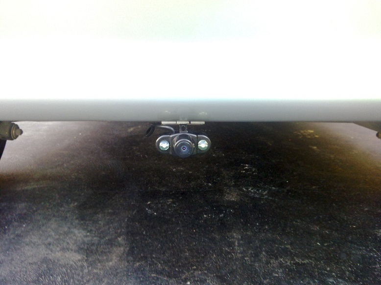

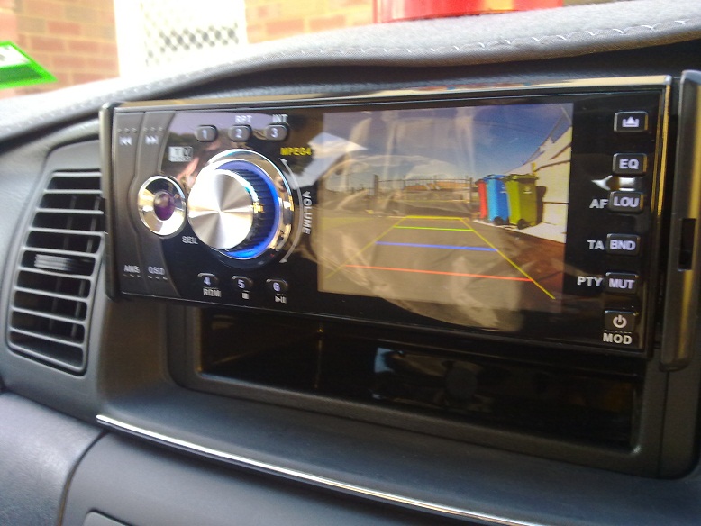

Job done.
Just wanted to show you guys some photos.

Hi there, nice work!
I´m in the same stage you are installing a reverse camera. I have a couple of questions for you:
1) Why did you choose that spot to mount the camera? do you have a better view?
2) The colour lines you see in the screen, are part of the camera signal o is it a function of the HU you have to show you how far the sorrounding objects are ?
