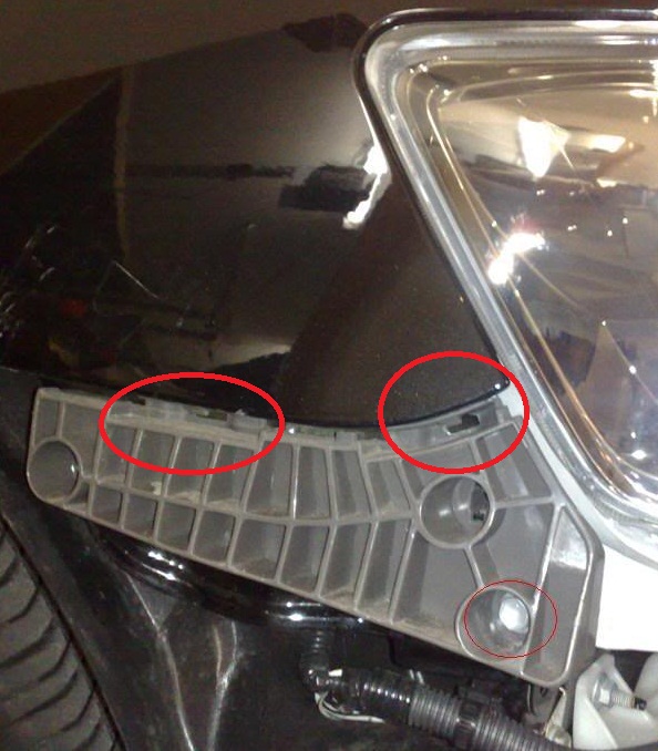

Okay I'm back from work so I can write this up properly.
Essentially the problem lies with the side retainer clip that the bumper clips onto. The clip is probably best described as a U channel lying on its side. Over time the weight of the bumper plus the elements (ie hot summer days etc) causes the plastic to soften and the U channel to expand slightly, which results in the bumper dropping slightly as well.
This can be fixed in one of 2 ways. The obvious is 2 replace the side retainer clips from new ones from Toyota (no idea on cost). The other method involves using a heat gun to soften the plastic and close the U channel back up (even going further if you want). I did this on mine and the gap has come up perfect.
The image below shows the points that need adjusting. Ignore the lower red circled area, it's the upper 2 red circled areas that often need fixing.
You don't need to remove the front bumper to remove these retainers, simply popping out the sides will give enough clearance to remove the clips from the vehicle. Once you remove the retaining screws they come off fairly easily. If you need more help on popping off the bumper check the FAQ for detailed instructions.
