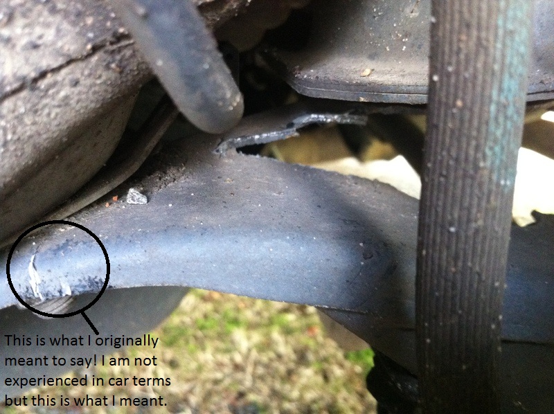

So a good while ago i installed a rear sway bar
and the last couple of months there has been some creaking
and today i find this
Any idea what that part is called?
i'm thinking my best bet is just finding the part at a wreckers
Cheers

A for effort lol. Part number your after is 52204-33030 (LH), 52203-33030 (RH), $93.10 stock ex Melbourne warehouse. :)

Looks like its the REAR SUSPENSION MEMBER LOWER STOPPER from what I can see in the manual
I don't know if this would have had any part contributing to it but from the looks of the photos, did you use the white brackets that were supplied with the sway bar? They stopped sending them out on the newer batches because they don't fit right but if you got a sway bar from the older stock, you would have gotten those brackets.
The white ones they used to supply were not bent at the right angle so if you did use those, I'm surprised how both surfaces of the bracket look to be flush with points where they mount.

Thanks guys will try and get the part tomorrow, hopefully someone in Sydney has it on hand
Yes i used the brackets that were supplied but i think it is the older stock so i don't know what the deal is there
What were u suppose to do if the brackets didn't fit right?

I reckon you would be all kinds of lcuky to find any dealer with one of these on thes shelf. It's not someting that ever break or needs replacing lol. Also now you just use the OEM bush brackets. :)

I'll try my luck and when that fails hopefully with find the part from someone who is wrecking an Aurion and there not to far away.
Any suggestions i live on Sydney's North shore
I am embarassed to admit I am wrong in thinking the part I was talking about was the wheel arch. This part I have circled is what I am actually talking about. I can see a tiny crack on the top bit within the circle. A hairline crack. Dust may have hidden it but zoom in and you see what i am talking about?

That entire piece is broken though as per the original post. That small crack is as a result of the main break. I would imagine this crack isn't going to be an issue once the component is replaced.
On a side note, who fitted the RSB and how were the brackets attached (eg. rattle gun)? The ones UR used to supply were prett beefy and I would t imagine them to budge much of tightened up to the factory mounts. In that case, they could have been applying extra stress to the mounting points.

I installed the RSB and i just used a normal ratchet,
If that is the case and the bracket isn't a perfect fit and could have helped cause the problem, what do you recommend? source an aftermarket bracket?

Now that I'm home and could have a good look at the photos, I don't think the brackets wouldn't have had anything to do with it. I was thinking that due to the fitment, it may have caused the RSB to sit in a different position to normal and potentially putting extra stress on the mounting points, but when I look at it now, it looks to be sitting in the right spot. As for what to use instead, no need to source anything else. Adamsy said it above:
... Also now you just use the OEM bush brackets. :)
