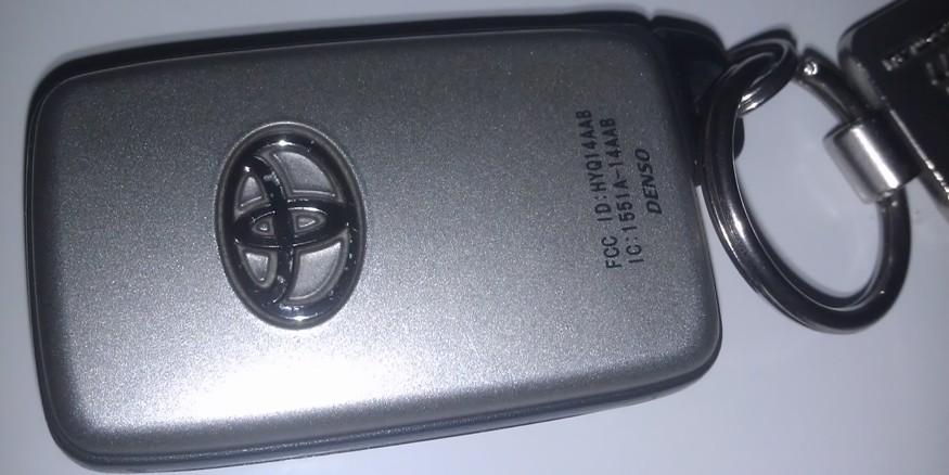

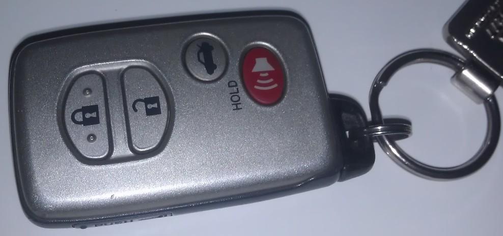

Hi Guys,
Bought an Aurion zr6 '08 model today... pretty exciting!
One problem - it only came with one key. I'm looking on ebay for a spare but some people are saying on forums that they are only available from Toyota for $490?
Has anyone had any luck sourcing them from ebay or elsewhere?
Thanks for your help!post-13835-0-67195200-1378615113_thumb.jpost-13835-0-79399000-1378615125_thumb.j
Don't waste your money on the Ebay/ China ones. I have tested a couple of these and even though they are the correct frequency and identify as having the right chip for the transponder they wont code in. You also need a scan tool to code it in which would mean you will be paying someone to attempt to code in your key.
Go to an Auto Locksmith, you will get it for the same price as Toyota sell it except you won't have to book your car in for half a day, the dealers get the keys cut my the Locksmith anyway.

I have found a couple of sellers from USA - they seem to have 2nd hand keys... perhaps from written off lexus?
Here's a link (sorry, I don't know how to hyper-link):
http://www.ebay.com/itm/LEXUS-KEYLESS-KEY-REMOTE-ENTRY-FOB-1551A-14AAB-HYQ14AAB-271451-0140-/230833867284
The serial number HYQ14AAB is the same as my remote.
