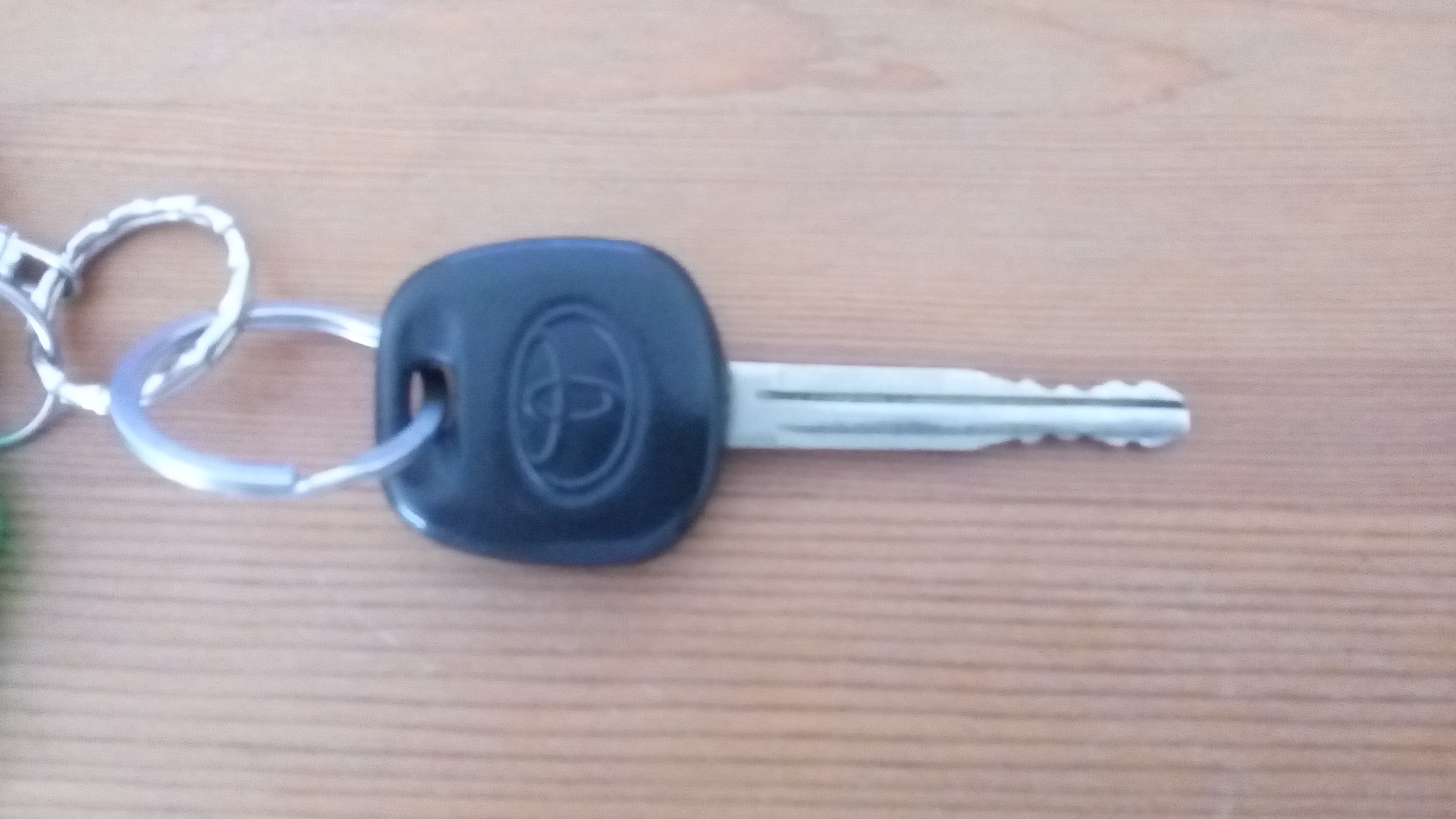

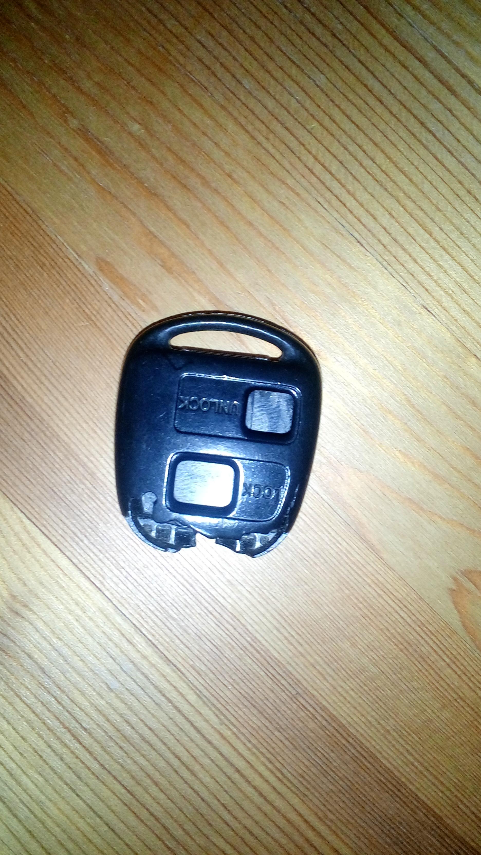

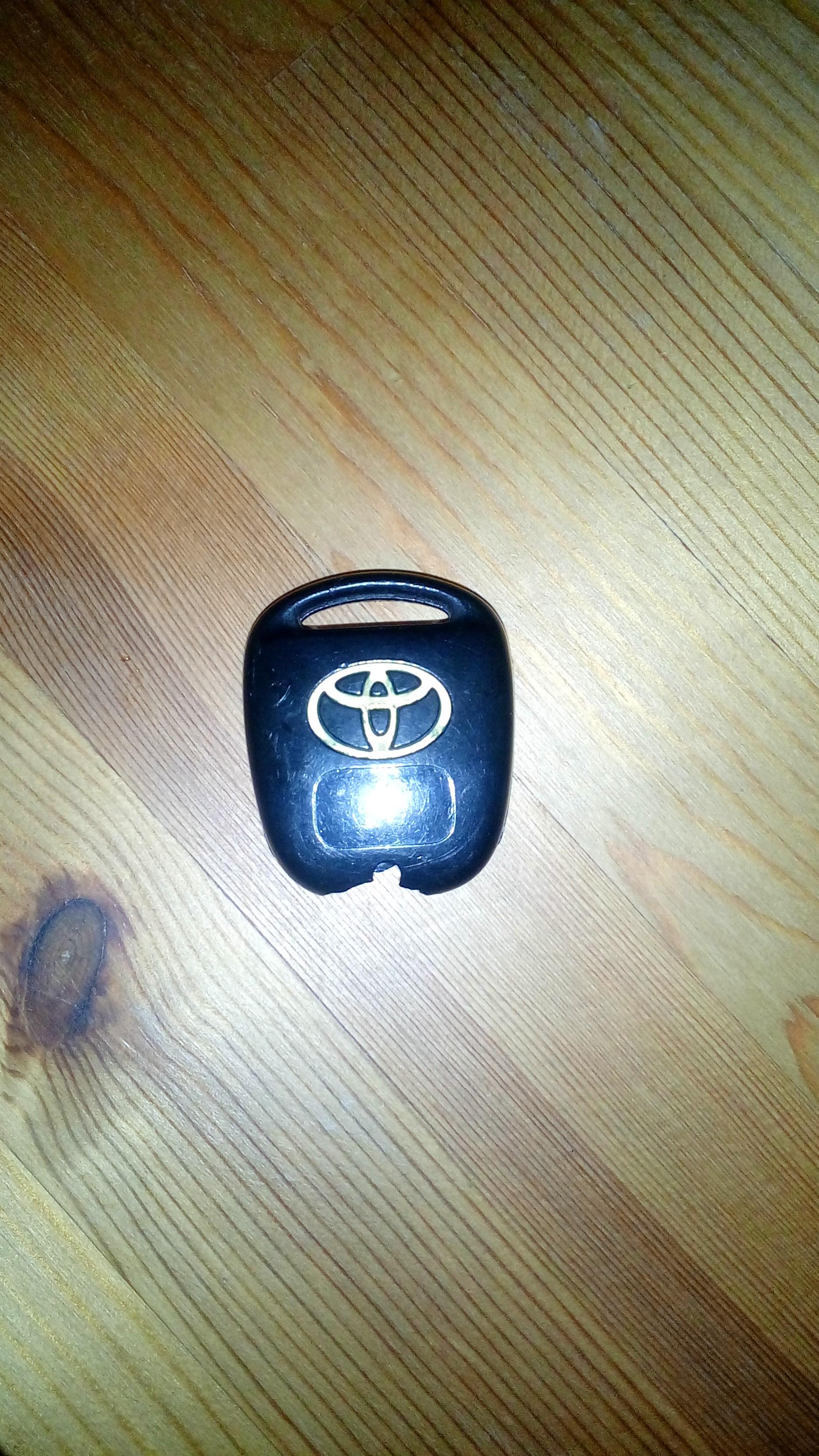

Post up a photo of what your key and remote looks like and we might be able to tell which one it is (or if it's a newer system which is different again)
Let me explain again.
I wanted to buy a key from ebay or somewhere else but i need the Remote frequency and Transponder chip number (not chip code) to make sure i buy the key which is compatible with my car. I will get the key cut and programmed.
These are the pics of my Master Key and Broken remote(got nothing with it no remote no key etc):
