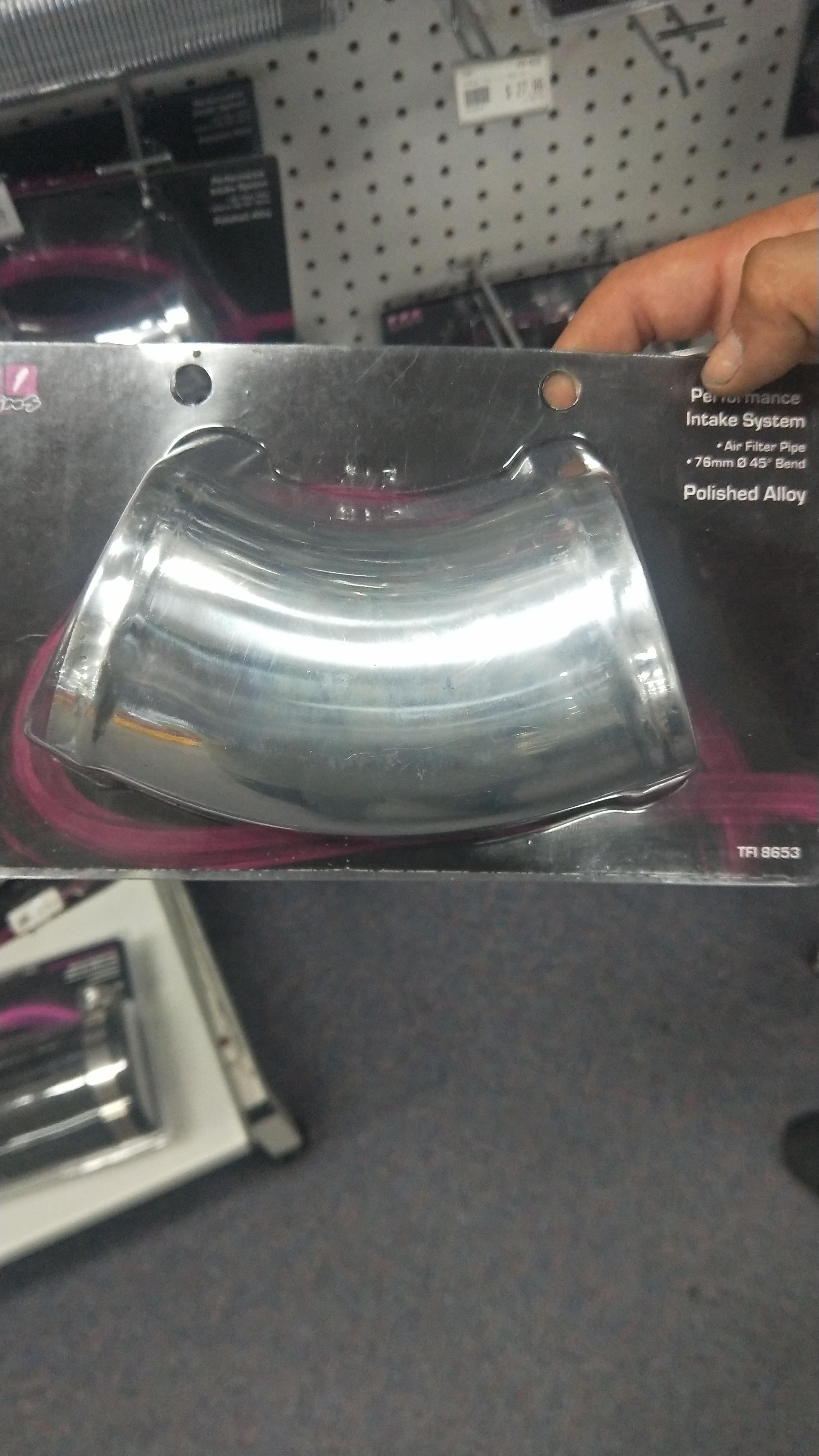

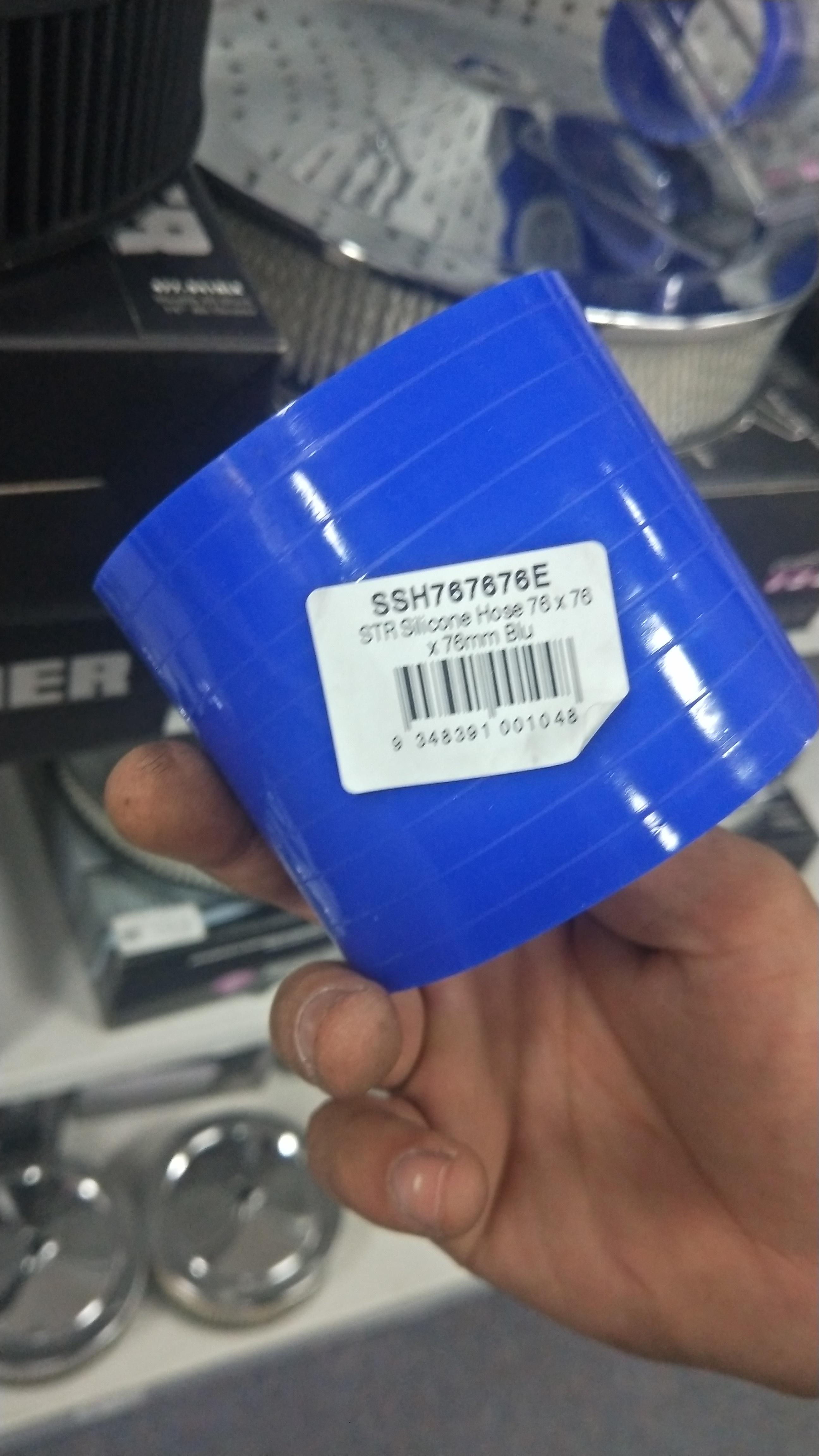

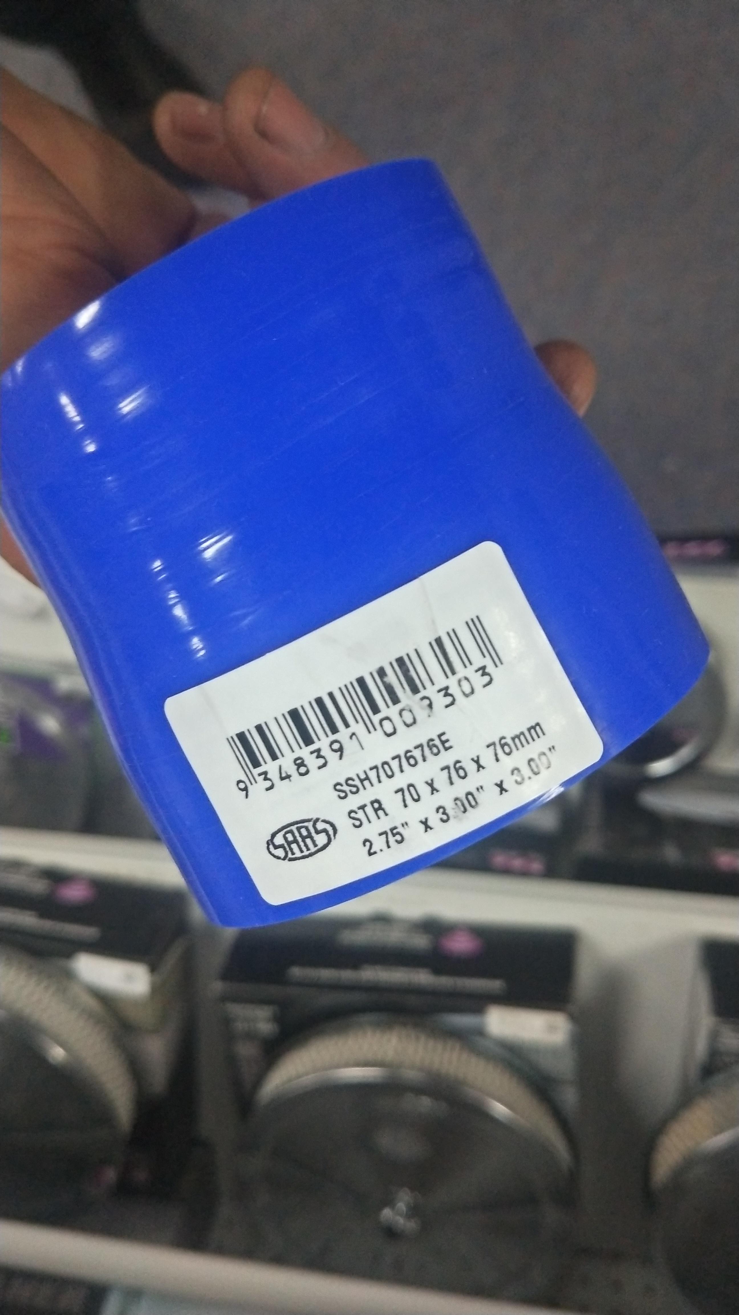

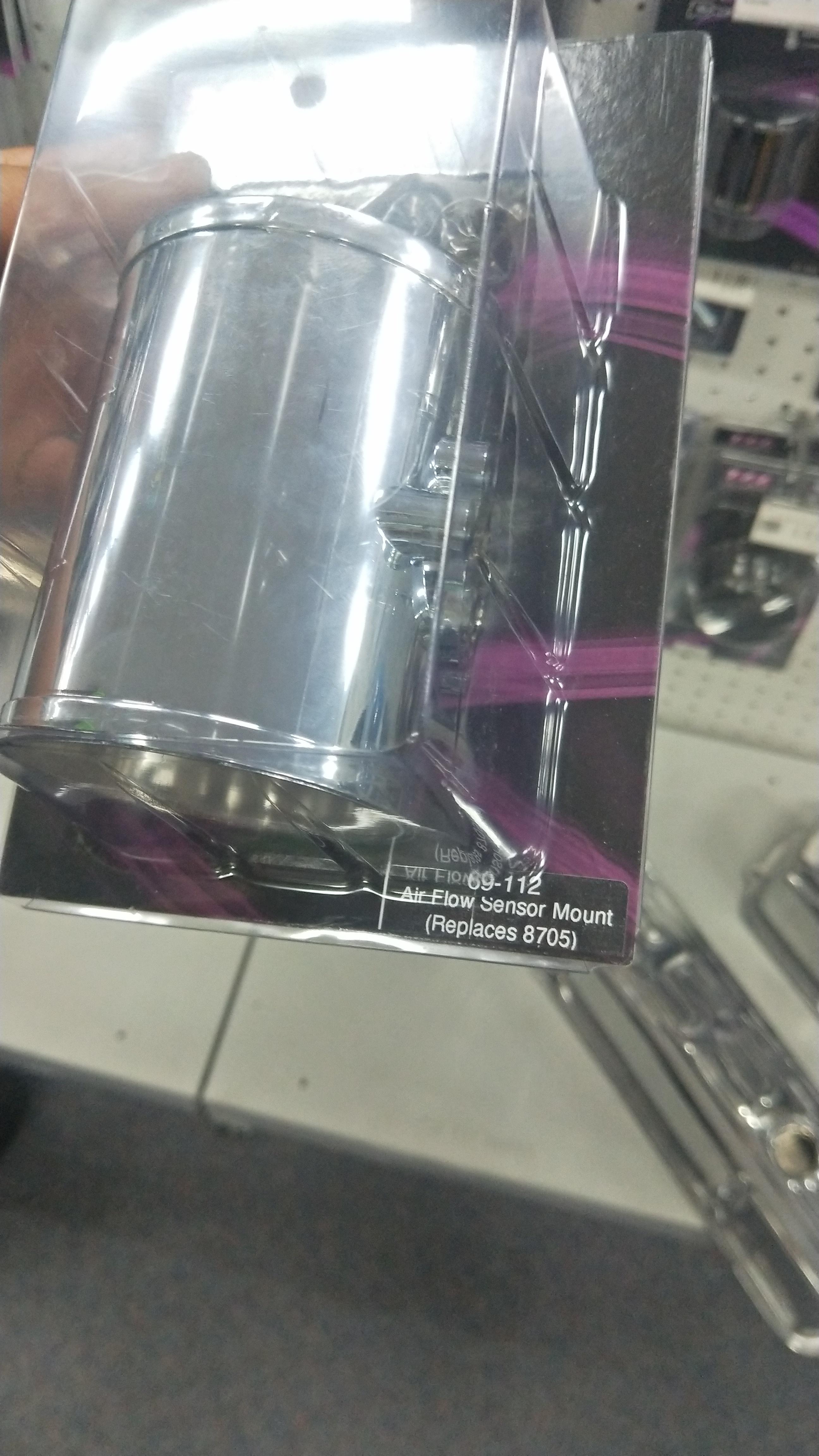

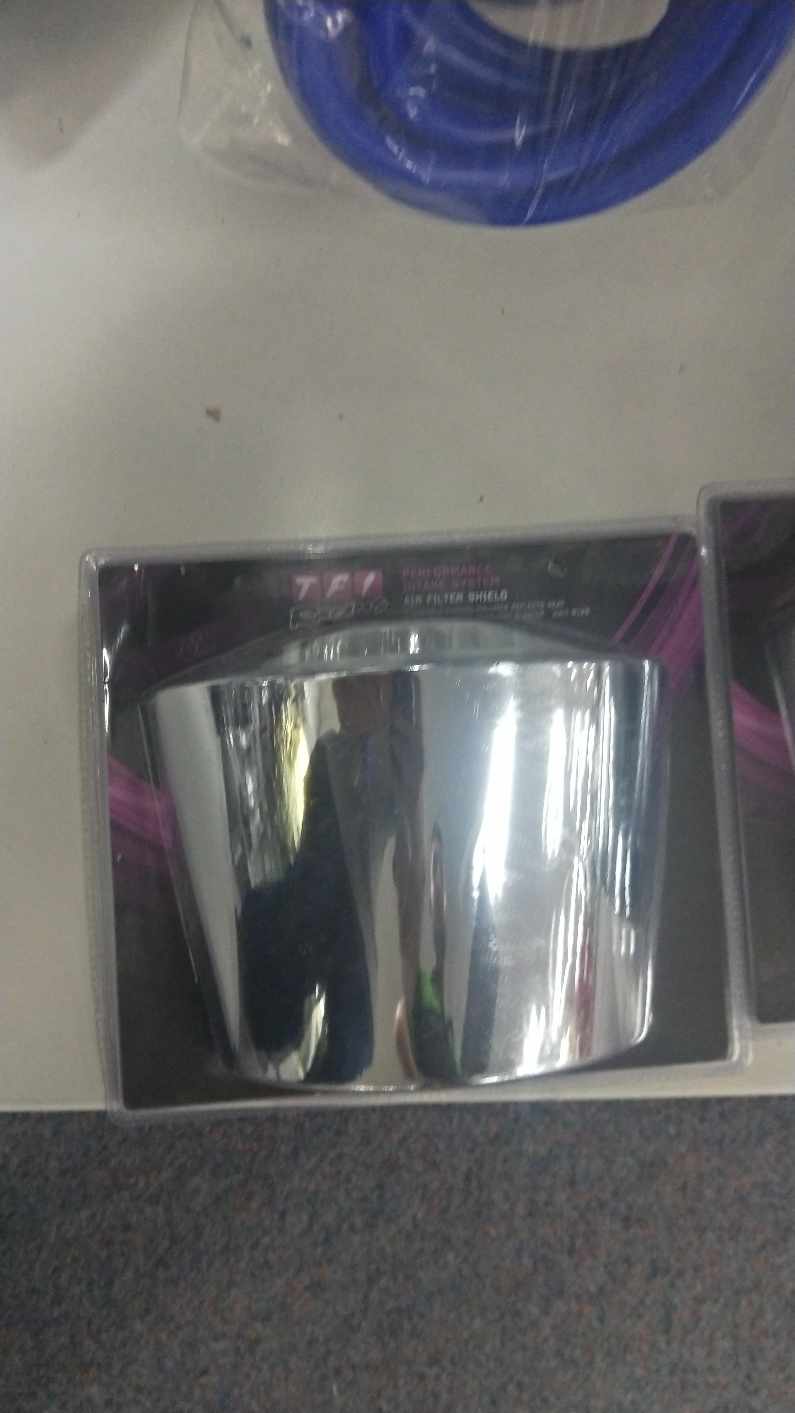

Here are photos of the parts I used:
Note - the 2.75in to 3in hose didn't fit on the throttle body so I had to use a regular 3in PVC Hose
I also used hose clamps even though there are no pics of them below hahaha

Here are photos of the parts I used:imageproxy.php?img=&key=54ab0745942fa001
