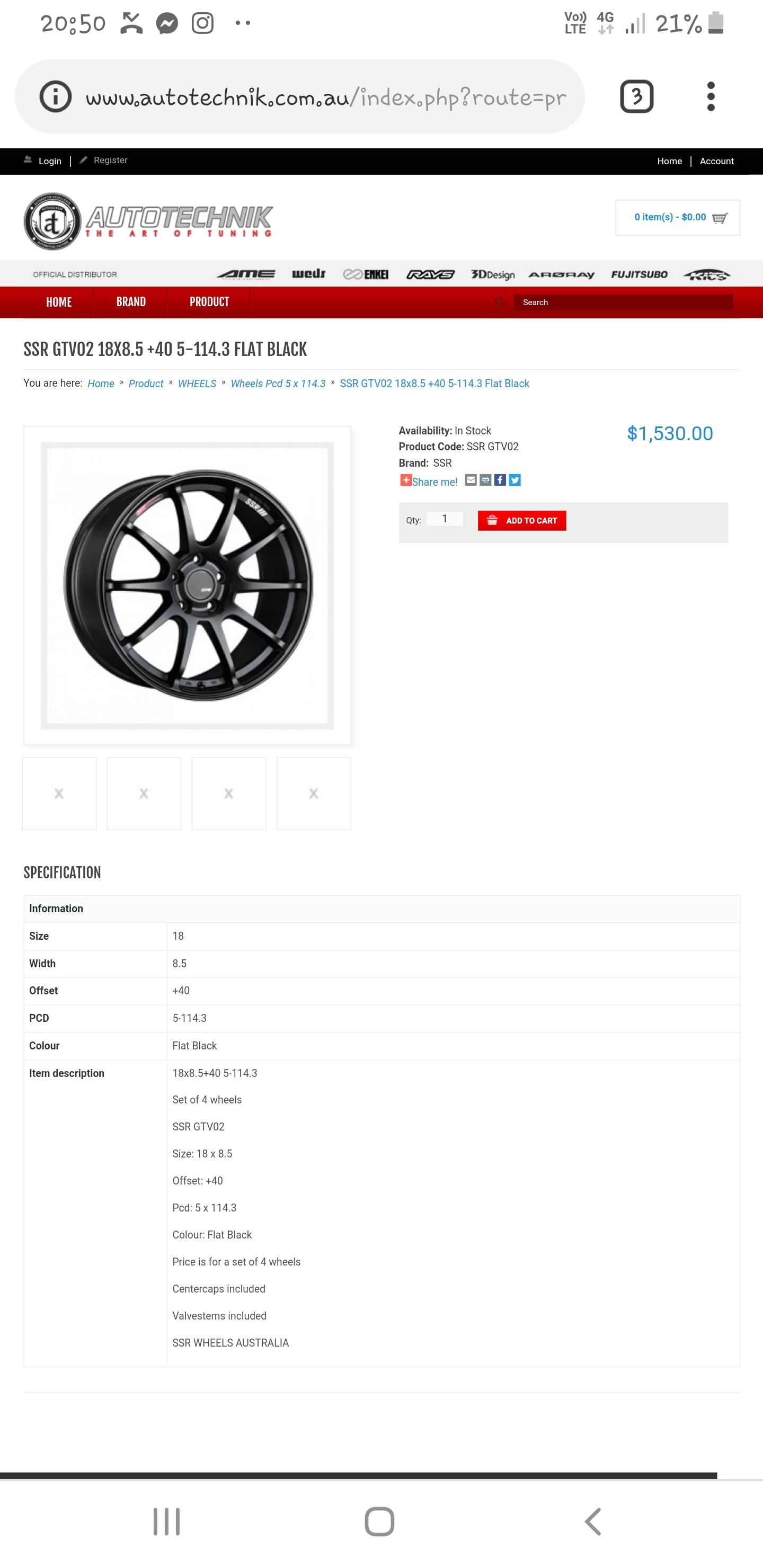

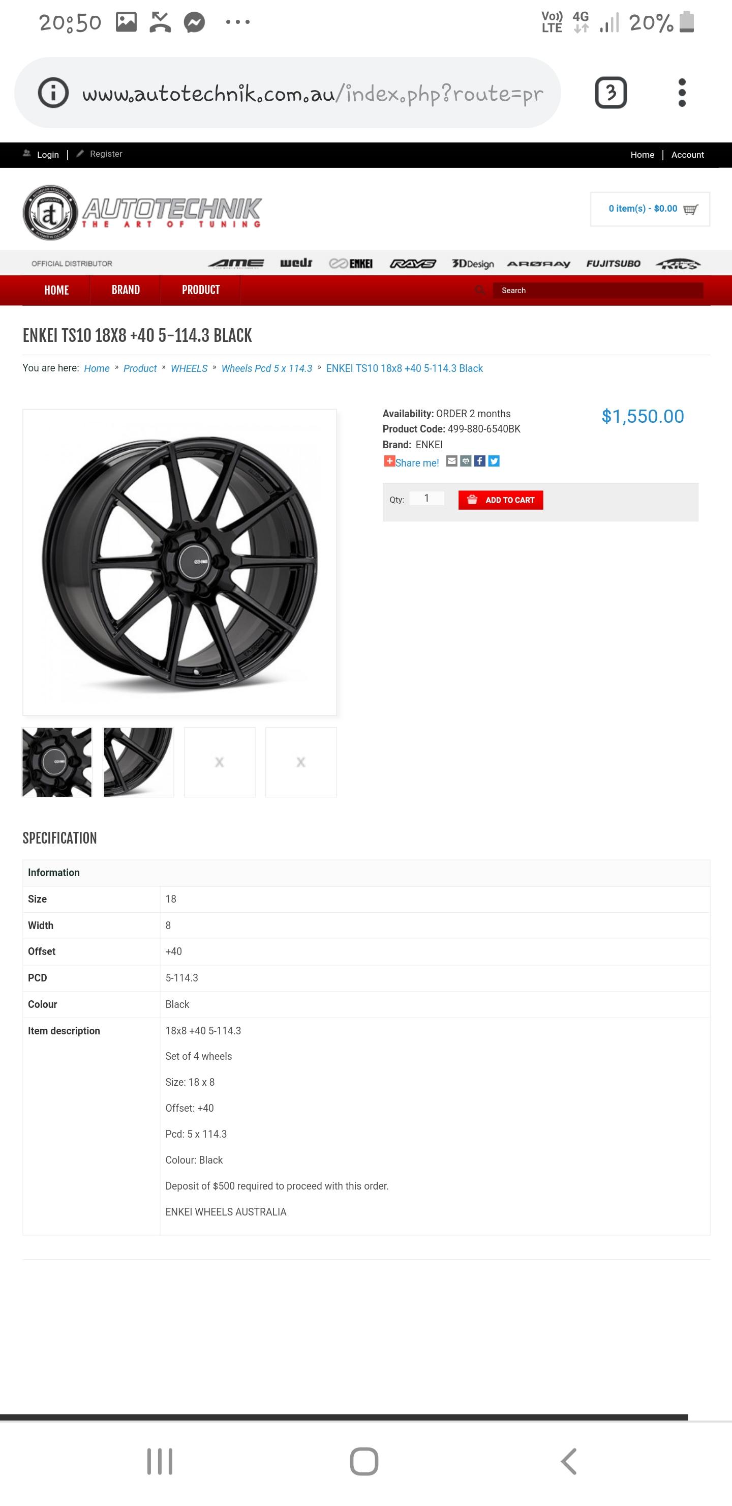

Hi. Im planning to buy wheel set for my 2019 Camry Sport but I'm not too sure if it will rub or not with stock suspension. Im buying, ENKEI TS10 18X8 +40 5-114.3 BLACK or SSR GTV02 18X8.5 +40 5-114.3 FLAT BLACK. They are the same offsets but different widths. Will these rims fit? Im not too familiar with cars so im really struggling. Also what is the stud pattern of camry? Is it 1.5 or 1.25? Thanks.

Do you think that 8.5Jx18 or 8Jx18 ET40 and ET42 will fit without any problems?
