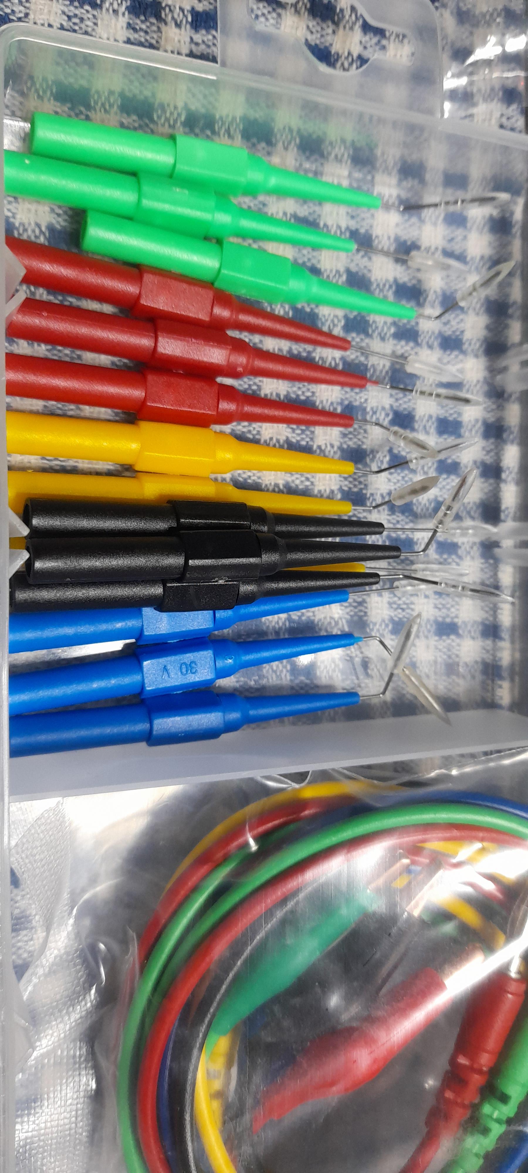

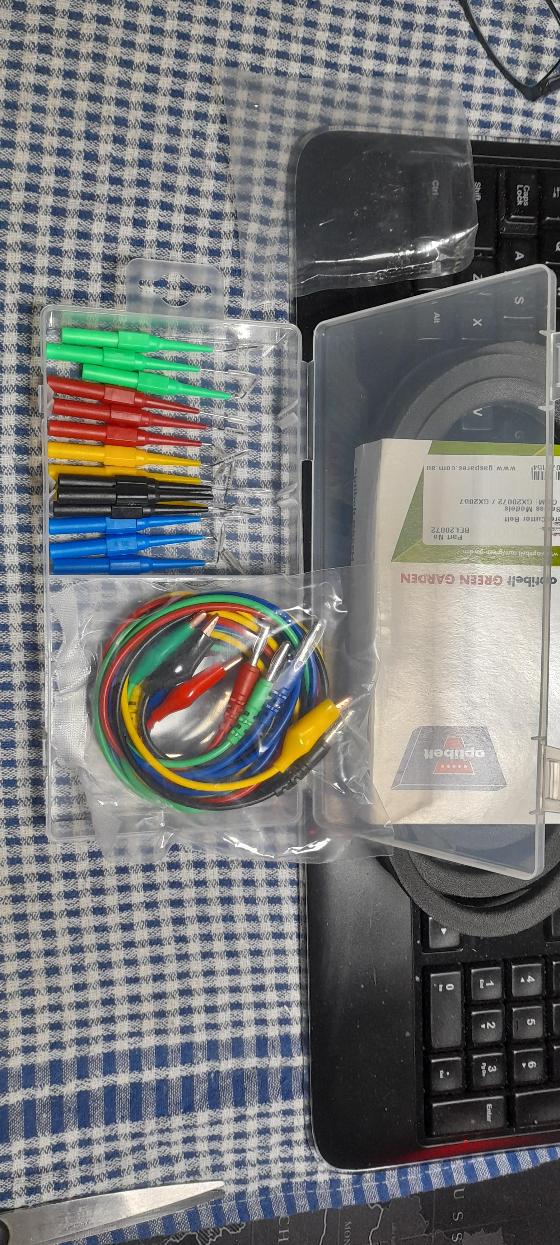

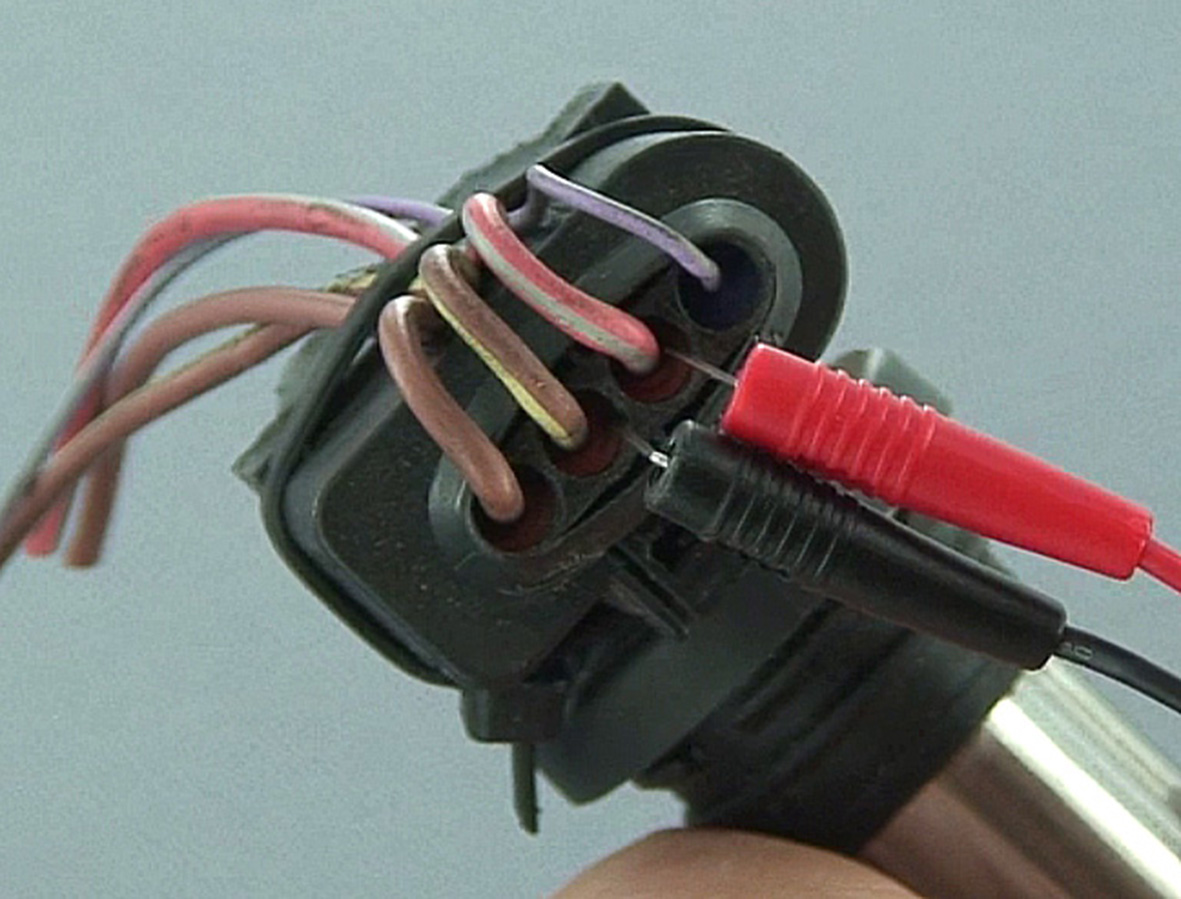

Haha, yeah me too. It requires a little patience, the right tools and some free time. I recently purchased some back probes as an addition to my multimeter to be able to probe those modern connectors as they have these rubber gasket seals where the wires enter the sockets. Back probes are very fine needle like instruments to be able to slide into the rubber seal and make contact with the conductor inside the socket. Normal meter probes are too tick and virtually impossible to penetrate. Only good for general testing and those older molex plugs where you can actually see the metal connector through the sides.
If you have access to a vehicle schematic with all the values for the given points then this will help problem solving.
