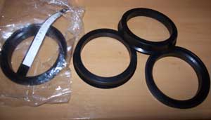

You can put them on your car .. but not use spacers ... but Hub rings ...
they are polycarbonate rings they do not corrode, cause rattling, or show signs of wear like metal! polycarbon is extremely durable and forms a tighter seal between the hub and the wheel. these will not melt, crack, or break over time under normal use. suitable for street and track use.
Most places will order them .. very popular in USA
I got some ANZ rims and got a set of hub rings from USA .. perfect fit if you get the right size to match rim and do not alter any safety they just keep the wheel in the centre
and perfectly legal not like spacers that change the offset and the connection between rim and hub

Hub rings perform an entirely different purpose to that of wheel spacers. Hub rings are designed primarily for aftermarket wheels which tend to have an oversized centre hole, to cater for all spigot designs. The vertical loads of the wheel are supposed to be transmitted through the spigot, and the hub ring ensures that the wheel sits on the hub as opposed to transmitting the loads through the wheel studs (which are there purely to transmit torque)
Wheel spacers are used to change the offset of the wheel (aka the distance between the hub mounting face and the vertical centreline of the wheel/tyre), and also to change the PCD/stud pattern of the wheel. Some of them have spigots, some don't, and most with spigots probably still need hub rings too, because they aren't designed for specific cars, just general dimensions

Yes .. Hub Rings .. thats what i am talking about .. i got mine from USA cause they know what they are talking about over there .. very commen i am selling a set i got which were wrong size .. see pic
Corolla 2001 above is 54.1mm then gotta work out rim size hole and match it
