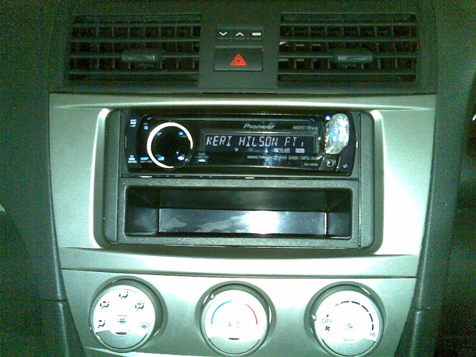

In the interest of feeding my habit for resurrecting old threads, I'm gonna do it again.
Has anybody bought and fitted this fascia kit from fascias.com.au or this Camry one from Aerpro?
Wondering how well they match up with the rest of the dash silver. I bought the $30 genuine fascia from my local Toyota dealership, which of course color matches perfectly, but as has been well established here, theres a good half inch of gap either side of my head unit, and I'd much rather get a proper DIN width fascia if the color looks right, instead of getting black spacers to fill the gap.

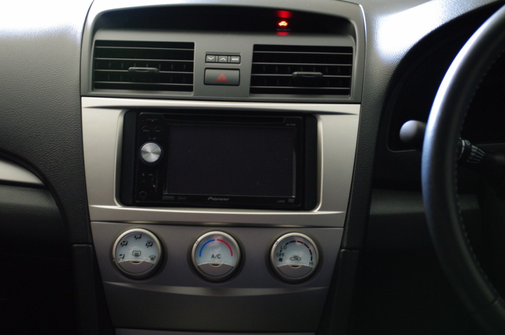

That gap can be filled with spacers bought form the parts store. Completely fills the gap, I will try and take a picture when I get the chance tomorrow. But here are the parts numbers and prices for everything:
Spacer: Left - 86221 52050, Right - 86221 52060 ($16.60 each)
Single DIN pocket: 55521 YA020 20 ($11.70)
Fascia: PZQ60 33030 ($30)
Hope that helps a bit.
are you guys referring to these gap fillers?
You can it from JB hifi for less than $20 & it'll fill the gaps with no problems..

Hi Paradigm,
I purchased the kit from fascia kit from fascias.com.au that you mention, it's a different colour to the rest of the dash, I ended up using the genuine one with the spacers added. A pic attached if you're interested.
