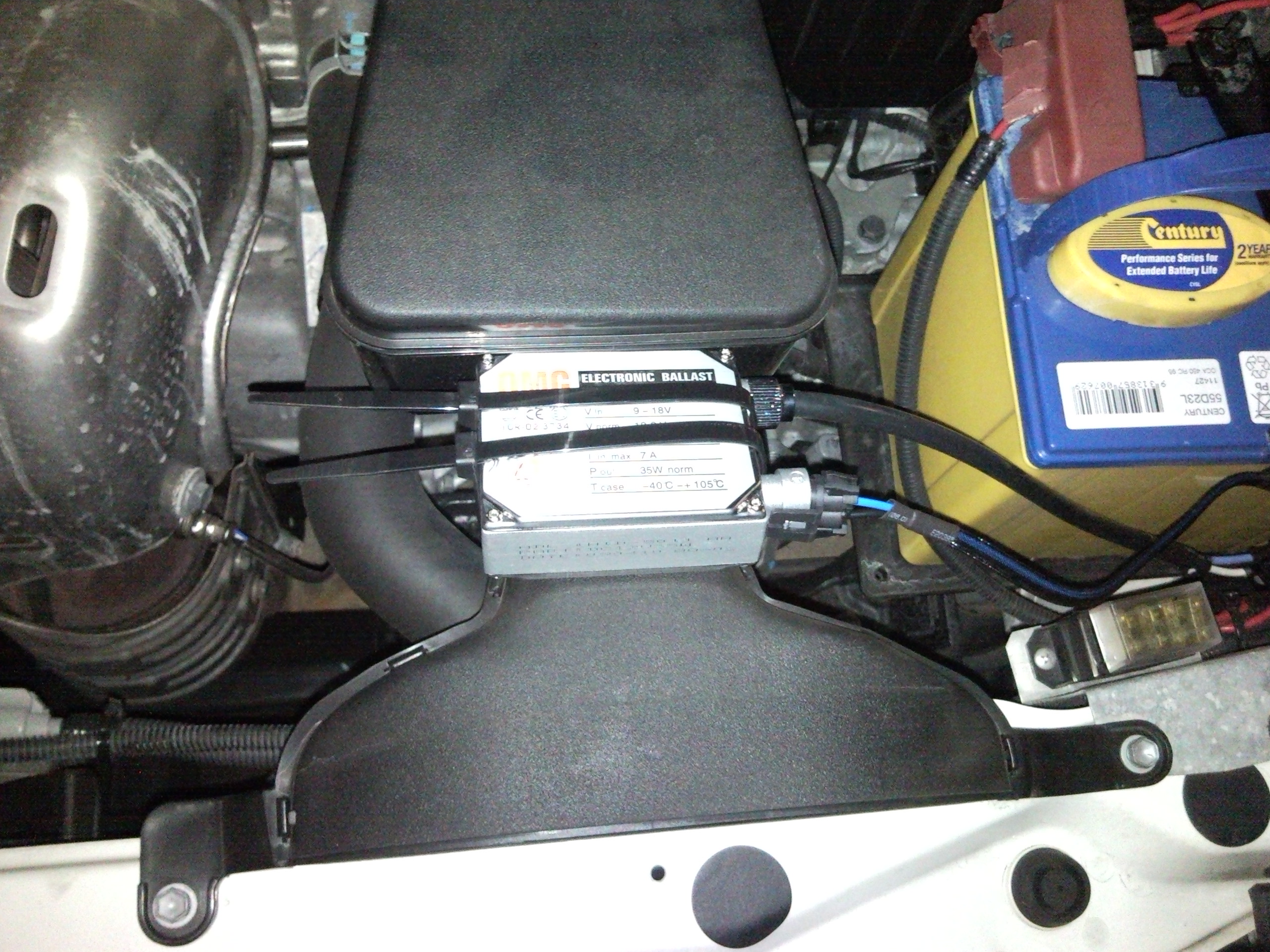

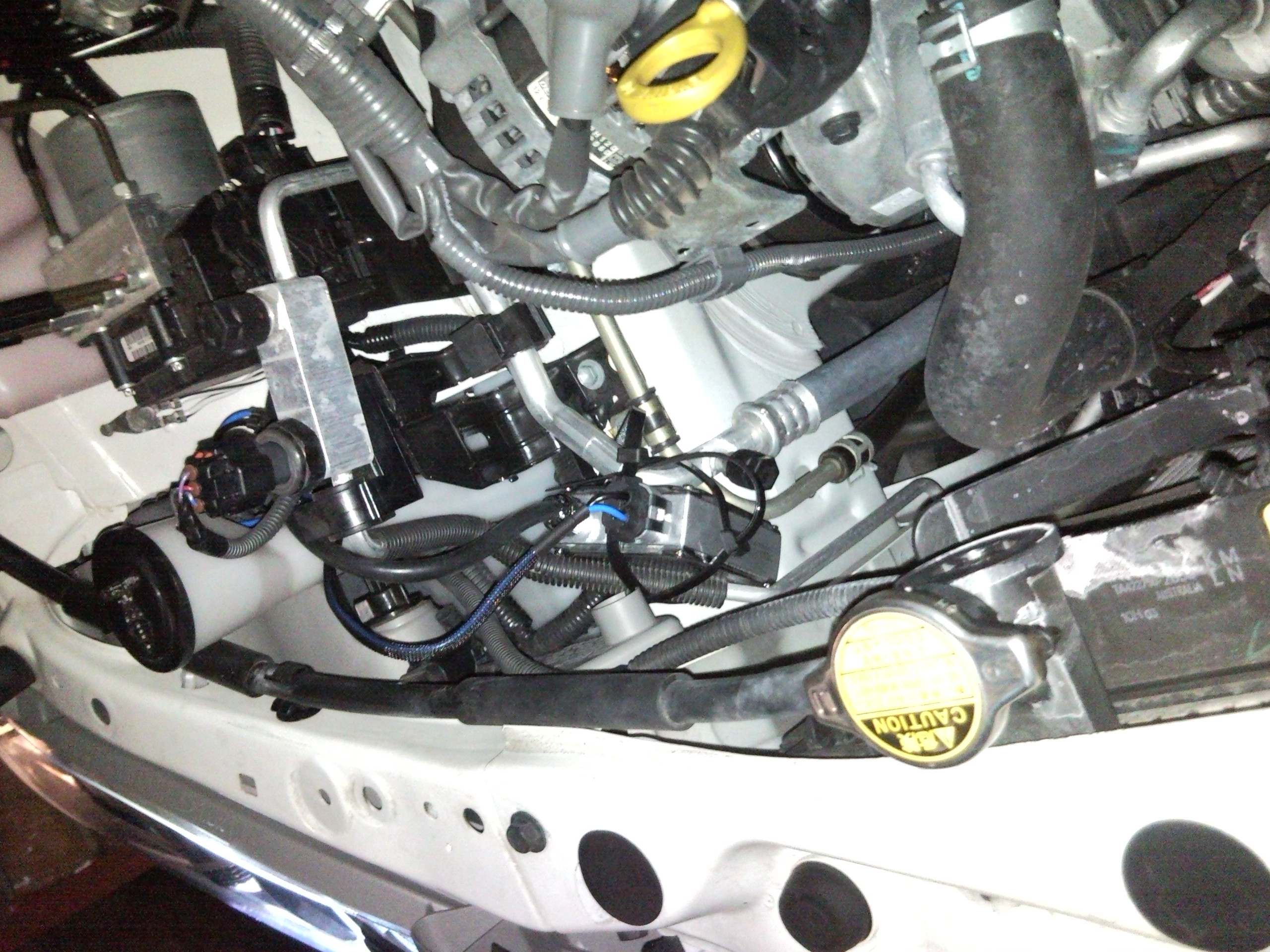

I just want to ask Aborchy and l10n_k1ng that where do you mount the ballast for the left head light? I can't find a suitable place to mount it. A picture would be great.

Sorry for the very late reply here....have been OS.
Anyway I attached the ballast next to the fuse box on the passenger side and next to the ABS mad on the drivers side. Both secured with cable ties so no drilling required.
Hope this helps.

Thanks Aborchy,
I've also managed to cable tied them securely inside engine compartment. 2 pictures attached for anyone interested in knowing where to put them.
