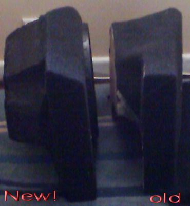

If you look closely you can see the difference between the new design and the original box (as you can see in Silvabullits garage).

Hear is the list of changes of any one else that would like them :-)
1. The new box is moulded straight off the Corolla, however the first
version consisted of an mdf back with fibreglass sides, so it wasn't an
exact fit like the new box is.
2. Because the new box takes up the entire space, it is now exactly 1
cubic foot, which allows you to put any 12" sub in it and still get
optimum sound quality. The old box was 0.8 cubic foot, which meant that
you could only use 10" subs or very few 12" subs.
3. The front of the new box also moulds completely into the shape of the
car, it looks like it is from the factory.
The price of these boxes is $399 (carpeted) OR $499 (Vinal)
Enjoy!

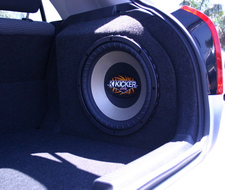

Looking for a sub box that doesn't take up all your boot space? Well mate of mine has designed a sub box for a 12 inch sub that fits neatly in the boot without taking up all of your boot space. If you're interested in buying one they are $300 and consist of a fibreglass and mdf construction to make it very light. Most of the weight in it is the sub itself. You can still access your spare tyre easily and the box is easily mounted.

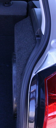

yo armstrong, couple years back when i first saw sb's sub box, i liked it so much i went and built one of my own.
heres a few pics of the build..
after several layers of masking tape and foil to ensure that the resin doesnt soak into my cars interior, i laid out several layers of fibreglass and resin to create the shell for the back. thinking back, it may have been smarter to mould the fibreglass with mdf on the base... which i had prepared but for some reason i didnt end up using it.. stupid me.
after making a sub ring to suit my sub, i mounted it using some mdf offcuts
used a smaller sub so i can save enoughspace to fully recline the rear seats as well as leave enough boot space for the pram.
stretched some spare fabric (thin.. kinda like bedsheet material) and glued it into place, then layed a weight in the centre to keep it tight like a tiger while it dried.
after that step i laid several layers of fibreglass over the fabric. (i did NOT FIBREGLAss the centre where i was going to cut the fabric to fit the sub.
got a bit anxious so after i had finished this step so i test fitted the sub.
layed bodyfiller over the top to ensure it was extra stiff.. added weight to the box but it was for the greatergood. i could have chosen to smooth it completely to paint it, but instead i chose to coat it with carpet.
this was kind of an afterthought, but i fitted this in the back for convenience
fin.
this is definately something you can do yourself. you can go to autobarn and check out the commodore custom moulded sub boxes and find that they laid a bit of mdf in the base of the box to help distribute weight. my sub box doesnt stand freely on its own so if i didnt secure it properly, it would simply fall over. so its important to think about weight distribution or securing the sub using screws or some other method.. whichever works best for you.
my guess is you save 50-100 by doing it yourself (provided you dont make a mistake and redo everything from scratch)
