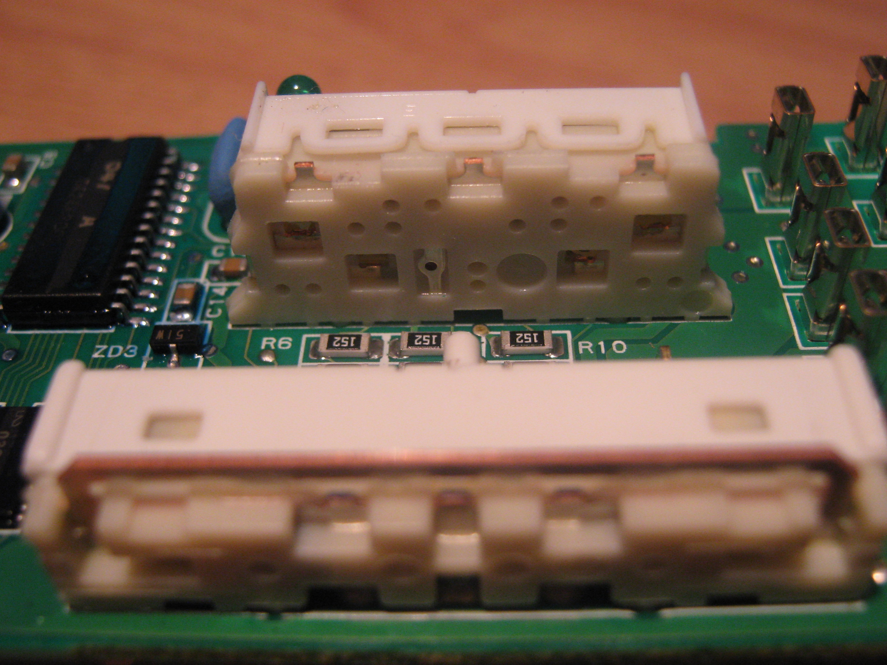

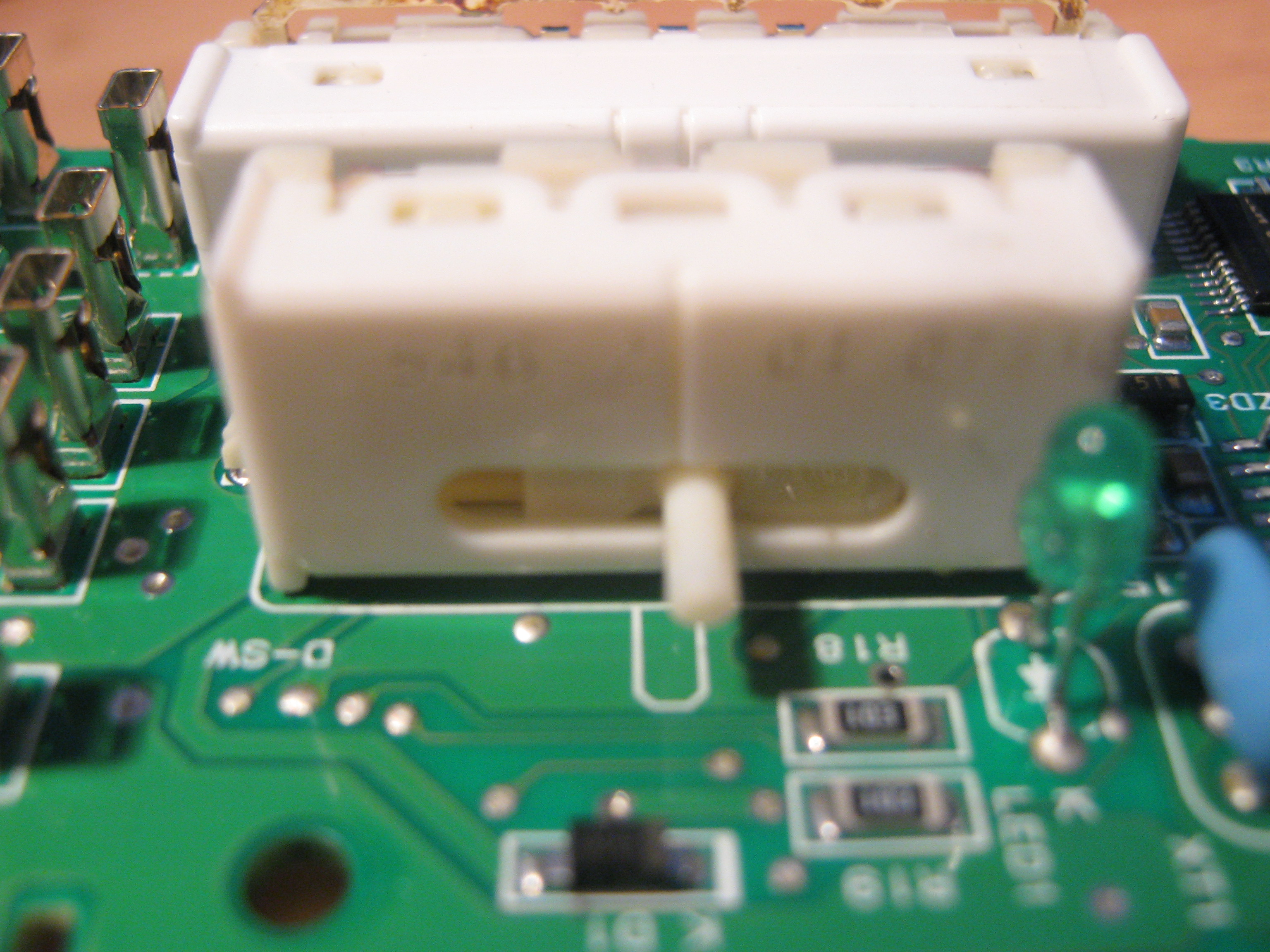

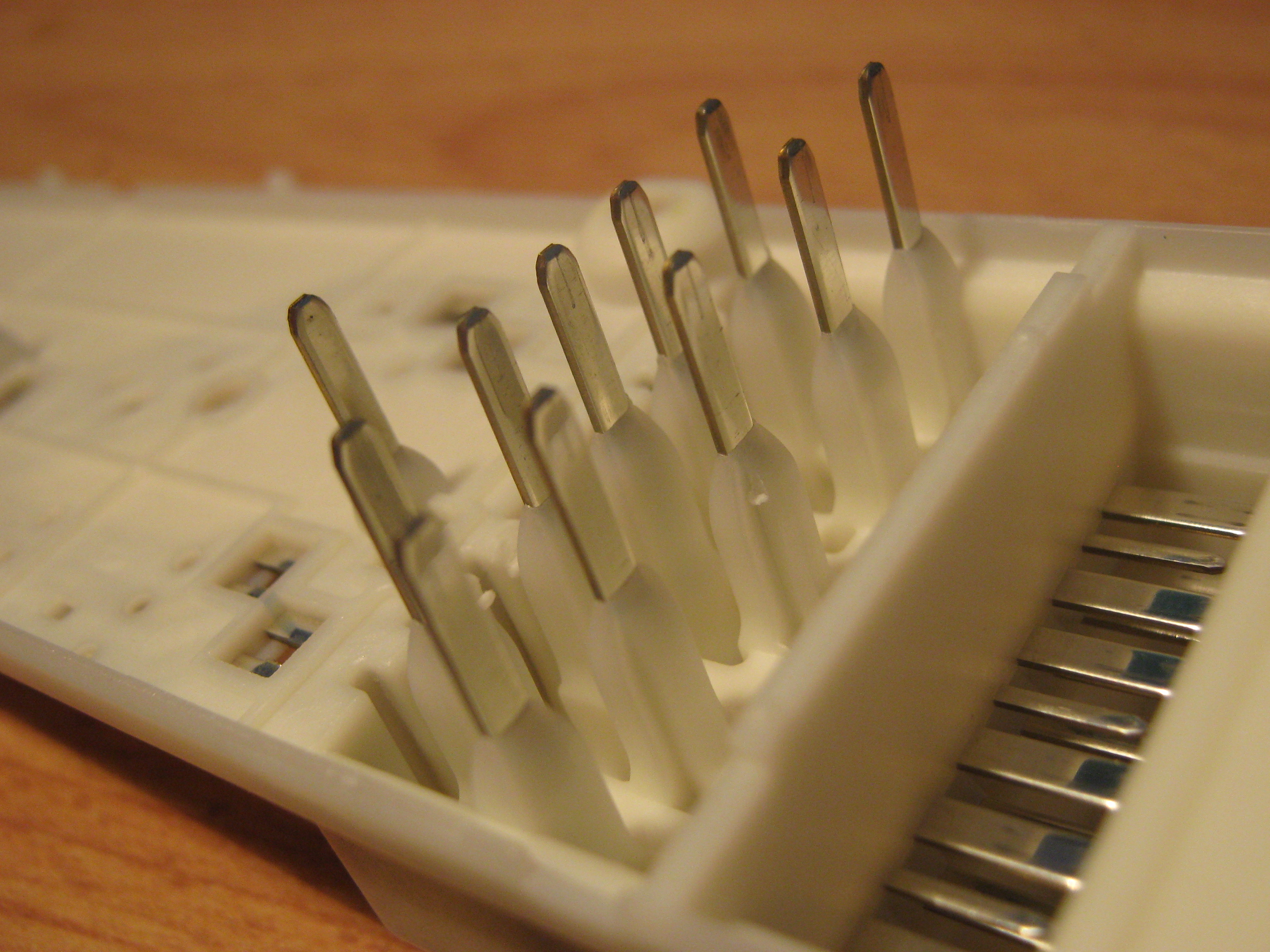

I have managed to find some time to dedicate to this.
I have pulled the switch out, and dismantled it so far, however i am not sure where to go from here. And I can not see and where there is dirty or blackened contacts.
I am starting to think this is not where the problem lies.
Doesn't look anything like mine.. Looks like the hardware has changed.. Was the unit taken from the driver's side door armrest??
Yes, mine is a late 2004 V6 Sportivo. It is the one with clear tail lights. I have heard some call it Gen 5.5, or even a face lift 2004.
The window is now not working at all, well it stopped working during the week. I took the control panel out and could not see where it could be dirty, it looks like brand new. I gave it a spray with contact cleaner and put it back together. still no go. I suspect it must be the motor, as I can hear the relay clicking when I press the button to the non-auto position.
