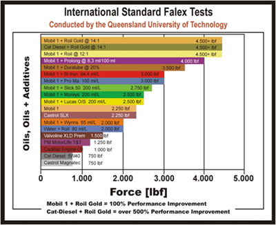

My mechanic told me this knocking on start up is usually caused by the engine turning over while the oil has not started lubricating yet( as the engine stops, so does the oil pump, over time the oil film begins to settle, as the oil pump needs the engine running it becomes a catch 22 situation, you need lubrication to start the engine but to get it you must start the engine...I hope this makes sense...it took me a little while to get it but I have a patient mechanic)
Therefor the most damage to an engine occurs in the first few seconds after each cold start.
Another source of "Knocking" is condensation. As the engine cools , condensation forms and "thins " the oil. (that can also contribute to difficult starts)
He recommended "ROIL Gold" (back than) now ROIL Platinum (here is some info on U-tube)
http://www.youtube.com/watch?v=ZiB5fh7PztA
I noticed several things
1) no more knocking
2) smoother engine running (it also runs a bit "cooler")
3) more power (it feels more responsive)
4) about 10-15% less fuel conumtion (have not tested it on the AURION though, my last car was a FORD)
Before I forget, he told me not to put it into the engine below 10 000km as it also hardens the metal components (less wear but stops it from running in properly, after that less wear is a good thing though)
I actually became a member as you can not purchase it from stores......
I hope this is helpful but if you feel it is out of line, feel free to get rid of it!

I know exactly what you mean with being very conservative with additives. A friend of mine stuffed his engine up by putting some "Teflon" coating stuff in there.
If you ever decide to use it let me know the difference as you have done some torque testing previously? Would be cool if you have it on paper so as to be able to compare it......yes, I am also very skeptical. (at least I used to be, now I am very happy with my decision to put it in)
I did find some independent research done by the Queensland University of Technology that may be of interest to you though
(it was based on the previous product though, the new one is considered to be even better so it is OK)
If anybody is considering using it, feel free to drop me a line and I can show you how to get your hands on it.
