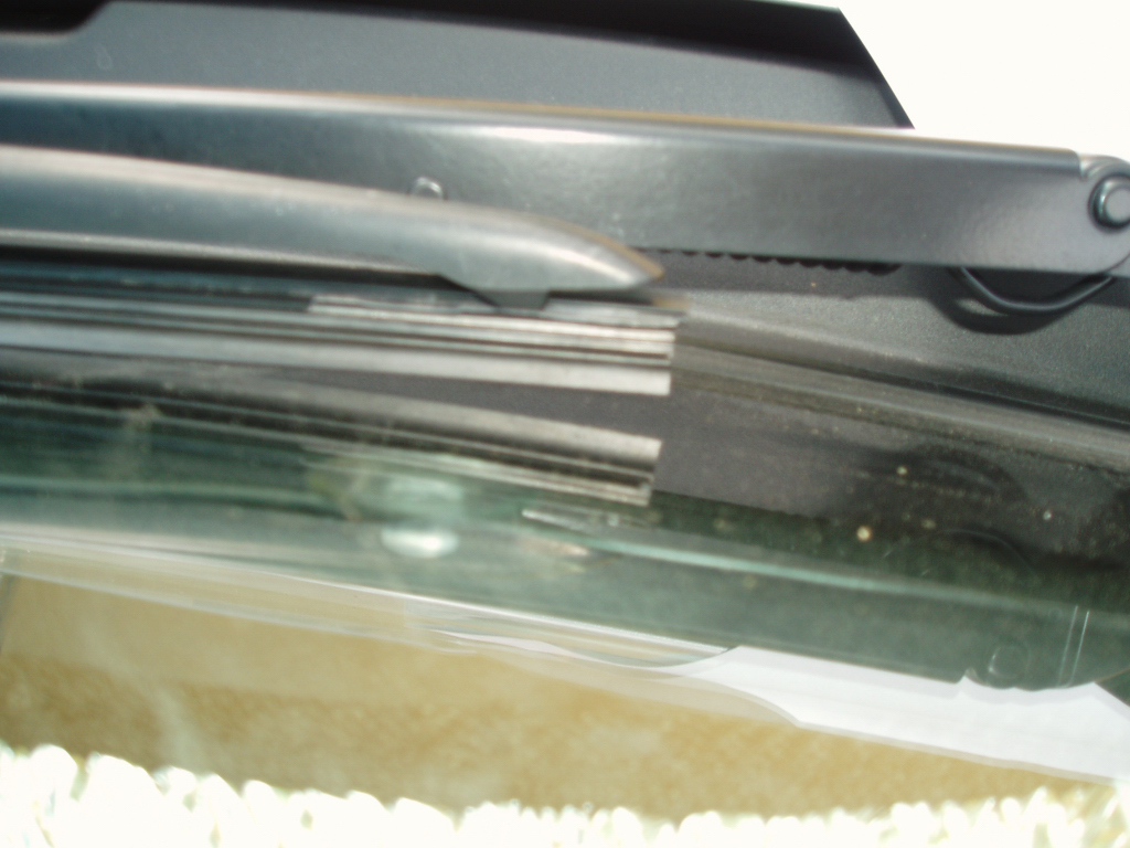

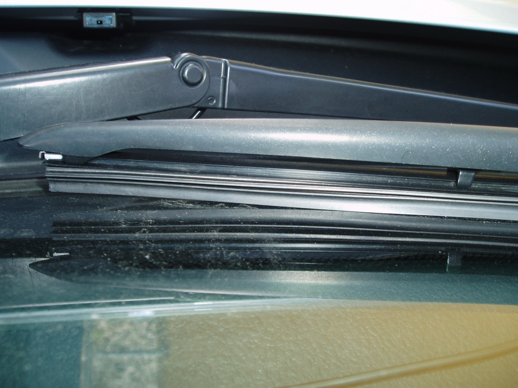

See photos below showing the ends of the wiper blades.
The blade tips are sitting above the glass by ~3mm with the gap tapering down to zero over ~50mm.
The steel clip on the replacement blade also doesn't hold it secure in the wiper arm, and the blade often comes loose.
I cut the blade to match the length of the original blade. This would explain why one end sits high but not the other.
I have the streaks at the location were the blade loses contact with the glass near the tips.
Definitely something amiss there - Mine are quite curved in comparison and are quite springy at the ends to hug the profile of the glass nicely. Is the blade is threaded through every set of guides properly along the length of the arm (especially in the middle)? With the arm off the screen, when I press on my blade in the middle it causes the ends to curve inwards.
I'll check it again in the morning but am pretty sure they run through all of the guides as the original blade was the same before I replaced it.
Can I go through any Toyota dealer for a warranty claim as I'll be getting my vehicle serviced through a different Toyota dealer from the on I purchased the vehicle through as it is more convenient for me?
Just checked, blade runs through all the guides correctly. When I push up in the middle of the blade the tips do come down. Something still isn't right so will get them replaced. Thanks all for your help :clap:
