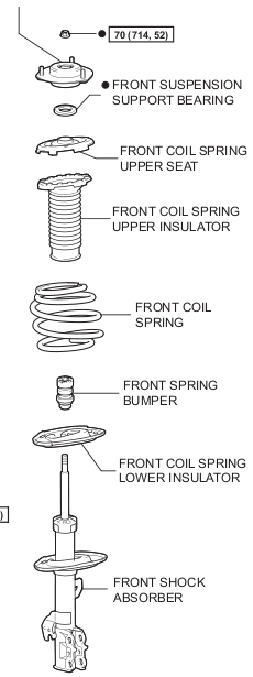

Do you know exactly what they were lubing up and what lube they used? I ran out of KY. I dont have suspension dudes because me and my brother are the suspension dudes. LOL.. having said that he is in the know about cars (mainly Holden and Ford) and I am not.
See the attached pic. I'd love if you could please point out the part(s).

Hey Jeff. I'd be thinking that they were lubricating the actual suspension bushes (like those that hold the front sway bar), rather than components of the strut itself.
The type of lube that you use for that is Lithium Grease. I'd lube all of the following to start off:

They vaselined around the shaft of the shocks. What it was doing was picking up the bump stop over speed bumps and causing a creaking noise as it was very dry. By using vaseline it wouldnt damage the bumpstop and would be asorbed easily.
If you have any questions exactly what they did ring pedders at browns plains qld and speak to allan. Ph: 07 3800 4288
He will be able to explain more in detail.
Mine was creaking every time I went over a speed hump or up a drive way. The vaseline worked a treat and fixed it straight away.

Are you referring to the bump stops?
yes bump stop rubber ....lol ...don't no why typed boot rubber maybe cause last few days I been chasing some boot spoiler lol.
