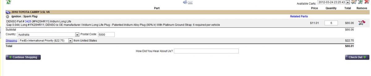

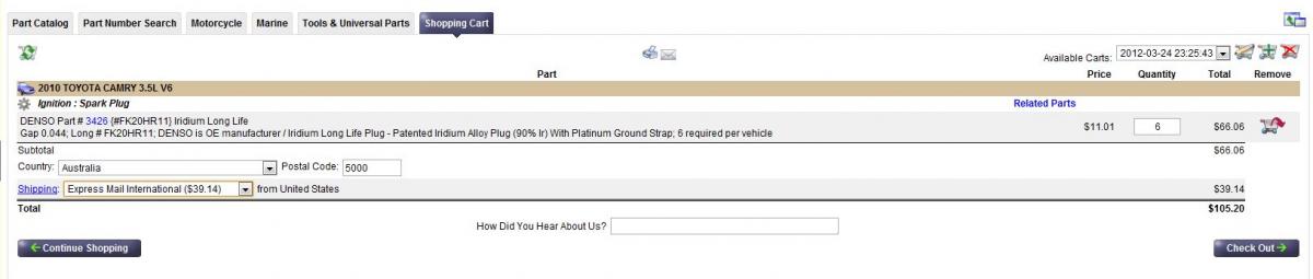

Look at these prices via RA FedX and Air express! "SET OF 6 NOT 4!"
