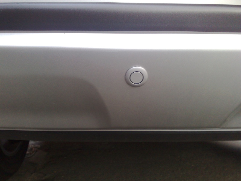

Have a strange but similar problem to yours, - checked it with the toyota service centre when I dropped in for service. The sensors in the car, are always beeping,,,- regardless whether there was anything behind or not,,,but thankfully when reversing, and approaching an object, the beeping increases. Still a pain that they beep always. The guys at the service centre tell me it could be either a sensitivity setting for them, or that simply the sensors are pointing to the road, and not horizontal (at a 90degree angle to it), so as to detect the vehicle behind. See attached photo. Service centre tells me there could be a piece of plastic (fitting) to add to the sensor to adjust them, pointing straight horizontal...
