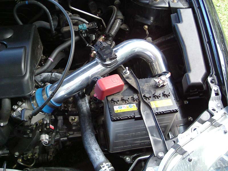

Well fellas its come to this..... i've just been driving all day... :P did about 200k's today. hehe
simota is installed with the K&N extreme filter $220 :D
fitting cost me $50 through autobarn, it was easy, and bout the second mounting bracket we had to mount it ourself with a diffferent screw. its nice and snugg now. everything is going great.

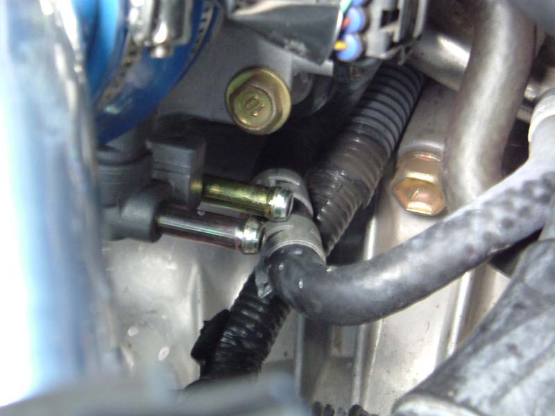

Also while i was there doing the CAI i also managed to buy a hose joiner for $5 and i also did the coolant bypass at the sametime. very easy mod.. i'm very surprised how it easy it was.
heres a pic of CAI

ok coolant runs through throttle body. the design is to prevent throttle body from freezing up. there are 2 hoses that runs through throttle body. 1 is entry 1 is exit. pull both hoses out and join together. therefore bypassing throttle body.
there is no need for throttle to be heated up as our climate aren't freezing temperatures. where i'm from... Cairns qld definately not. unless you have snow then i would reccomend doing this mod. Less heat is always good.
