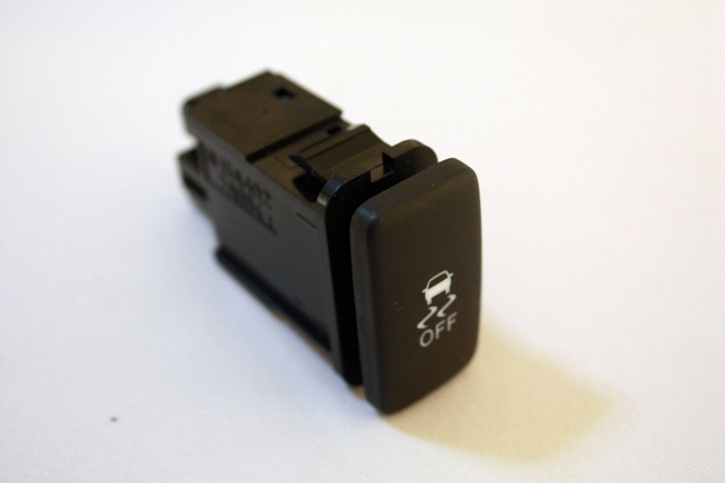

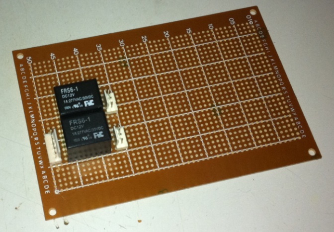

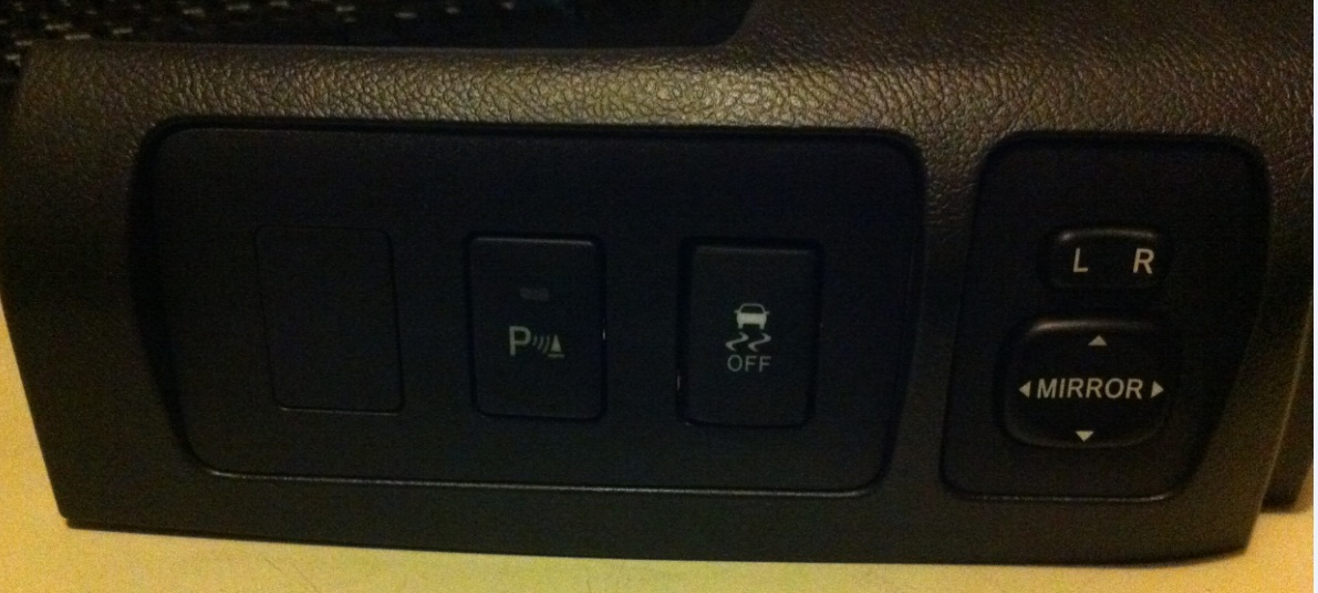

Started my PCB, only things on it so far are the DPDT relays and the wiring connectors for power and sensors. Can't design any further until I get my switch in the mail and see whether it's a momentary or toggle switch. Pics of both my PCB and the switch-to-be attached.

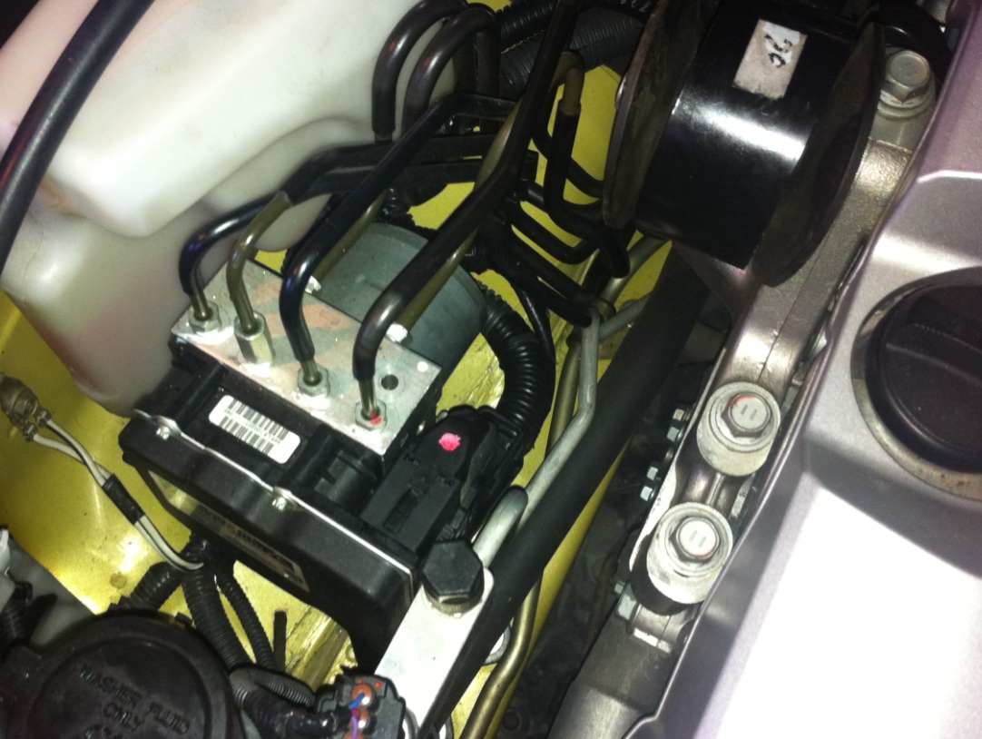

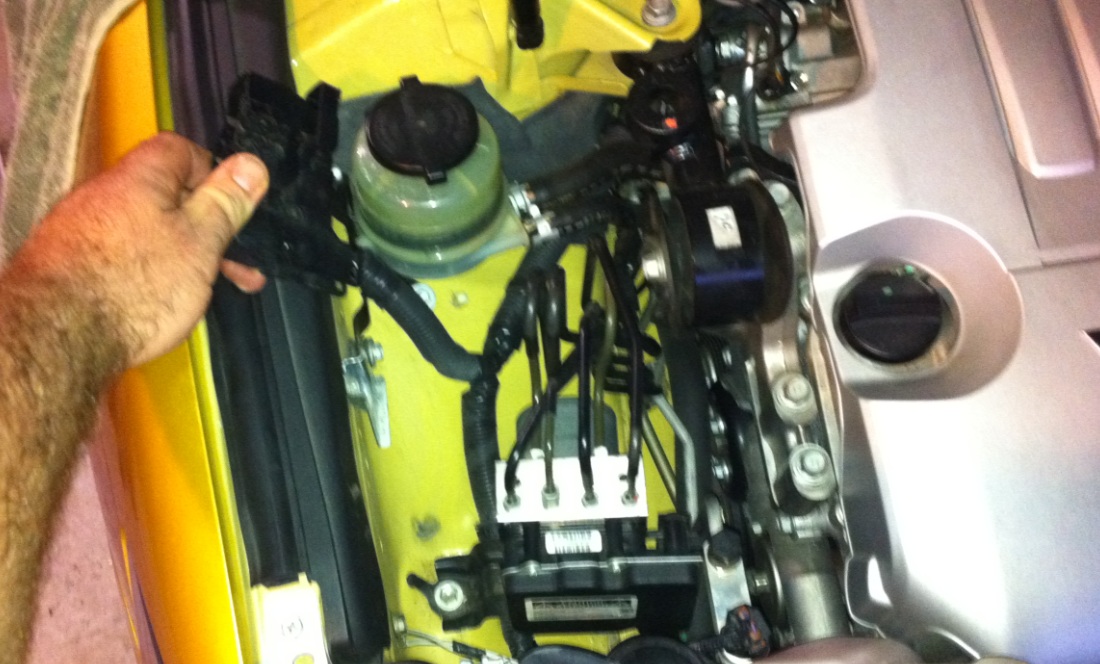

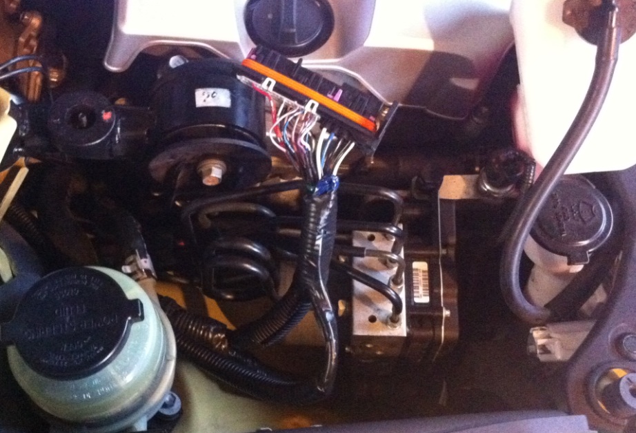

Also Daryl did you try removing the overflow bottle to give yourself more room to access the harness? I popped mine off and fed the plug underneath the brake lines and I figure I have plenty of loom to play with and be sure the connections are solid.
Sure did mate. Worked on it in the same position you have there. It helped, but definitely not enough... well for me anyways to call it 'confident'. I think the fact that all the wires are bunched close together and they are partially twisted is what makes it difficult in the given space.
Man, thanks for thinking I was that great for working with it on the engine side of the actuator. If anyone could do that there, I would give them a beer.

Wired mine up at the engine end this morning and ran the harness through the firewall so it's ready for when I my switch turns up. Used some automotive wiring tubing I had lying around to keep everything looking fairly stock, think it worked out well you wouldn't even know it had been touched unless you knew exactly what to look for.
All connections are soldered, heat-shrinked and for good measure wrapped in electrical tape before going in the tubing. Pretty sure it will hold up over time.

Relay 1 and Relay 2 are any odd DPDT relay. I'm using these ones to be exact.
I opted for those because even though it's well above the rating I need, I like to be on that side of things. Personally, you can replace the function of Relay 1 & 2 with a single 4PDT relay such as this one.
Relay 3 is just any odd SPST relay. I am using a micro 12V 10A relay for that one.
I assume you're switching from Relay 1 to Relay 2?
Relay 1 and 2 are switched at the same time as per the diagram. One DPDT relay does the speed sensor switch for one side only. You can combine both sides into the one relay by using a 4PDT relay as mentioned above.

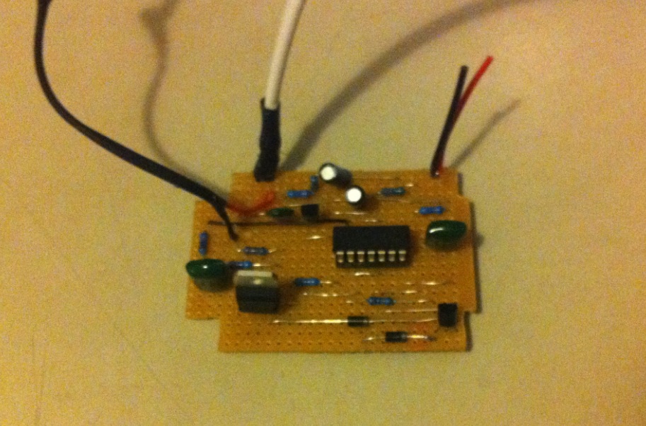

Just some teaser shots of my progress so far.
PCB is currently under construction, made all the more complicated due to the TCS switch being a momentary design rather than On/Off (and as is typical, every time I go to Jaycar for parts I always forget 1 or 2 critical components)

The circuit I've put together so that I can use a momentary switch.
After seeing that, I think I'll definitely stick with the circuit we discussed yesterday.
Also, since I am really bored here, I guess I'll work on the electrical diagram so I can make a proper post about this.
