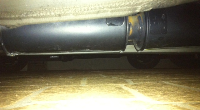

I have 2 x 7" x 11" cylinder mid resonators. Quiet at idle and medium loud & very deep sounding when I give it. now I scrape so bad over driveways & ramps it's not funny, I'm talking about crunching the resi's ppl turn and look even tho my car isn't that low the resonators r. I have a straight through magnaflow rear muffler and need a middle resonator that will not sit so low due to the large diameter ( my current have been lifted too) but I'd like to keep the sound and performance the way it is. I'm told my my exhaust guy this is hard to do. Straight through everything is best for performance and enough packing in the resonators is crucial to the sound. What r u using??

R these the hotdog type glasspack resi's? mine are shaped like a cylinder with a lip, it comes down alot more than urs and is the reason i scrape ( badly, with no exaggeration) I like the sound I get it's quiet but deep tough sounding I wouldn't mind it to be louder but I want to keep deepness more than anything, where did u get urs done at?
not sure what are packed inside these hot dogs but when i looked inside, the design was very much like the magnaflow ones. they allow sound baffling with no hinderance of flow whatsoever. i was looking just getting rid of the farting noise. i can control how loud it is with the varex. i further raised my car also and i've told the guy to tuck it up as much as he could. i got it done here in melbourne. any DECENT exhaust place should be able to tuck it up as much as possible. if they have tucked it up as much as possible the only other thing u have to do is raise ur car abit.
yeah but i think u can get ones with a steel mesh instead of fibreglass, but yeah for me i dnt have a varex just the straight thru s/s magnaflow rear oval muffler, its tucked up to the maximum and abit reluctant to raise the car as it is not stupid low and will look 4x4 styles lol. wondering if there are straigh thru oval resonators that will keep it deep, maybe 2 x small ones or 1x long one. the pictures attached is what i currently have installed.

No not a varex muffler. Also Just wondering if a 14" rear oval muffler is what u guys would use? yeah they look abit much and are big, the thing I like about them is just the no fart sound at any rev ranges a very deep sound yet quiet. I do want it abit louder and more aggressive but would like to retain the deepness and the performance (straight thru 2.5" everything I have found is best 4 performance) maybe a 5" x14" round resonator instead of this 7" x 12" round with lip would do the trick.

u see mine on the top? its not as big as yours. the sound is nice. no fart and is tucked up quite nicely. u want sound, u have to release more back pressure. that means using a smaller hot dog but not too small as it will not do much to quell the fart noise
Maybe get 2 smaller hotdog resonators that are abit smaller profile?
i had twin hotdogs welded into a straightline pipe, not muffler, sounds fine, tucked well and had the clearance i was after.
