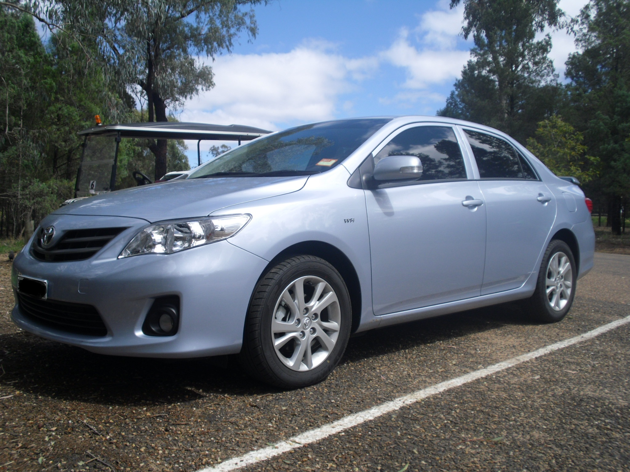

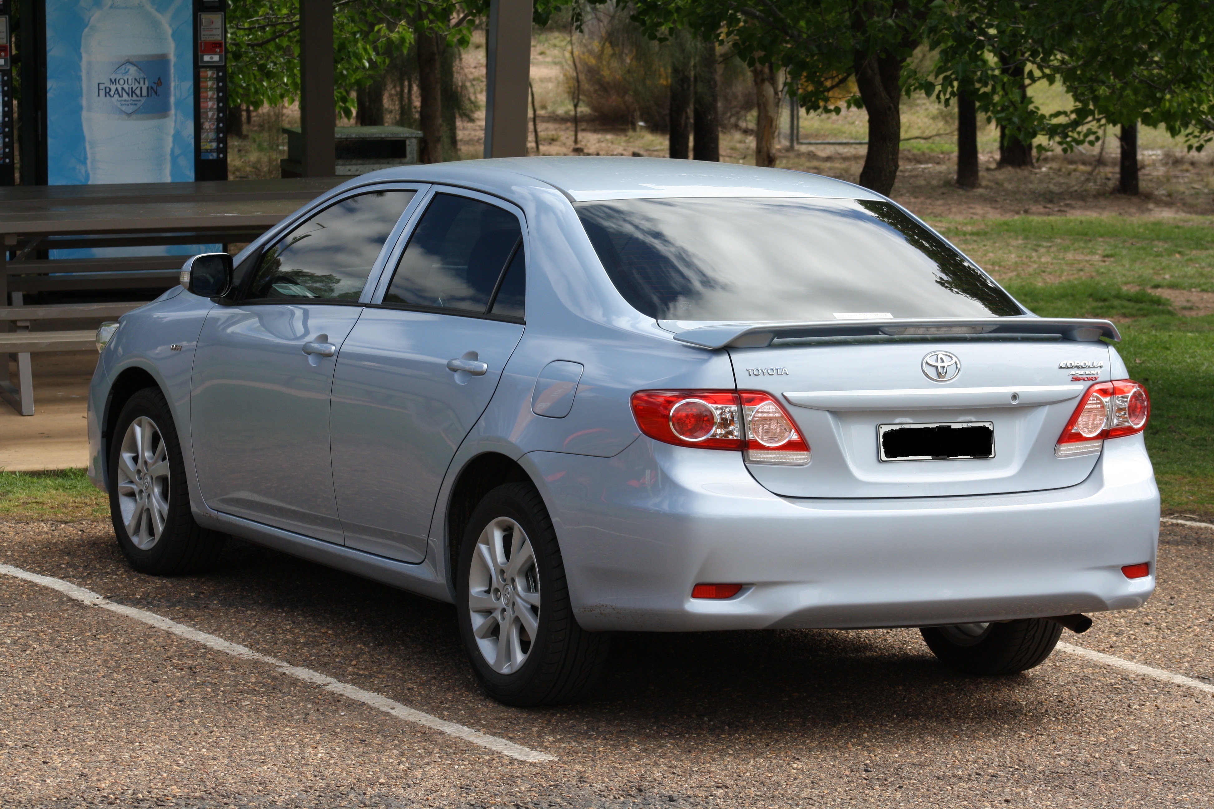

if it helps, here are pics of my stock rolla... and the 'shimmer' color.. lolz
edit: how do you make the photos smaller? XD
post-25625-0-89960000-1317203502_thumb.j
post-25625-0-57673000-1317203618_thumb.j
Edited by Schy
Like this? :P
yep! that's the color and yep how did you make the photo smaller? hahaha!
