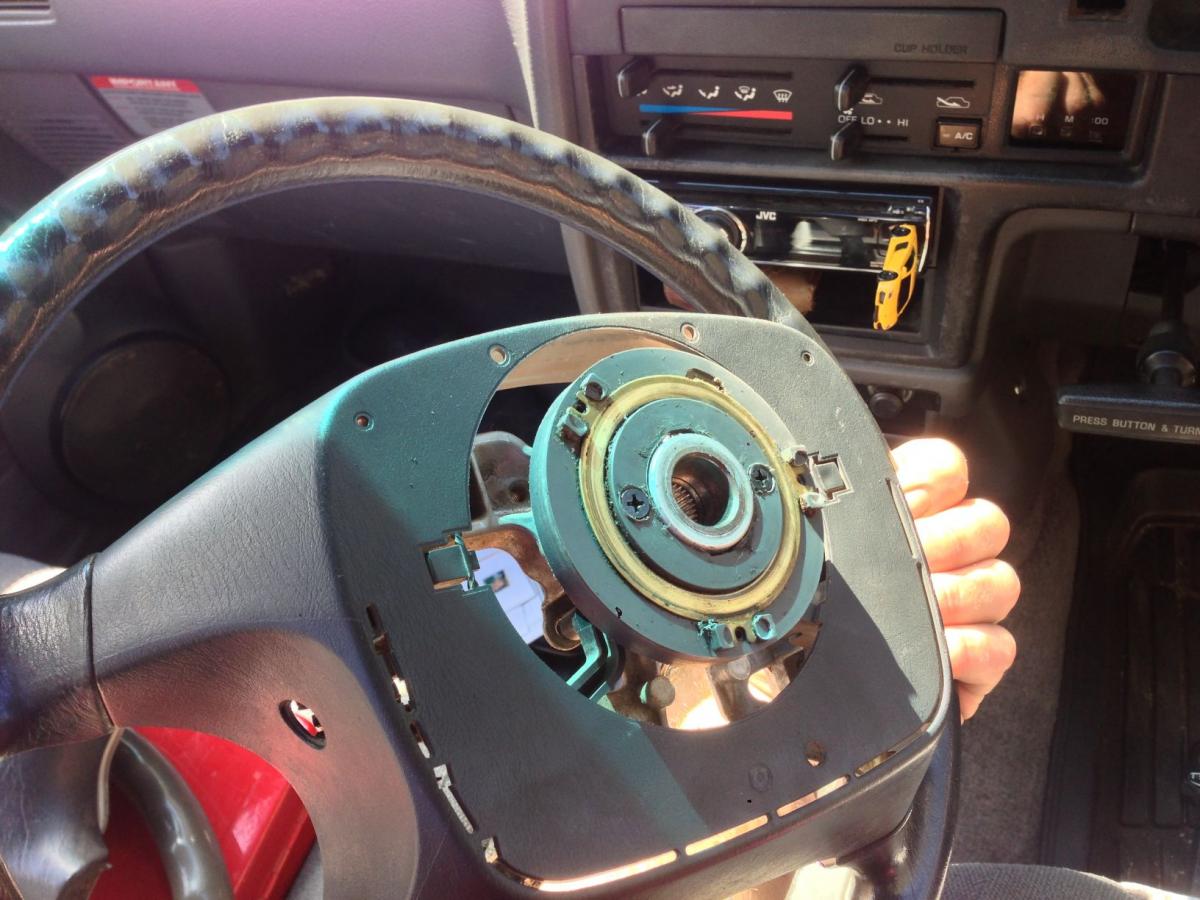

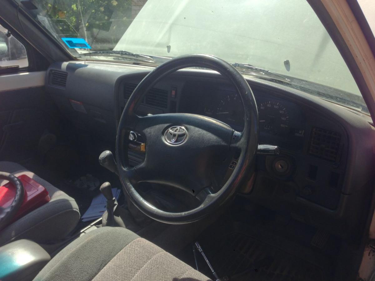

05 Hilux airbag steering wheel into a much older Hilux, before clocksprings etc.
Airbag ignitor is removed, and horn contact ring from old steering wheel mounted behind new one.
Fiddly as hell but does sorta show it's possible to mount a newer Toyota steering wheel onto a much older Toyota.
post-13080-0-25688900-1440243300_thumb.j
post-13080-0-33582100-1440243350_thumb.j
Nice^^! Any other tips you have in doing this? Obviously might be a bit different between vehicles but it all helps!
Thanks
obviously every vehicle wheel swap is different so you can only work with what you've got.
By the above I meant to show that even some older swaps were possible without too much drama, but at the end of the day it's all down to the individual cars
