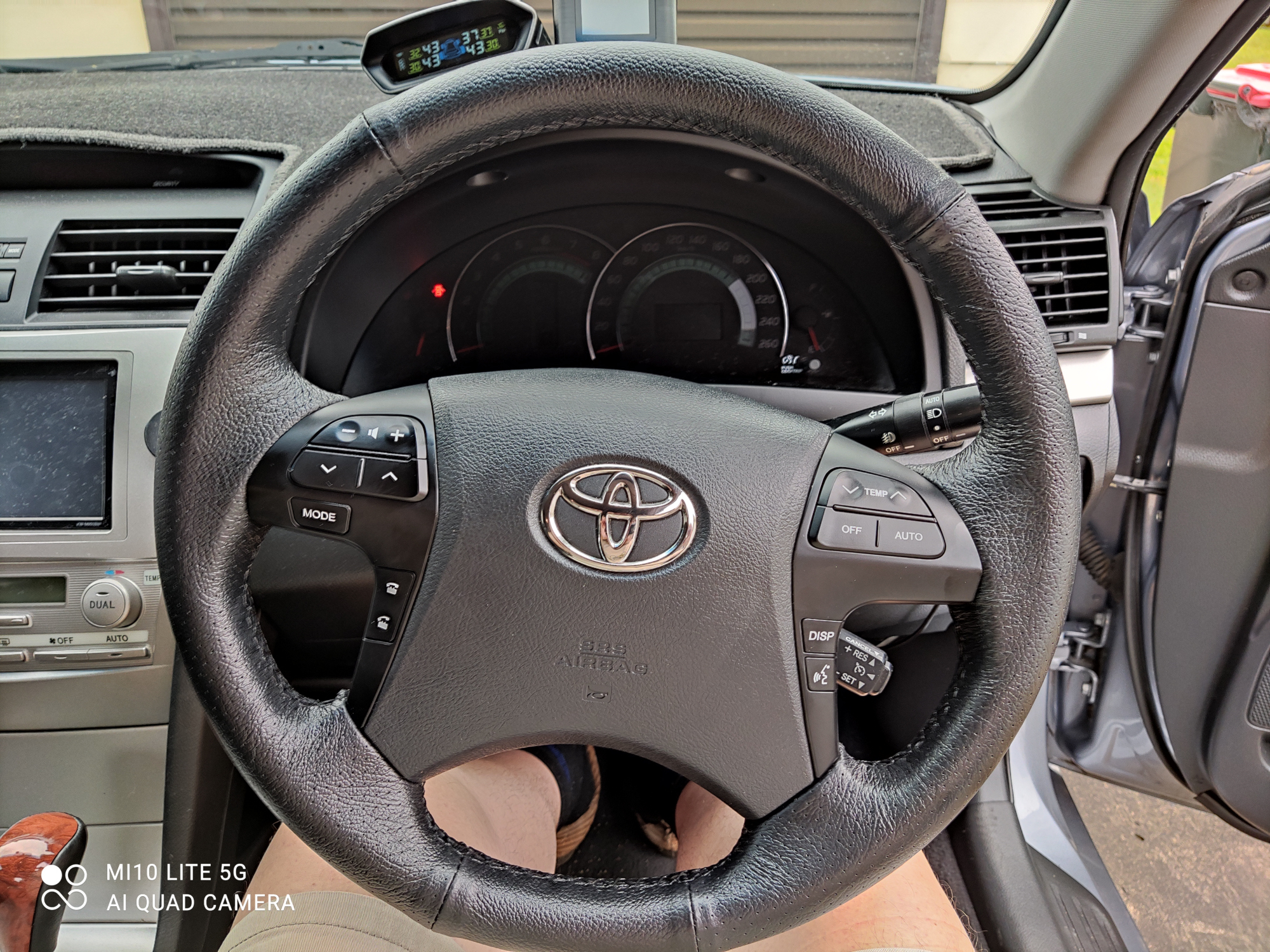

I've just upgraded my steering wheel in my May 2009 Aurion AT-X. See picture attached.
Now the stereo controls on the left work with my headunit, apart from the phone buttons. On the right however, no buttons work (AC and DISP), apart from the Mic button, which starts Google on my headunit. The controls were bought off AliExpress.
Is there any way to get the AC controls and the DISP button to work? I have dual zone AC installed from the factory in my Aurion.
Any advice appreciated.
Aircon wiring shouldn't be there for an atx so it won't work. The display button will work once u ground a wire that goes into ur head unit from the factory harness, pink wire

@Metal_Head This afternoon my mate and I had a go at grounding all the pink wires we could find. No luck. My DISP button was working with my old steering wheel and controls. It could be that the DISP button happens to be faulty on my new controls from AliExpress. I have managed to find a wiring diagram in these forums and will have another look tomorrow.
Wiring diagram from here -
