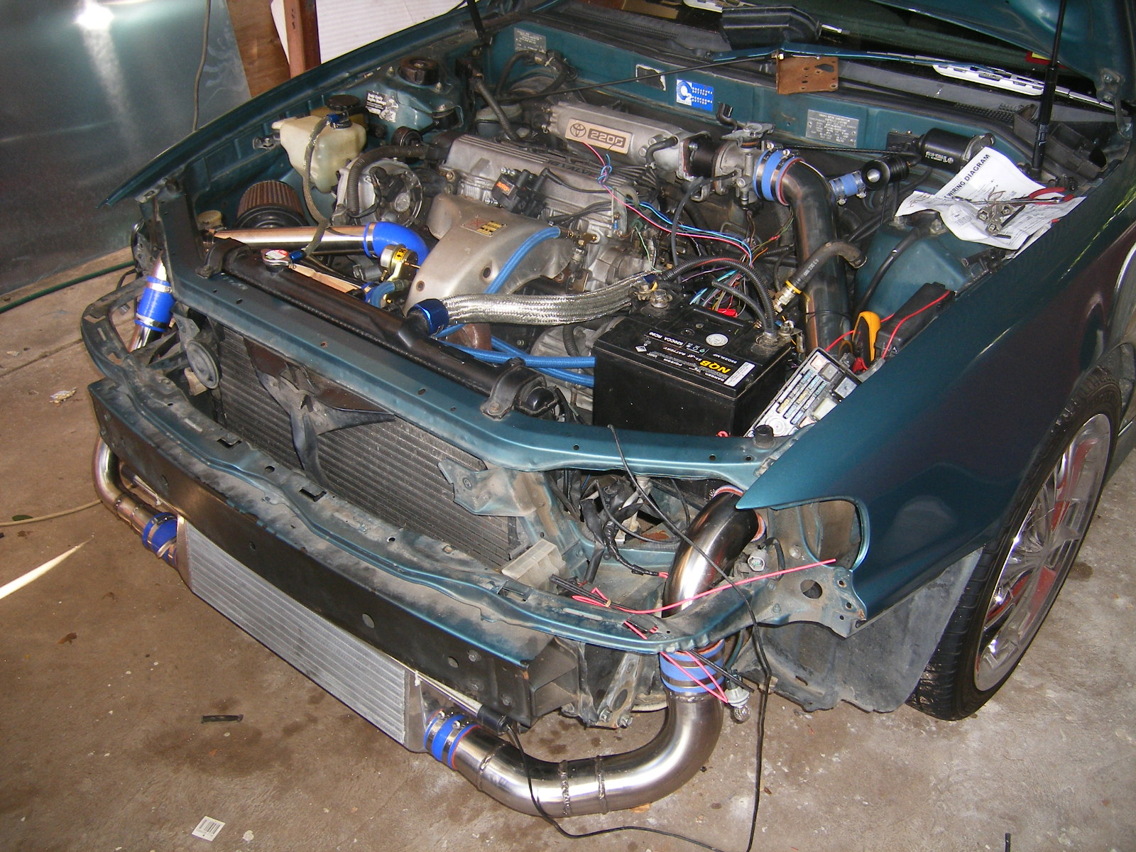

So I thought that I would come on and show you all my ride. She is a 1993 Camry I have had it now for 3 years, taken me all 3 to get her where she is at today, and still counting!
I don't know where to start with my car, so many things have been done to her, I will do my best in tell you all!
Ext mods

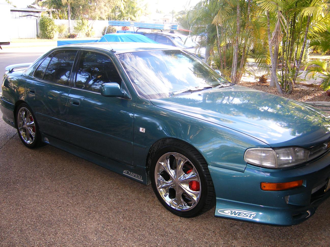

Bodykit - Bought from Sydney and posted to my house, fitted and painted by myself
Mags - 18" XHP, kinda not the biggest fan of this design, but they still look nice when the car is on a roll
Int mods/stuff
4" speco tacho
2" boost guage
Kenwood single din dvd screen and player
custom seats - they were pulled outa a CSI 95 and re-done to my liking, the rear is yet to be done....
Sound gear!
Car is all JBL front to back
4" splits in front dors
6x9 in parcil tray
1 speaker amp in boot
1 mono block in boot
2x15" subs in boot
custom install with UV neon lighting and pirspex < yet to be finished.

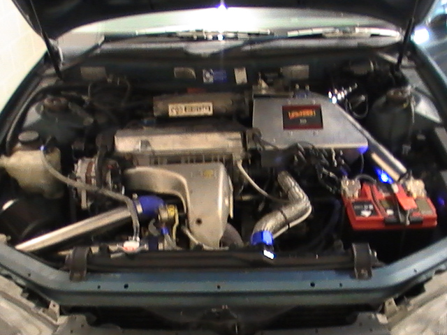

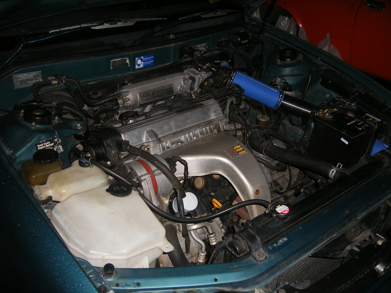

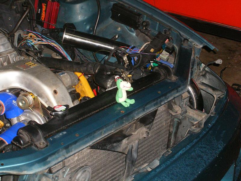

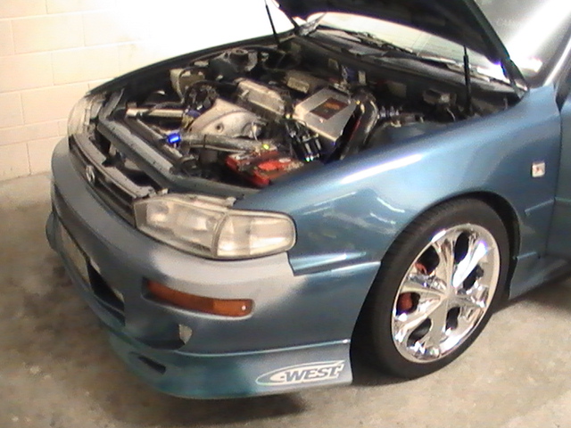

Engine!!!

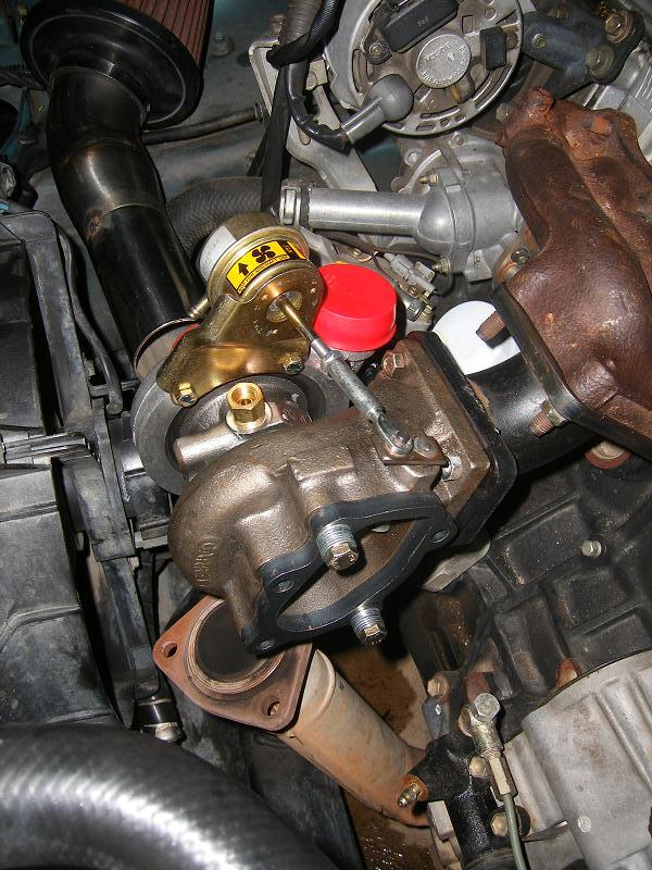

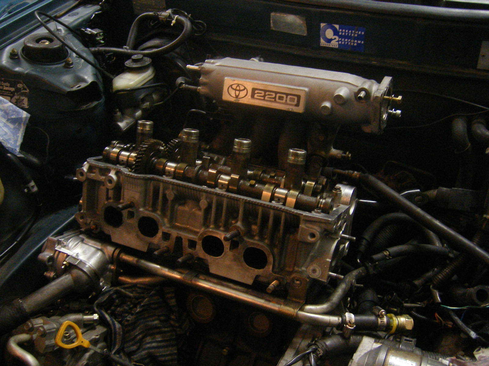

recon 5SFE

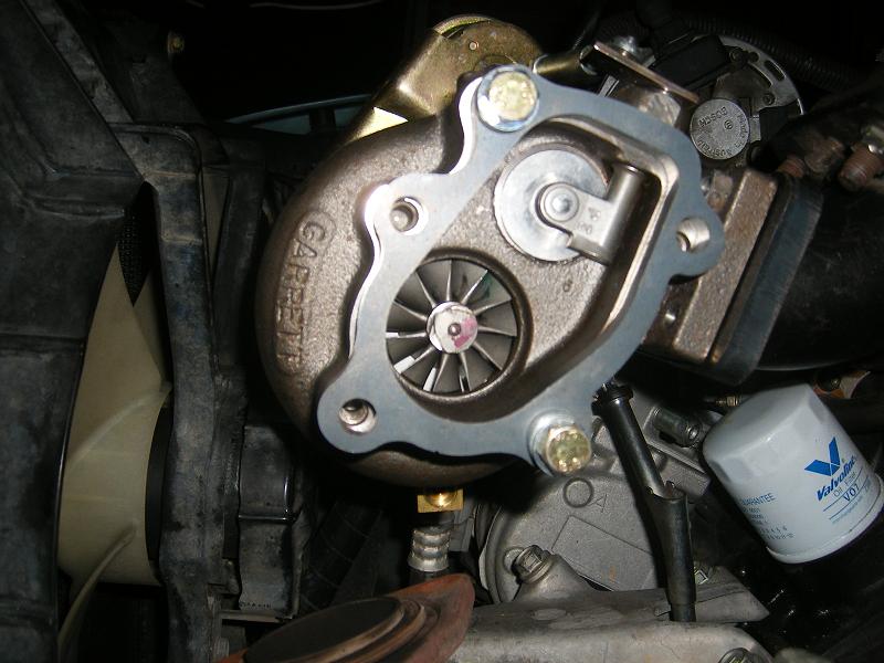

Garrett GT25 turbo

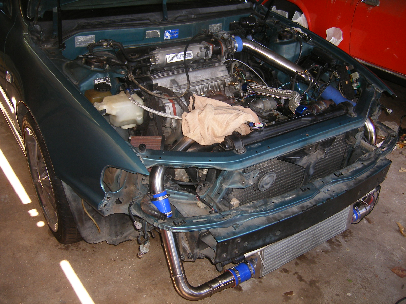

GT4 manifold
2.5" exhaust with hi-flo cat and TRR muffler with dual inlet and outlet

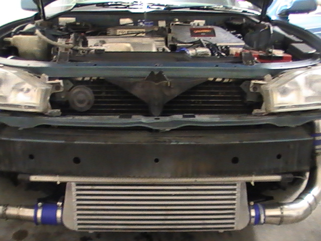

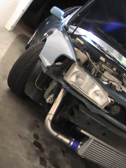

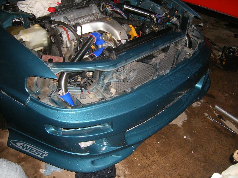

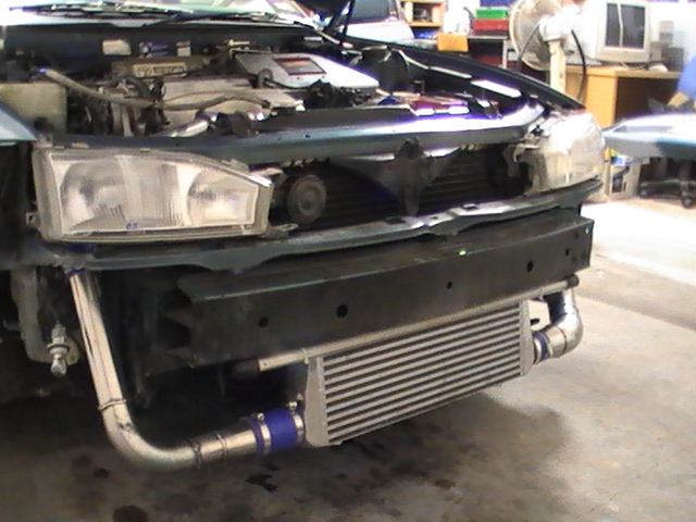

Custom intercooler install with piping to suit
Haltech E6X
AutoMeter Tach Adapter thanks to Rocket Industries B) "Big Thanks guys!!!"
Turbosmart stage 1 BOV

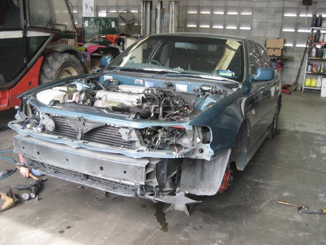

I am currently respraying my front bar was in a little bit of a tiff with me and a gutter! "Gutter - 1 / Camry 0"
PICS!
They all all random ones all attached, enjoy!

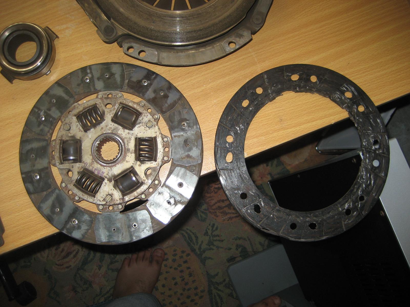

Pictures I have got is just off the car, my clutch plate thats in 2 bits yes thats a good one to see haha!
Now its up to you! Please I like hearing what other camry owners think, please remember I have spent alot of time, and love on my car so no flaming please!!! If you don't like something and you think its just wrong keep it to yourself. You have no idea how much abuse I get in my car where I live!!!!!!!!
People are not use to change and seeing a turbo camry, argh it just annoying when people can not accept what I have done. But ask me questions about anything, this car has been my life!

Bodykit came from Sydney from carmate.com

KRS71N - Did not much choice with the mags. they are an XHP 18" I have learned to love them costing $1800! hahah :(

Dyno - 101kw
- 410nm torque
1/4 mile time will be done as soon as I get my license back LOL 3 month suspension.
Engine:
STD 5SFE. Trying to get any race/forged parts for this engine is near impossible! But I got a set of 440bosch injectors on their way, and then another dyno after that, the STD 240cc injectors are maxxxing out at 5200RPM making their 100% duty cycle, RPM limmit is set to 4800RPM.
Thanks all keep the questions commin :D

Full boost which is 6.5 at 2500RPM holds out to 5200
It is not much boost, but for a standard engine I don't want to push it, told it can handle 10 to 11psi maxx. injectors here soon then book in for another dyno tune!
