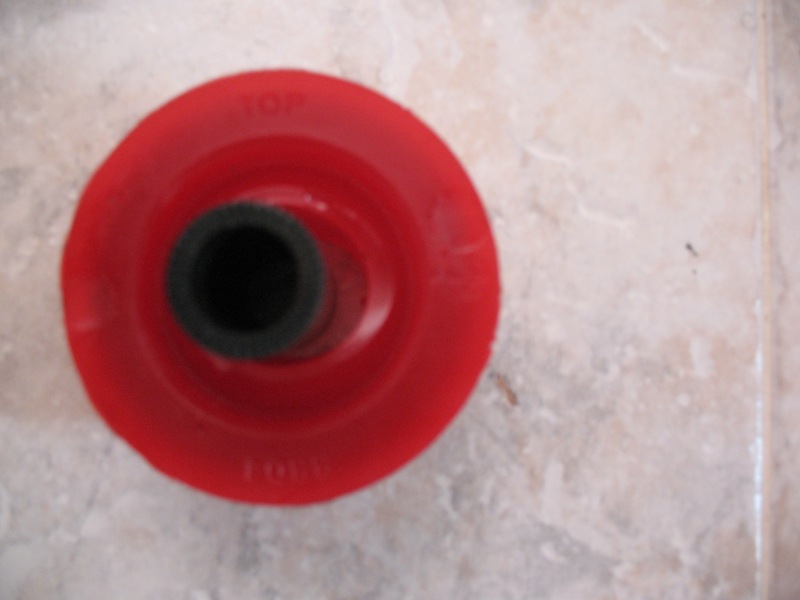

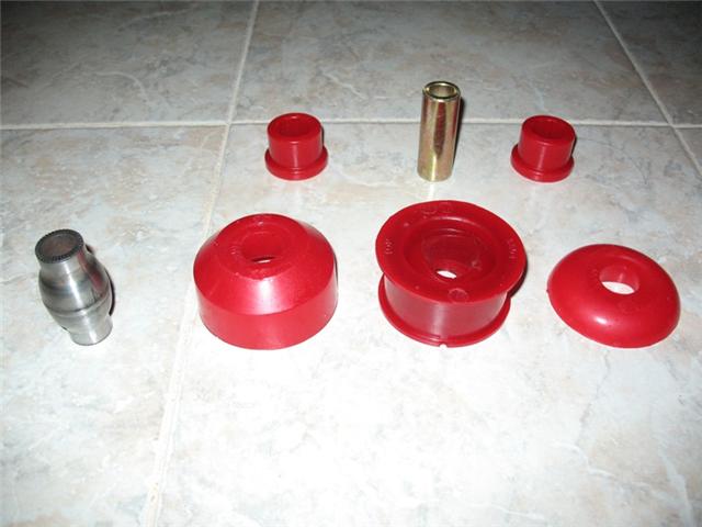

The problem that I am having is that the metal sleeve that is supposed to be re-used in the vertical bushing of the arm is straight and it does not have the oval-like bulge in the centre so when I try to put the sleeve into the Energy centre bushing 3304 (according to the instructions) it is not a snug fit and it has a lot of play in it (this "play" is seen to the right of the OEM sleeve in the picture below). I don't think it's supposed to be like that and I was wondering if people had similar problems and if they did, what was done to overcome such problems.
Just for the record, I had bought a RH control arm so that I could retrofit it without having any major downtime with my car and let me just say, it's a good thing I went this route if not I'd be in some serious trouble.
Looking forward to any positive responses

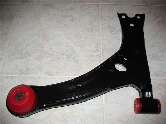

I was able to find some OEM “oval” sleeves from an old control arm that was on a vehicle and I’ve posted a picture of the Energy Suspension front control arm kit w/ the OEM sleeve since there was not much information on this kit’s installation on the Internet.
Additionally, I’ve also shown a picture of the bushings assembled onto the RH control arm. I have to purchase the LH control arm and install those bushings and when I’m completed the bushing installation, the installation of these arms on my car will be a swap with the OEM ones that are currently installed.
