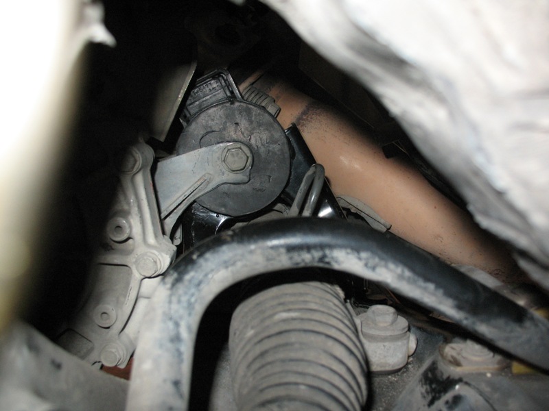

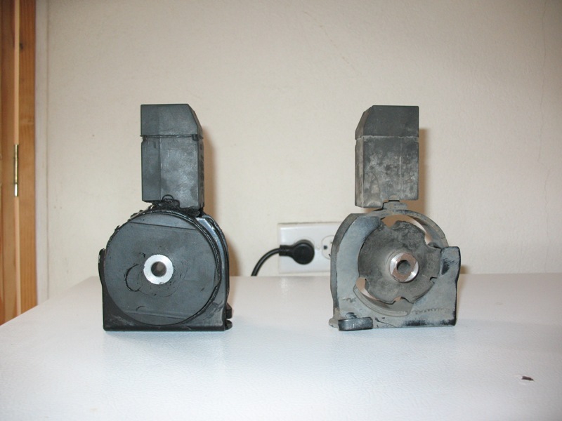

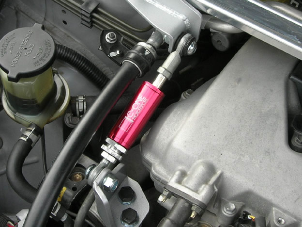

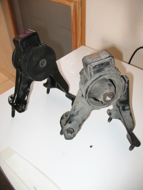

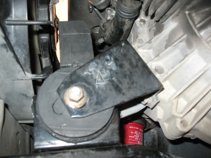

I installed the C-ONE engine mounts on my ZZE123 Corolla over the weekend and I have noticed a marked improvement in throttle response as well as an improvement in traction during corner acceleration. In addition, I do not have to worry about inserts “popping out” as has been the case with owners who have used the Energy Suspension motor mount inserts.
The downsides are that there has been an increase in in-car vibrations at idle and between 3000 – 4000 rpm, but these vibrations are quite “liveable”. I have attached a few pictures of the mounts for everyone’s’ benefit.
