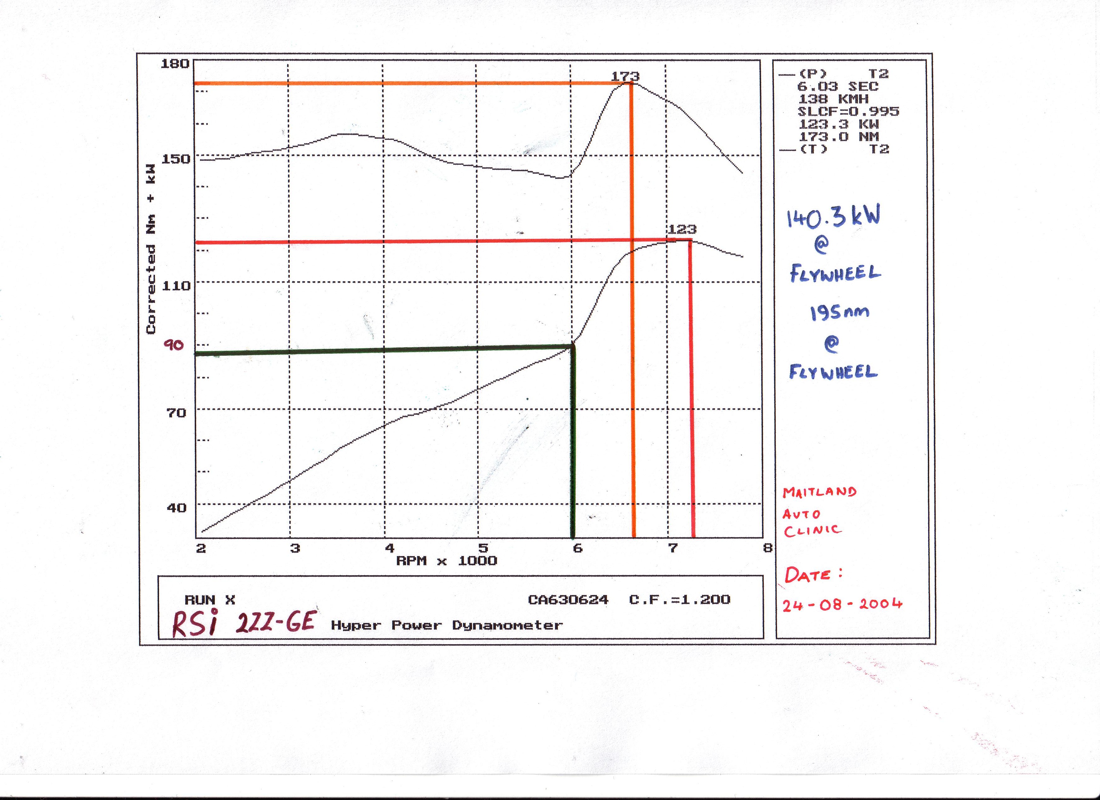

Here's Takumi's Dyno ... :D

Are you guys talking about power at the wheels or the flywheel. Cause if you're talking about power at the wheels then I want one. I wouldn't be complaining about 122 or 126kw at the wheels and neither would anybody in Australia who owns a Stivo. If that's the case then that's impressive if your car is relatively stock.
If you could clarify this for us that would be great. But if these figures are gospel then what is the difference between a Stivo and a Runx rsi? Would like to know.
Not sure about the dyno sheet:- hand written values and figures? I know you guys in Aus aren't too shy to give me your thoughts on this topic! :P :P

i don't mind you guys having a go at my dyno :-) I drew the lines for me to compare it to some other graphs i pulled of the net .. just to make a little worse that dyno was prior to the the ecu upgrade with a broken exhaust cat (which i think increased the power). I wanted to see what the power curve did and the torque did compared to some other guys ... i've a copy of one without the lines ...
PS we are sea level - so according to my knowledge normaly asperated cars suffer at altitude ????
