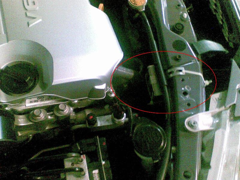

Hi, I put the balast in front of the car...Hard to tell, but I will try to take a picture tomorrow and post it here...
I put it somewhere near the front bar...
Hi VF-X
I attached the photo where I put the ballast
I don't take off the bumper to get the head lamp changed into HID
I haven't changed the parker lights though !!
Hope the attachment helps you

Have a look at Mikesalim's post, my setup is similar to his.
It may not be an ZR6, but the area is the same anyway. As for me, I installed mine as well without removing the bumper or lights. I simply did not want to go to that extent. You can see how I mounted mine in the photos. The passenger side was mounted just underneath in front of the battery and the driver's side was mounted kind of vertically. They are held down with a bolt and the cable ties are there to secure them tightly to avoid minor vibrations creating noise.
You may also notice two relays in the first photo. I would have just simply ran them of the existing harness since the peak startup current is only for a short period and that wiring is sufficient to handle that without any long term damage, but I wasn't 100% happy. I don't want to have my HID's coming on when I flash my high beams from an 'off' state so I used the relay setup to cancel that. The first relay is triggered by the parker lights (which don't come on when you flash the high beams from an 'off' state), and the second relay is triggered by the low beams, but only when the first relay is on. That way I can flash my high beams without doing any damage to my HID's.

Well, I didn't take off the bumper...Why should I? Since the place that I put my ballast is far from the bumper site anyway..
Well, Just find a place that you think the ballast won't be affected by heat from anywhere, it should be fine.
