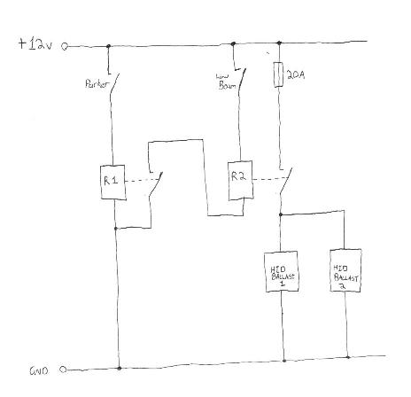

As for my wiring, I installed two relays and powered both ballasts from that. The reason why I did this is that HID's don't really like it when you flash them, and I didn't want to have the possibility of flashing them when I need to flash my high beams. I found out that when you flash the high beams when all lights are off, both the low beams and the high beams come on. Conveniently though, the parkers don't come on in this situation, so I used that to my advantage. Relay one turns on when the parkers are turned on and relay number two (which supplies power to the ballasts) only comes on when both relay number one AND the low beams are turned on. Now I can flash my high beams as much as I want without shortening the life of my HID's.
As for connecting the relays to the existing wiring loom, I did a splice and solder connection for the parker light (only on the positive rail) and the low beam one was a crimp connector and plugged straight into the socket then sealed with self sealing tape. The ground from the low beam provides the ground for both relays. That way, only one wire was messed with. I would have liked to get a male H11 connector, but that is a bit of a hard one to find. I prefer to avoid messing with the original wiring, hence why I only did a solder connection on one wire.
I've attached my sketch of my wiring setup. It's a bit messy, but it demonstrates the idea.
Edited by DJKOR
I've installed a set of HID's on my Aurion. It was one of those $70 (shipped) kits off eBay though, not a Bosch kit. I had an issue with installing the lamps as well. Because I was installing it with the headlights still in the car, I couldn't get a clear picture of what was happening, and spent many frustrated minutes trying to get the lamp to mount in the holder. It turned out that the plastic tabs that lock the lamp in the holder were sticking out too far to the sides so I used some snips and trimmed them. Can't complain though; for a $70 kit, they are pretty good. It doesn't bother me if the lamps don't last as long as an expensive kit. From experience though, those cheap kits are quite durable.

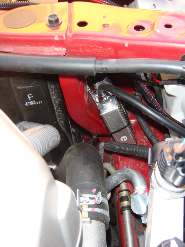

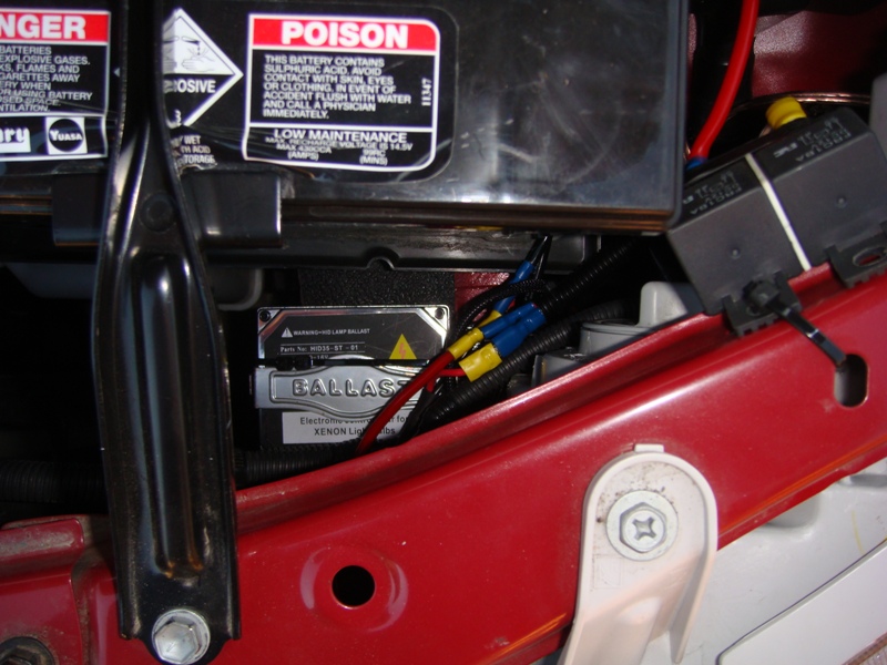

Mounting the ballasts were the fun part. The install took me 1.5 hours because I spent 1 hour trying to find the neatest spot to mount the ballasts. I couldn't really figure anything out that would be the most ideal (without removing the bumper), so I mounted one below and in front of the battery, and the other... well the picture will show. They are held down with a bolt, and I put a cable tie around it to keep 100% secure.
That's good place to put those ballasts in.
Here are pictures of where I put the ballasts in and I am now worried of one of the ballasts position which is infront of engine hose and under the coolant hose.
Wouldn't that place be too hot to put the ballast in?
Any possibilities of disorder because of high temperature?
