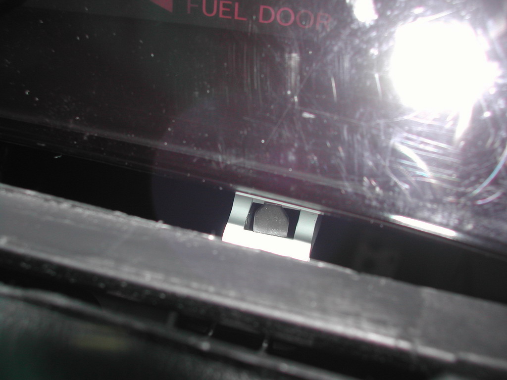

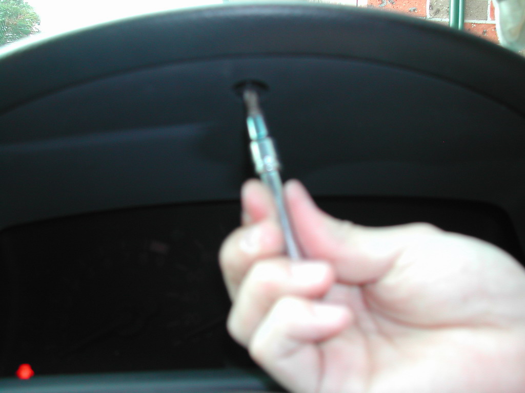

Unscrew the screw on top, then pull the plastic bits out.
Unscrew the screw on the top then un-do the two clips at the bottom

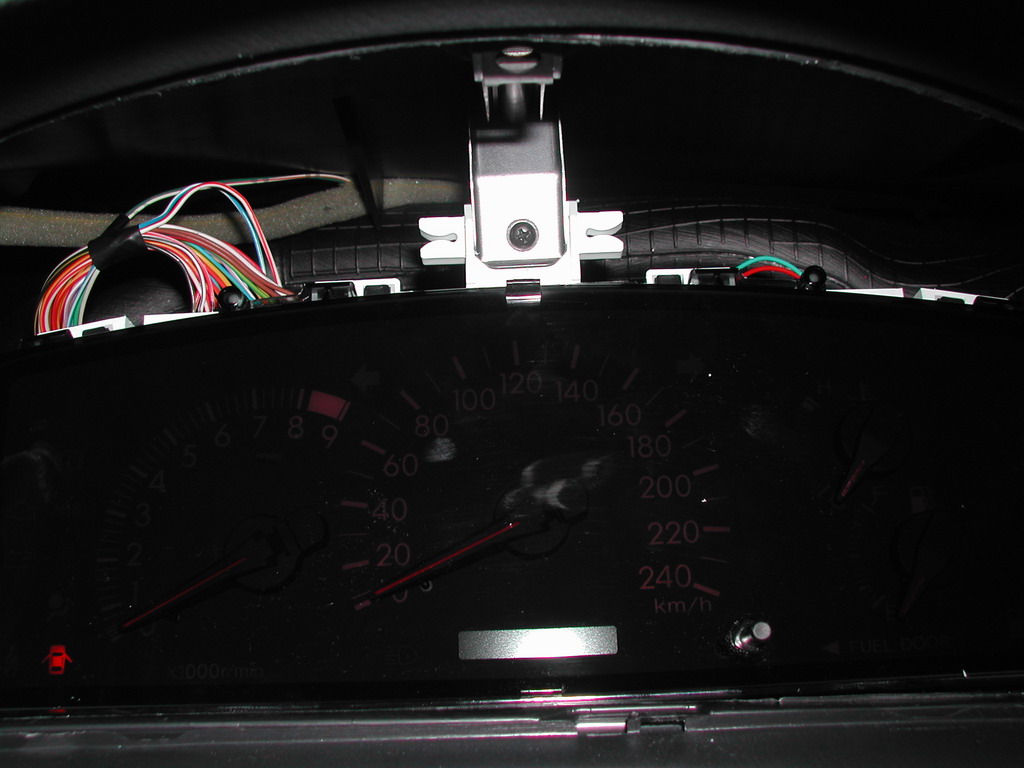

remove the two harnesses connected to the top of the panel.

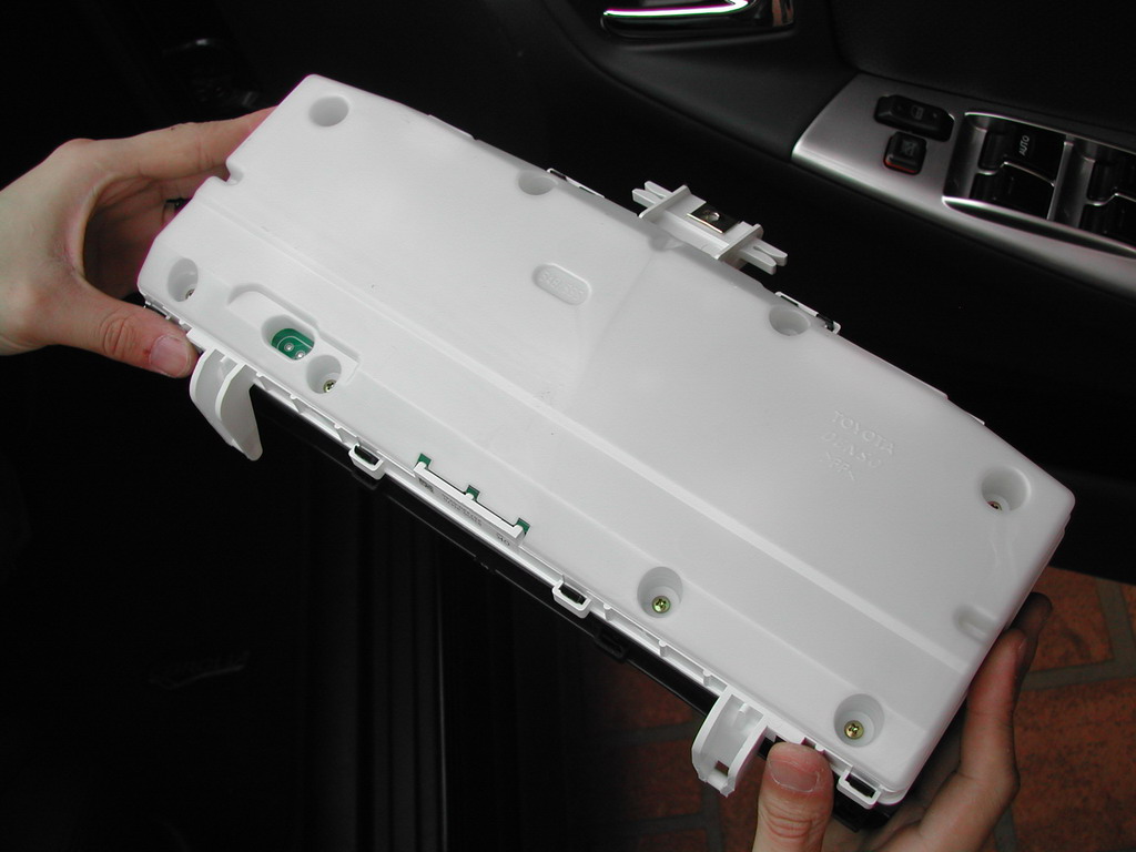

Then carefully take the panel out.
The clips look like this and are on both left and right side

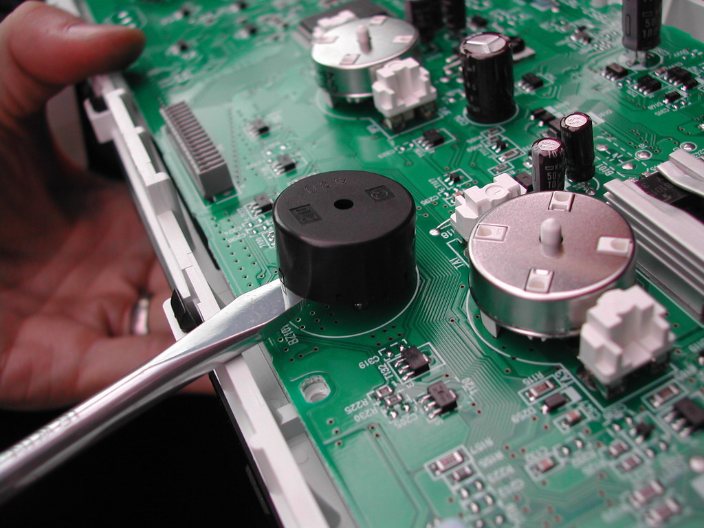

Un-do the screws to remove the white lid, then you will see the PCB inside
The Buzzer looks like this and is situated by the edge of the PCB, use a flat screw driver and reach under it, lightly lift it, and you'll see the buzzer lifts up easily.
Edited by KT_haha
it's all gone, the actual buzzer was removed, so now there's no beeping for reverse, key-in and light-on.
