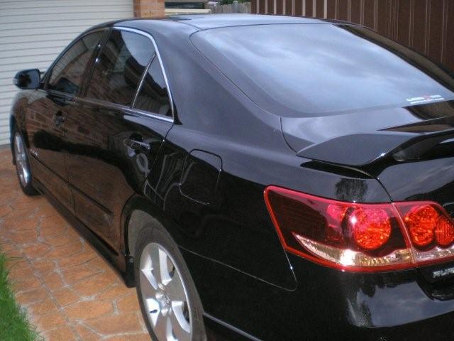

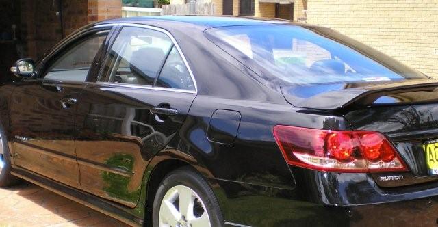

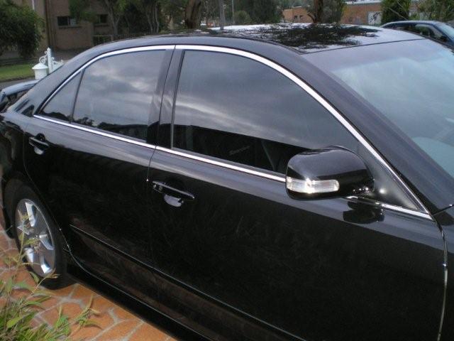

Thanks, I dropped tyre pressure to 36 feels much better not so light. happy with tint looks ok,rear window very hazy supposed to get better after a week, hope so. also noticed a scratch must of slipped when cutting, it buffed out ok so no big deal.
before and after shots.
[attpost-12242-1235308306_thumb.jpgachment=8255:car_aurion_006.jpg]post-12242-1235307261_thumb.jpg
Edited by jorgeo
I've had a few cases after getting my tires changed, the shop has pumped the tires up high. Always noticed it because of the floaty feel. That's good that it is now feeling a bit more stable for you.
As for the tint, that haze will disappear after a short time so nothing to worry about. It's because they have the glass wet when they apply it as it helps to get rid of air bubbles.
