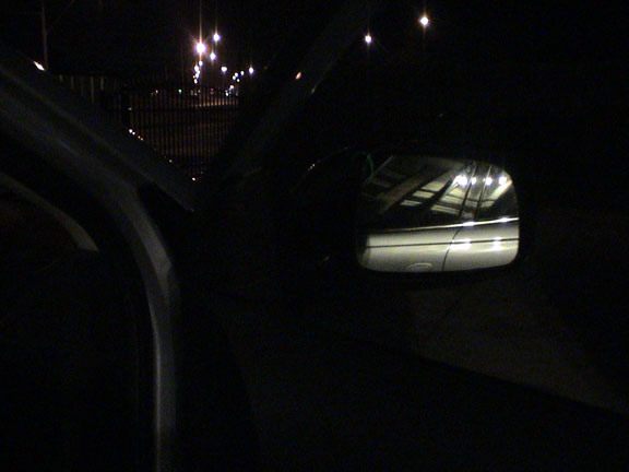

the stock tweeters in the sportivo and levin are situated in the bottom left hand corner of the left window and botton right hand corner of the right window, closest to the side mirrors of the car.
what they'd usually do is put the tweeters in the air vent holes on each side of your dash if you dont have the stock tweeter positions.
if you speak to kcorro, he is selling these covers that go into the corner of the window. although what u do need are the brackets to hold up the tweeter as well. maybe toyota sell the tweeter cover kit or something :unsure:
anyway, this pic is quite dark but it should let you know where they are situated.
