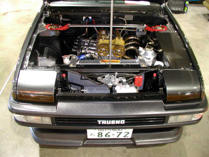

Didn't know quad throttle bodies were stock on 20v but sure didn't sound like it during the dyno run.. But these 4AGE 20v are bloody grunty N/A motors for their age. Are the Formula Atlantic Spec 4AGE a 20v motor and anybody knows if they were sold on any mass produced Toyota cars?
formula atlantic motors are a true race spec motor which require rebuilding at short intervals.
Their powerband is also not suitable for a street driven car.
Quads are stock on all 20V 4age's.
You wont get much change out of $30K US for a hasselgren atlantic 4age. They use the bigport 16V head as their base.
Don't they use those motors in Open Wheelers? kind of like our Formula Ford series?
It's called Formula Atlantic and is the main feeder series into CHAMPcar, They also have the Infinity Pro Series as a feeder into IRL, which use Nissan engines (badget 'Infinity' for the US market, which is the name the luxury Nissans are marketed under over there).
Both of them are actually more like a Formula 3 then a Formula Ford.
Hasselgren Atlantic motor in an AE86:
