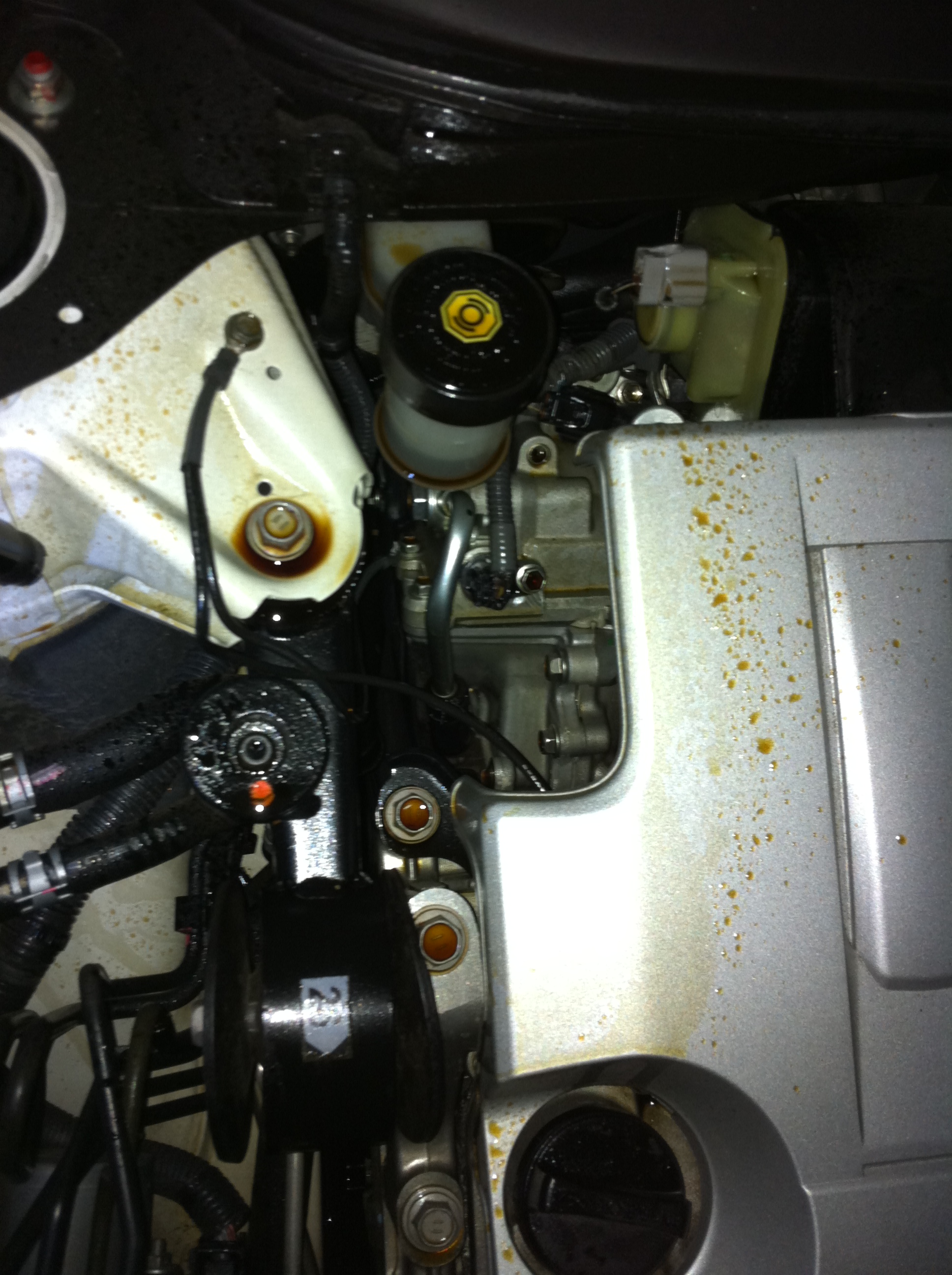

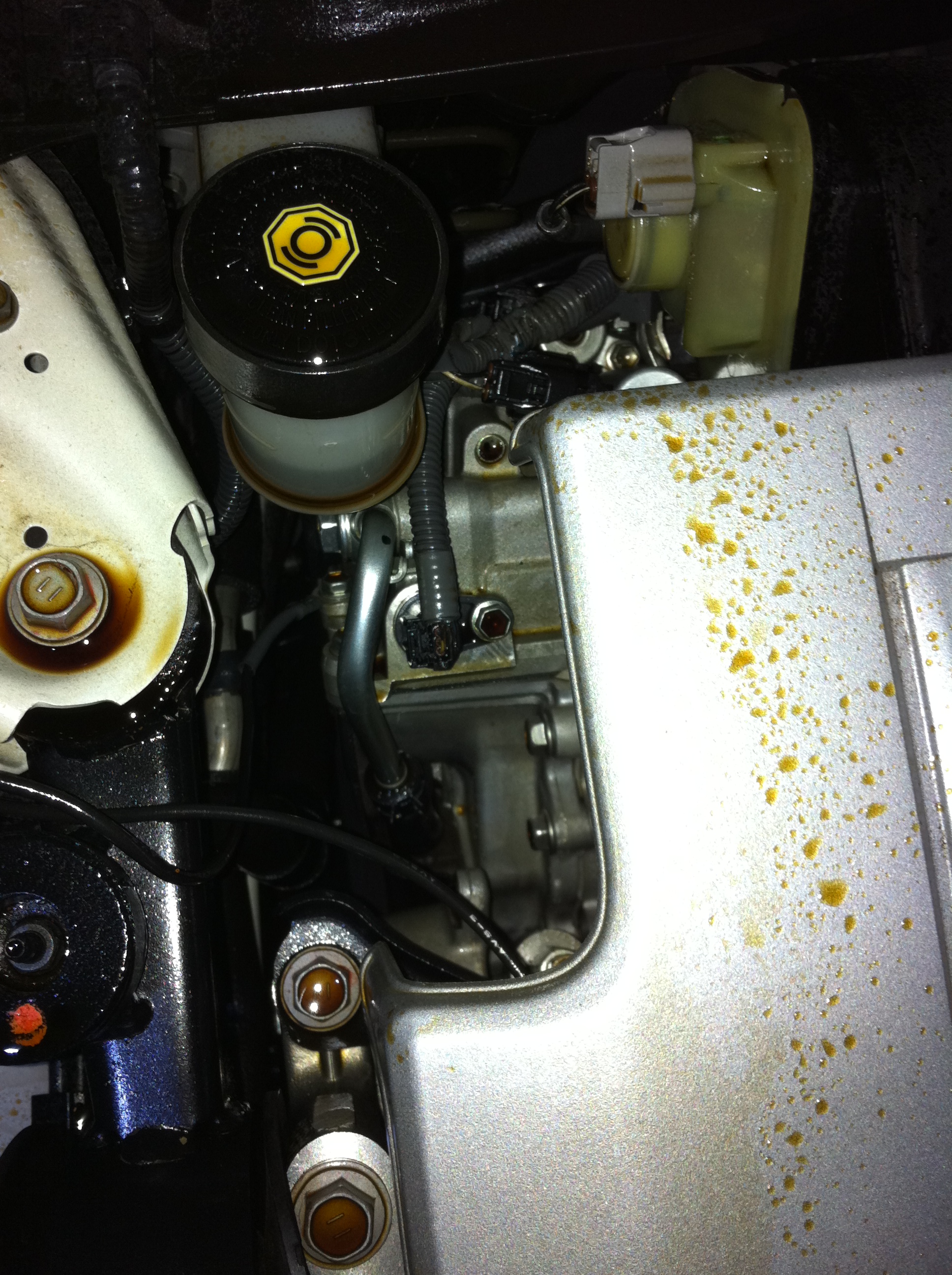

Just about 1 hr ago i was driving back home, when all of a sudden an error came on my dashboard. It said oil pressure low. Then it started to change to "check VSC". All other things on dash like oil temp etc was fine. I was about 1km from home so i drove slowly noticing a slight burning smell coming from my bonnet. I got home safetly, popped the bonnet to have a look.
To my utter suprise, there was a major oil leak of somekind under the bonnet. It sprayed oil everywhere. nearly everything on the left side of engine was covered in oil. Now i'm no mechanic or technical person but i have read somewhere in this forum that this was a known problem to do with some kind of hose or pin or rubber thingo that could cause such a catastrophic oil leakage.

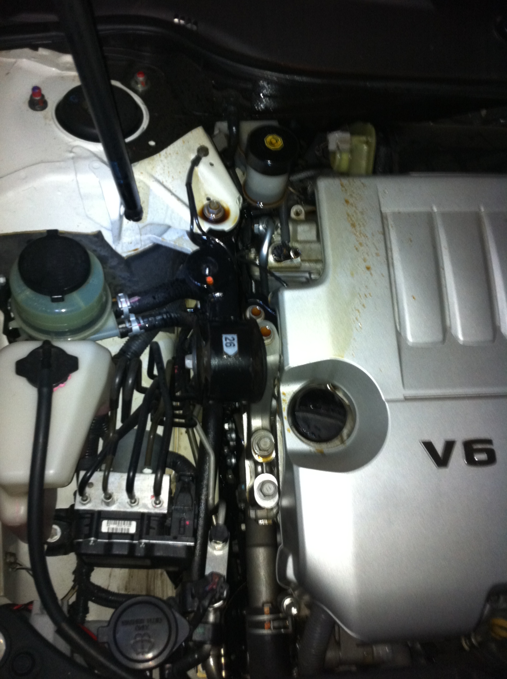

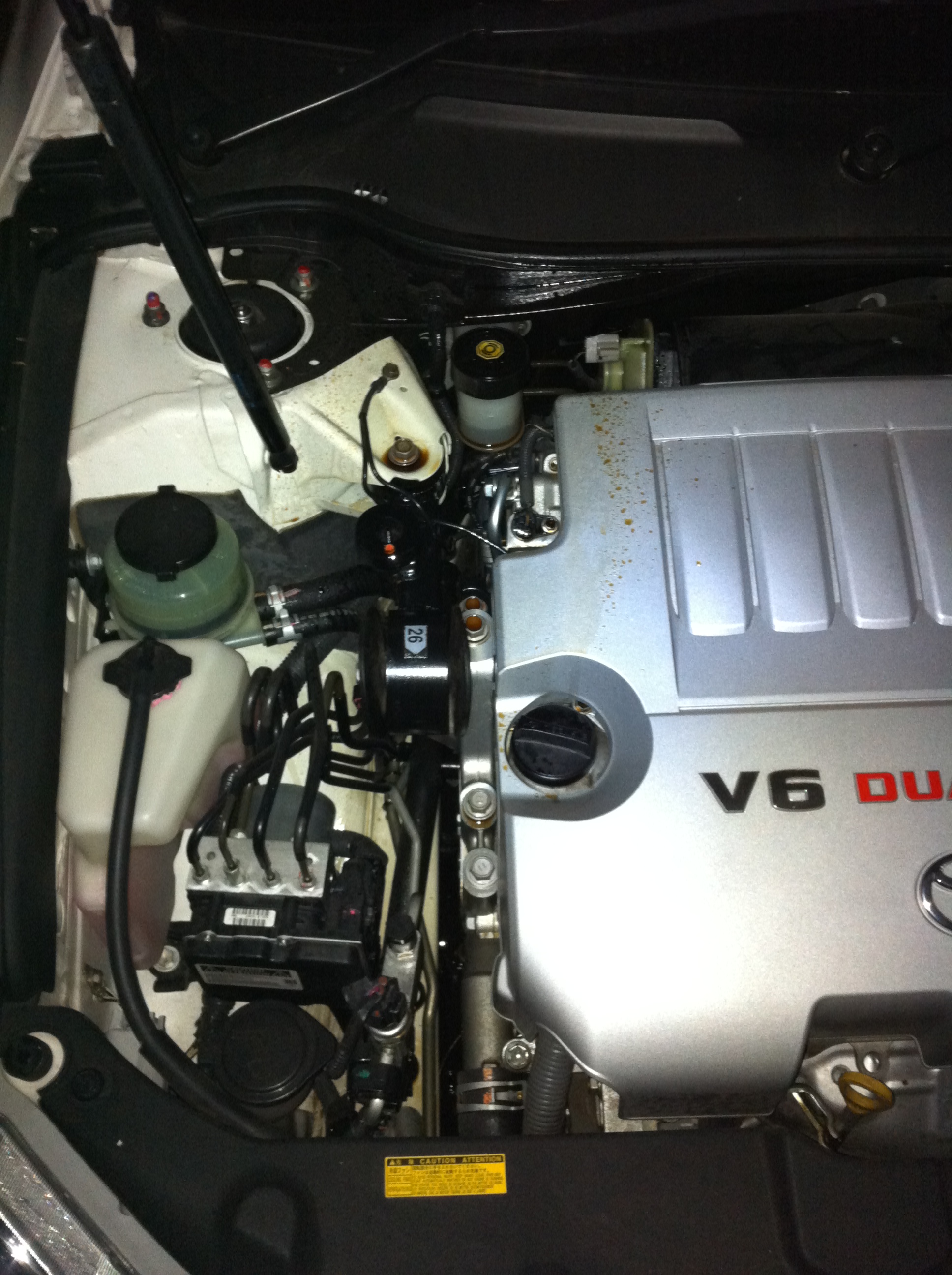

Thanks mate, i will let you all know how it goes tomorrow. And please everyone if you have the rubber hose, get it done before its too late. A small price to pay to prevent this from happening. And here are the pics.
Top views
post-22548-0-38795000-1306515989_thumb.j
post-22548-0-21196800-1306516026_thumb.j
Up close, i can make out the rubber hose thingo amongst there somewhere
post-22548-0-70450300-1306516069_thumb.j
post-22548-0-63742800-1306516102_thumb.j
