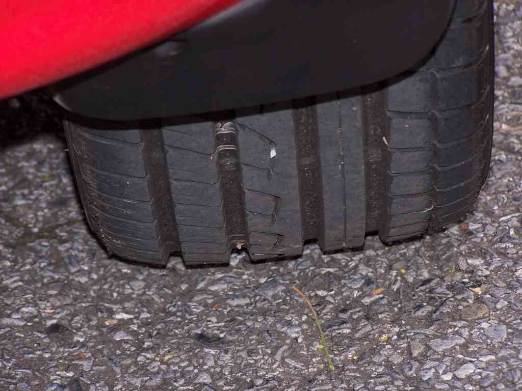

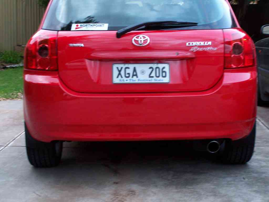

Good news is it fits in the spare tire well, but bad news. The back tires don't sit flat on the ground. The tops seem to be angled inward. Took it back to the dealer for 1000 km service and they said to take it to a tire shop to get fixed. Can this be adj on a sportivo?

pics would be helpful. from wat i can imagine from your descriptions, it sounds like a bit of camber

I'm pretty sure the rears on my (pre-facelift) model have some negative camber (maybe 3/4 or 1 degree) as standard. Not sure if this is adjustable.
If the place did your alignments when they fitted the new wheels and tyres, you should have a printout with the camber and other specs - check what it says on there, or if you don't have one, take it back to the tyre shop like the dealer said...
I think his talking about camber on rear wheels. Because my goes slightly on bit of an angle but i like it like that :D .

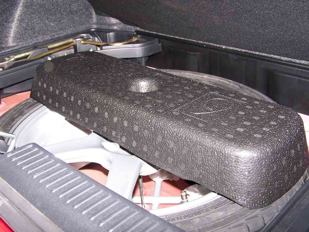

here's a pic of the black foam block that goes over the spare wheel. I have a full size 17x7 and because it a inch taller (or wider depending on the way you look at it) than the 16 x6 you get standard, the block doen't fit under the cover. See Second pic with cover down poking up. How much should you cut off the foam block.
I would gues an inch...
It's only purpose is to keep the carpeted bit from collapsing into the wheel well when you put a heavy load in the boot.
PS. take off the Northpoint sticker

I think that it looks like if you remove the foam altogether, it should still be able to close flat and stay up.
