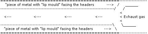

Quite an amusing idea there negatron, theoretically it should work.
However i wouldnt just be "shoving" it into your exhaust, try and weld it on the side inside the flange, because that piece of metal will be under quite high pressure if it is to be functioning as you intend it to and you dont want it moving around in there.
Also, how long would this piece of metal be? I am assuming you are talking about a metal cylinder that you are going to drill out. I would think that it would need to be at least around 5cm, probably more to work. Also if you give it more of a lip design to reduce the pressure at that particular point in the exhaust may help - kind of hard to explain, check out my ASCII pic hehe.
I am no exhaust guru but from the pros i have spoken to and logical knowledge i think this could have interesting results. If the losses are that bad, doing this wont hurt, so long as you still have your stock exhaust to fall back on.
Cheers
PS. ok the ASCII didnt work out - stupid forum...so here is a pic of the ASCII as it should be.

Nah, i was actually thinking of making i with bolt hole that the existing ones will gh through, it won't be a pipe but literally a piece of metal with a hole in it. but then again the rusty logic in my head thinks that the turbulance this "hole in the wall" might be bad.
I like the idea of your idea mintos, but this is sounding both expensive and it WILL make a clanging noise as the free part of the pipe vibrates and knocks against the zorst wall.
