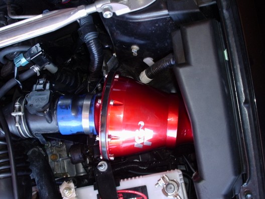

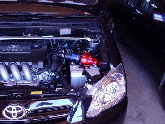

I got the adaptor from a spare airbox that i had lying around. I dont know if it's better than a CAI, debatable question, it's definetly not as loud, the exposed pod on a CAI makes alot of noise. The drivability is much improved on the car, but most of all the throttle response when youre cruising in 6th at 100kph is much more noticeable than before.
I got home today after 45 minutes of driving, jumped out of the car and popped up the bonet. I went to touch the K&N apollo and to my surprise it wasnt even luke warm it was cold. The rubber hosing going back into the throttle body was warm, but there is definetly cold air flowing through there and it pulls harder than ever. Its the perfect match with the CES exhaust. My advice to anyone out there considering a CAI, give this thing a go, saves you a bit of cash, take it from me ive tried alot of different inductions and this is my pick of the lot.

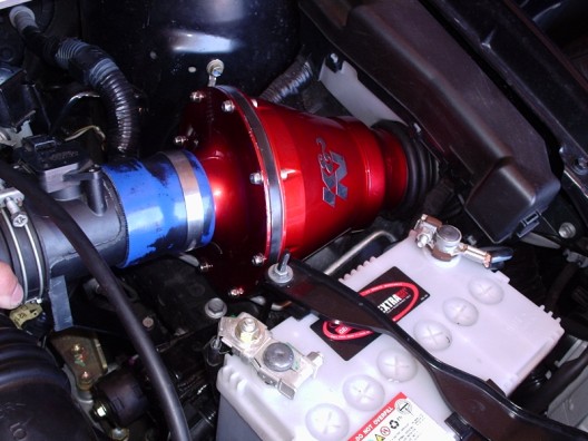

I assume it is installable for the 1zz. The unit doesent have a bracket, i made one, got it from Autobarn.

The pod doesent heat up as you can attach a hose from the pod to the front of the car.
